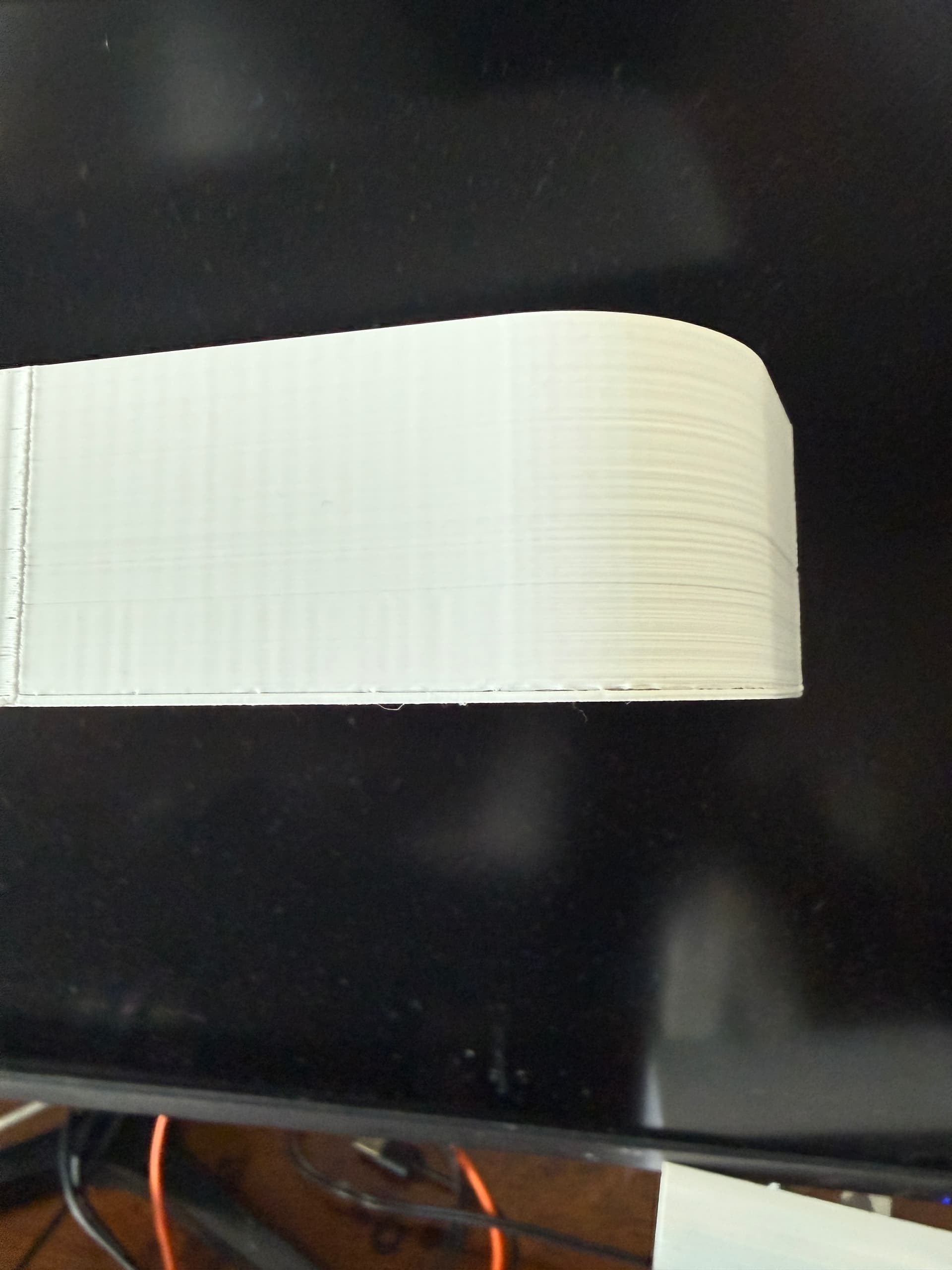

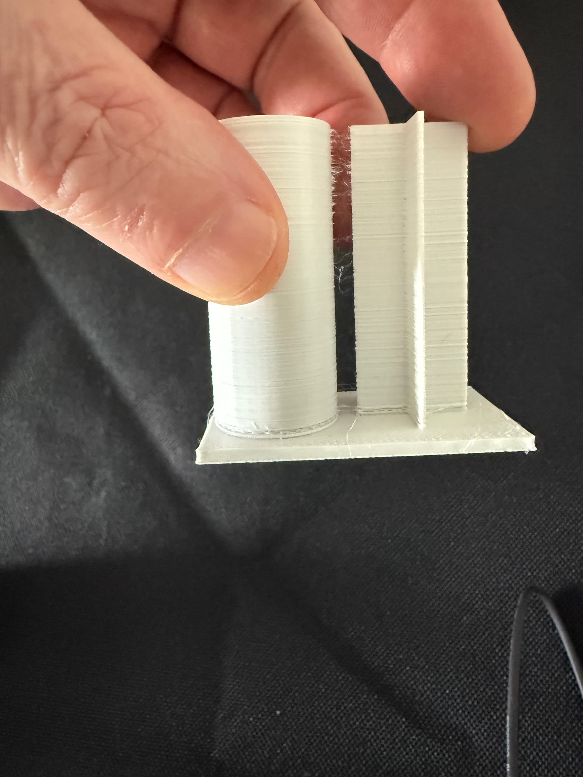

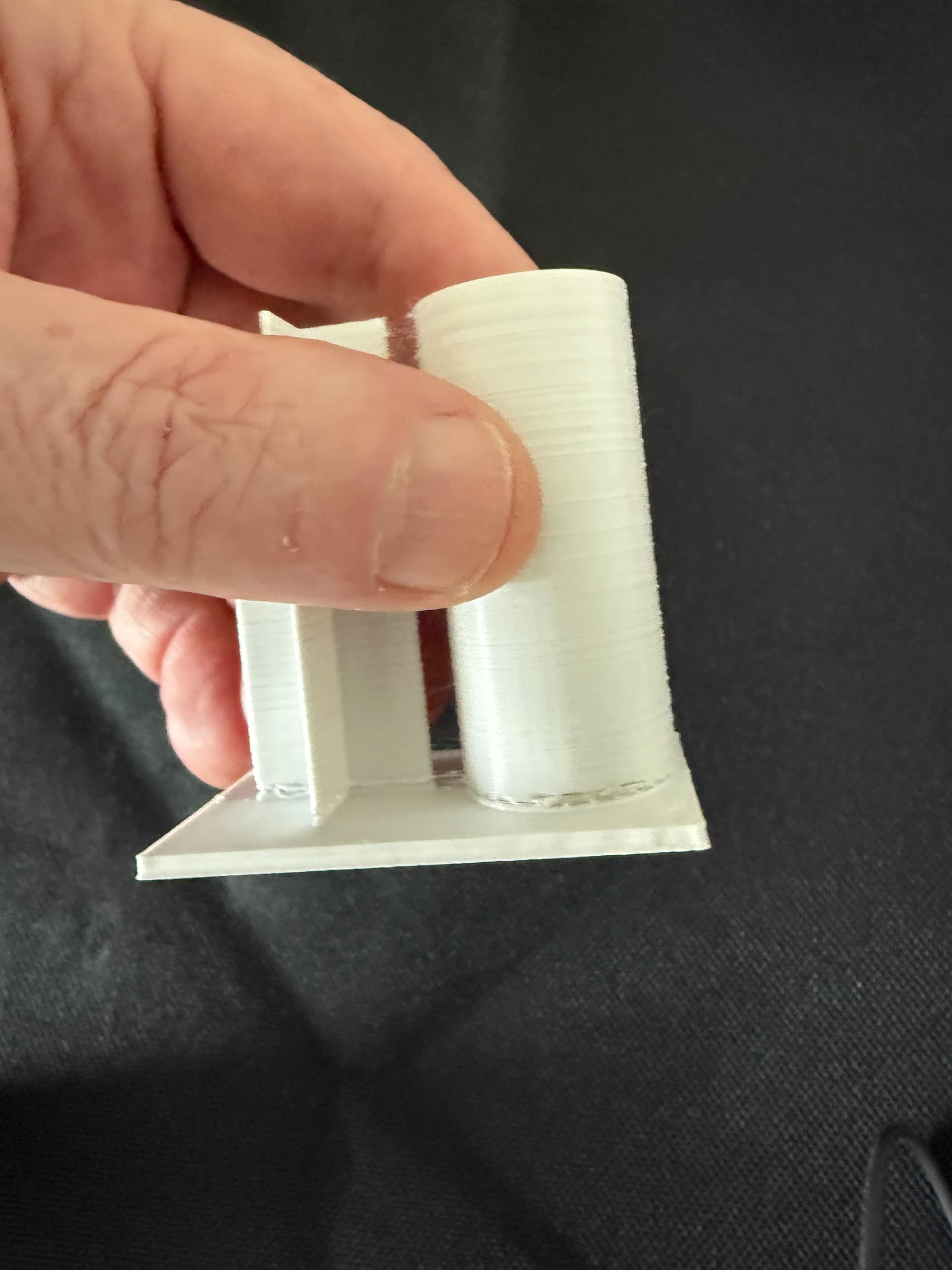

I ham having consistent problems with first level of walls
The first layers stick fine but the first wall layer above is consistently under extruded. This is on my Ender3 V3 SE. I have tried temp, flow and speed settings and the slicer does not seem to matter. Every layer above it is fine. I am open to suggestions.

No estep change needed. It did 100mm. My z axis is correct. I tested with sheets until it was good and the bottom of my prints are fine.
I don’t know what the z offset would do if the base is fine and the rest is fine. It is only on the first part of the wall. I also printed a couple of prints with no wall and no issues

Looking at the pictures the loss of adhesion seems to be at the same height.
Manually check both Z screws, is there any movement up or down? if so adjust.
Check the Z screw guides on the X rail, the screws should be slightly loose allow for any Z wobble. there does seem to be a degree of Z banding visible.
You also seem to be getting some stringing, check your temps and your retraction distance.

I was looking around. I found a little bit of play in the bed. I loosened and retightened the bed rail screws. The same print came out smoother and the first wall layer was fine. Will test some more.
The problem is not first layer adhesion. First layers is fine. It is when it transitions from bottom layer to the wall that i have the problem. That is working after tightening the bed rail screws to eliminate play.
You must have no play at all, at no point. The slightest slack will lead to failure.
