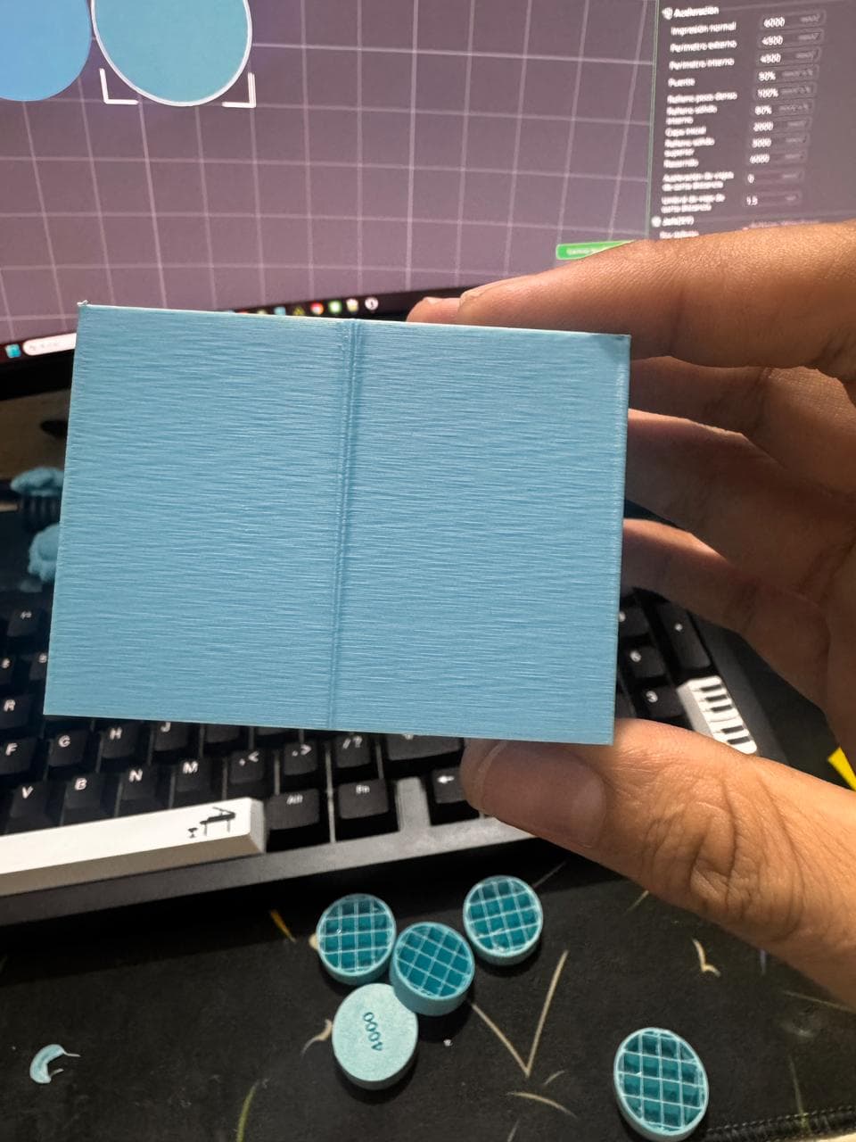

I’m going crazy with this problem
I have tried everything to solve this problem. I’ve tried increasing and decreasing speed, increasing and decreasing acceleration. Someone advised me to increase the number of walls, increase infill, and even change the geometry. I’ve tried everything, but nothing works.
Additionally, I have done flow tests, pressure advance tests, and every calibration test I could think of. I calibrated the filament in every possible way, and none of it solved the issue either.
What could be causing these wrinkled walls? I don’t know how to fix this anymore.

On the bottom(?) of the print you present in the picture, the surface is rather smooth, could be also some Z axis wobble, however, this should not occur with lower speed.
That being said, does the model in the slicer has smooth walls?

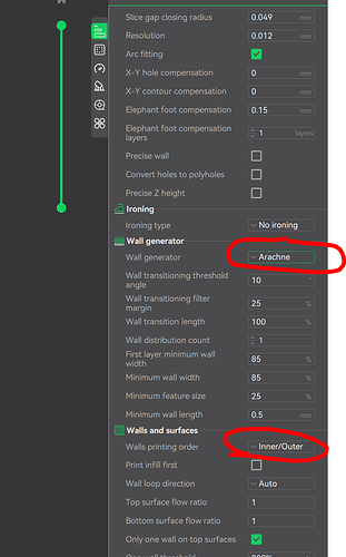

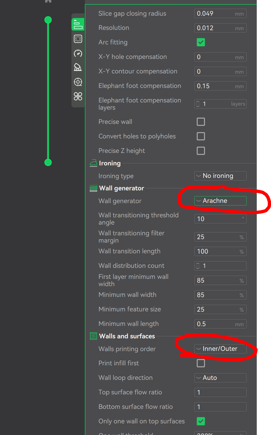

i would run some tests while changing the wall generator setting, and also wall printing order may be useful.

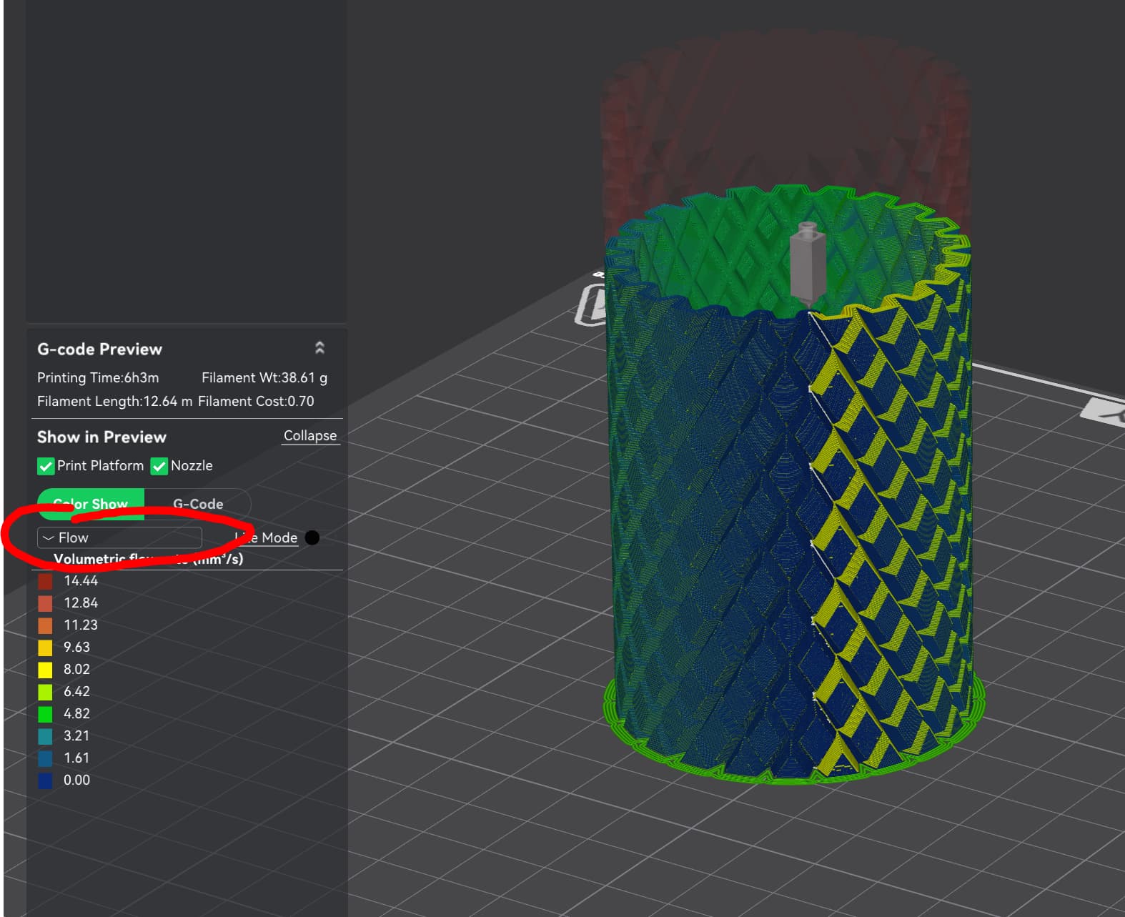

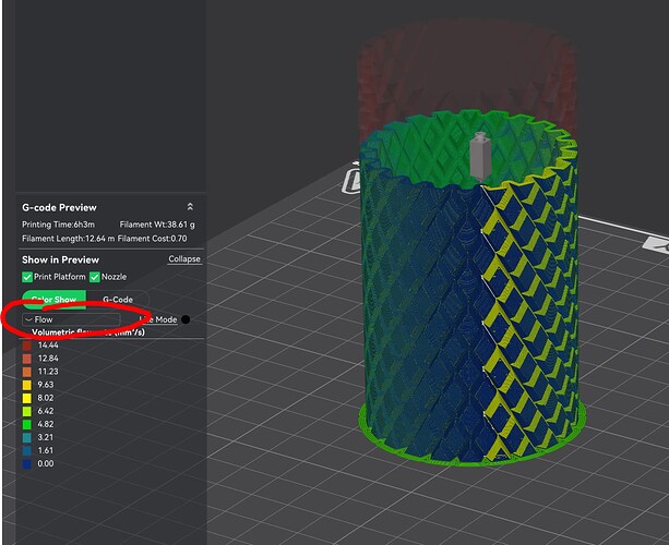

Might wanna check also this here:
switching to flow preview, layer height /width to see if the slicer shows it on the model. Maybe some settings are not quite right and the printer is actually executing it accordingly to the settings?
