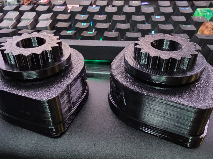

I made an Ender-5 Max adapter for VOXELPLA HULA feet—looking for fit feedback
A small fit-feedback table could make reports on the star-fit mount much easier to compare: file revision, material, slicer scale, the mating feature measured on the original foot, the matching printed dimension, and whether the adapter seats fully or rocks. For the star profile, mark the exact pair of flats or points used for the measurement; the overall X/Y size alone will not describe that interface.
It may also help to offer a short test piece containing only the mating profile before users print a complete set of adapters. Record the intended clearance in the model separately from any slicer dimensional compensation, so feedback can distinguish a geometry change from a printing adjustment.
