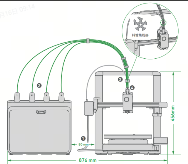

Install the CFS lite
Place the CFS lite on the left side of the i7, and correctly connect the PTFE tube and the 6-pin cable of the CFS lite. For detailed installation instructions, please refer to How to connect i7 and CFS Lite?

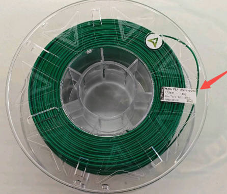

Filament Preparation
Prepare the filament in advance. You can obtain filament information from the spool label.

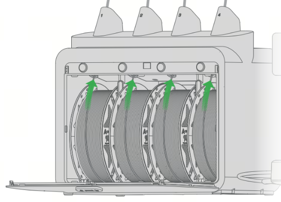

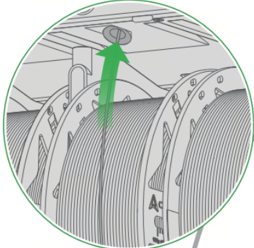

Load Filament

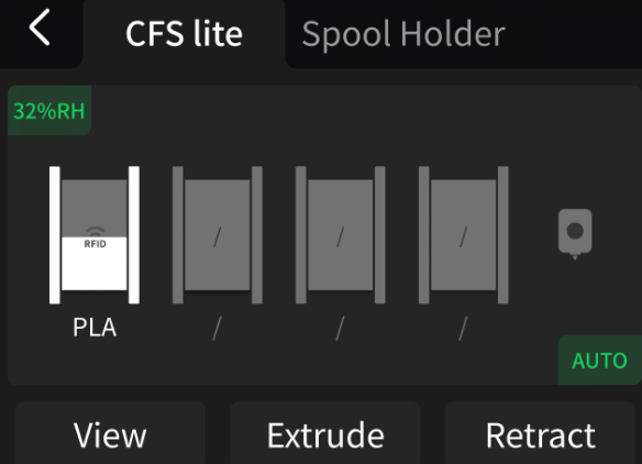

Place the required filament into the CFS lite spool slot and insert it into the Filament Inlet to automatically start pre-feeding.

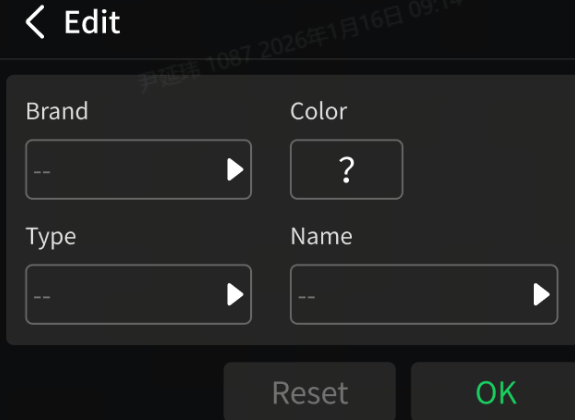

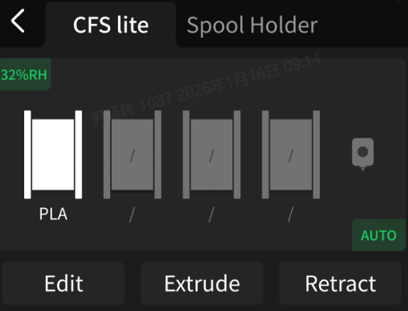

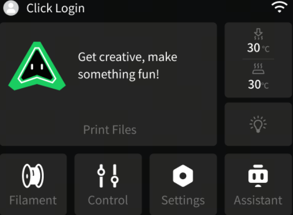

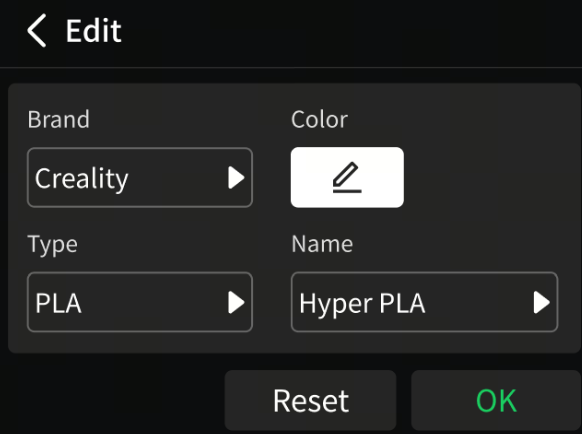

Edit Filament
Tap Filament on the main screen to enter the filament editing interface.If using non-RFID filament, you need to manually set the filament parameters:
a. Select the filament displayed as “?”, then tap Edit.
b. Tap to set the filament Brand-Color-Type-Name.
c. After setting the filament information, tap OK.
d. The interface will display the selected color, indicating that the filament parameters have been set.

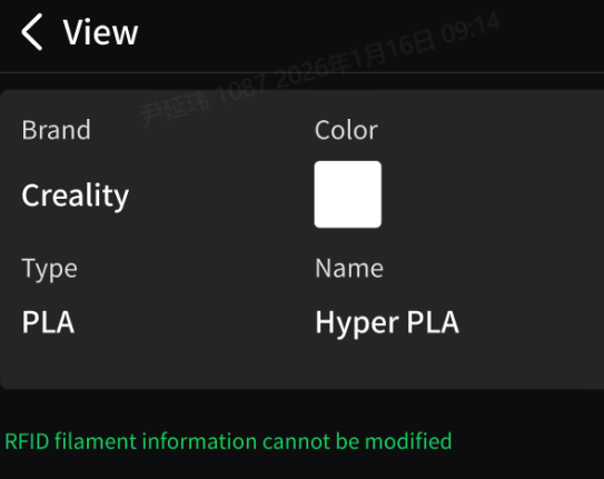

If using RFID filament, CFS lite can automatically recognize the filament information:
a. Tap the “View” button to check the filament information.
b. RFID filament information cannot be modified.

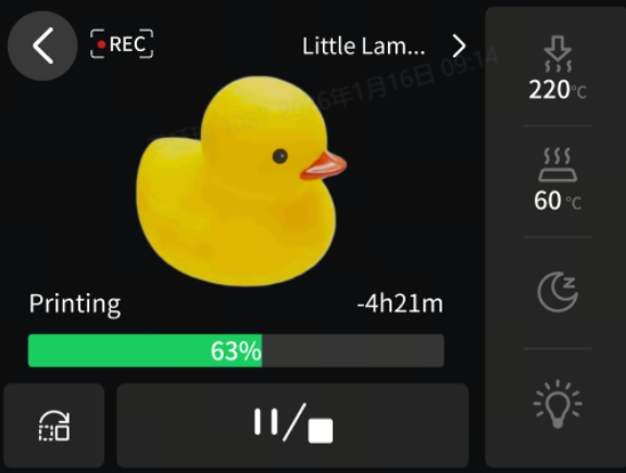

Start Printing

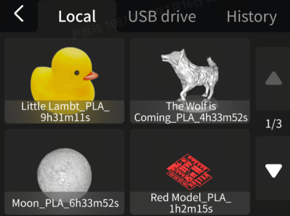

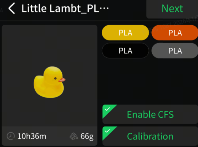

Start printing using the printer model file:
Tap Print File and select the model you want to print
It is recommended to enable “Enable CFS” and “Calibration”, then tap Next.

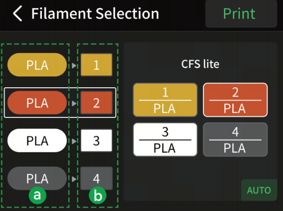

Select the corresponding filament mapping (“a” indicates the filament set in the print file; “b” indicates the filament actually used). Tap Print, wait for the print to complete, and remove the model after the Print Plate has cooled.

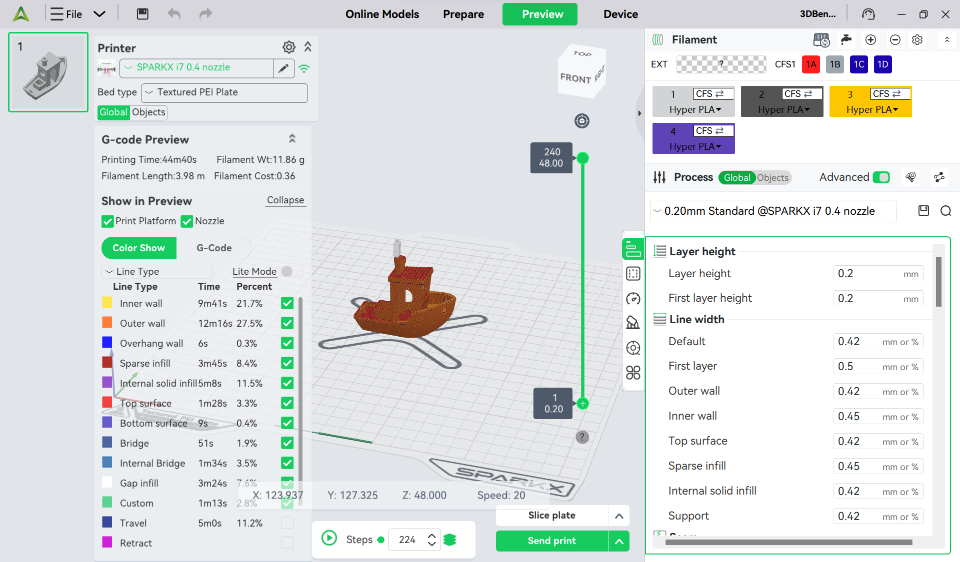

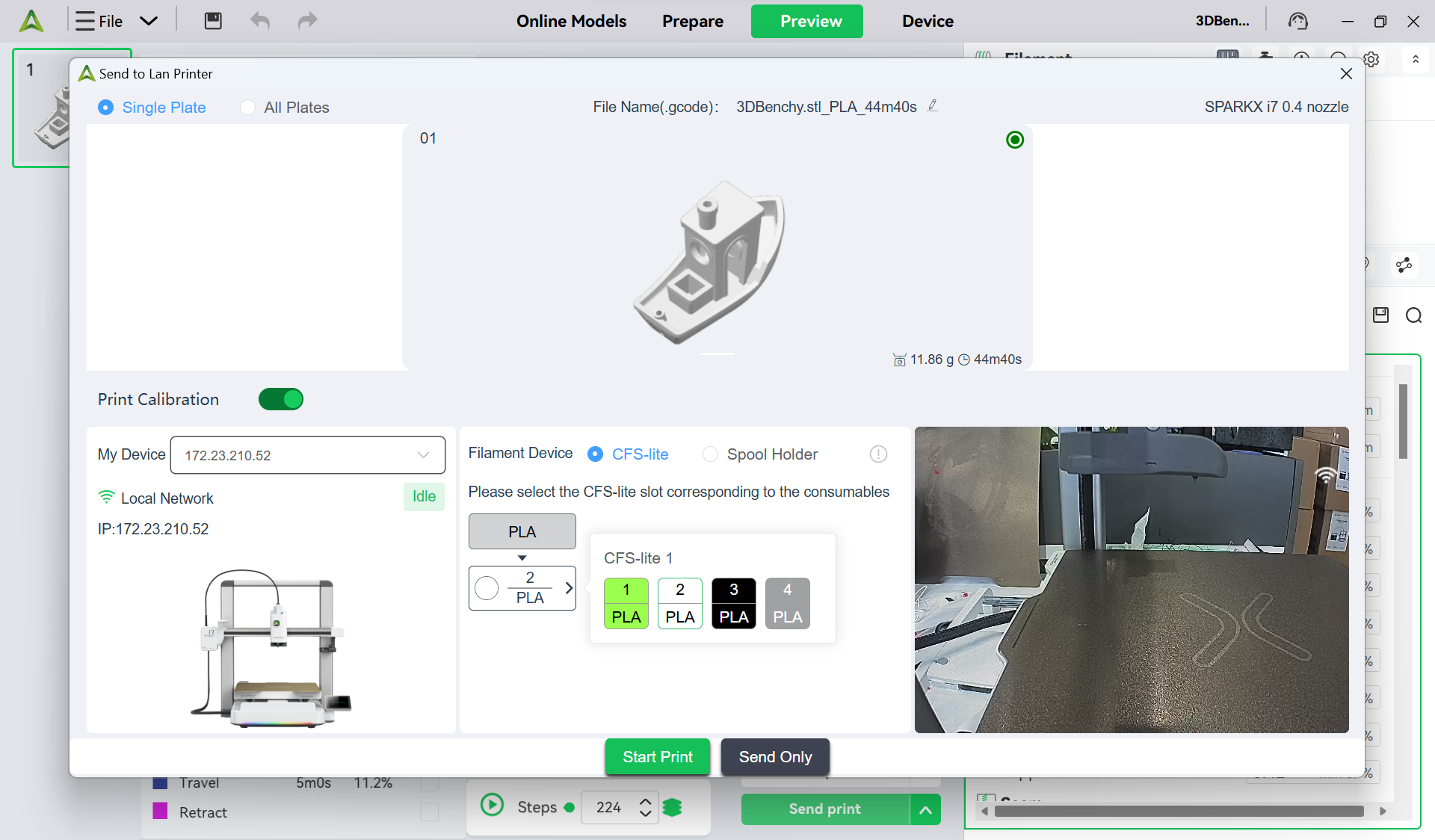

Printing with Creality Print
For detailed instructions, please refer to: How to Start Printing with Creality Print?

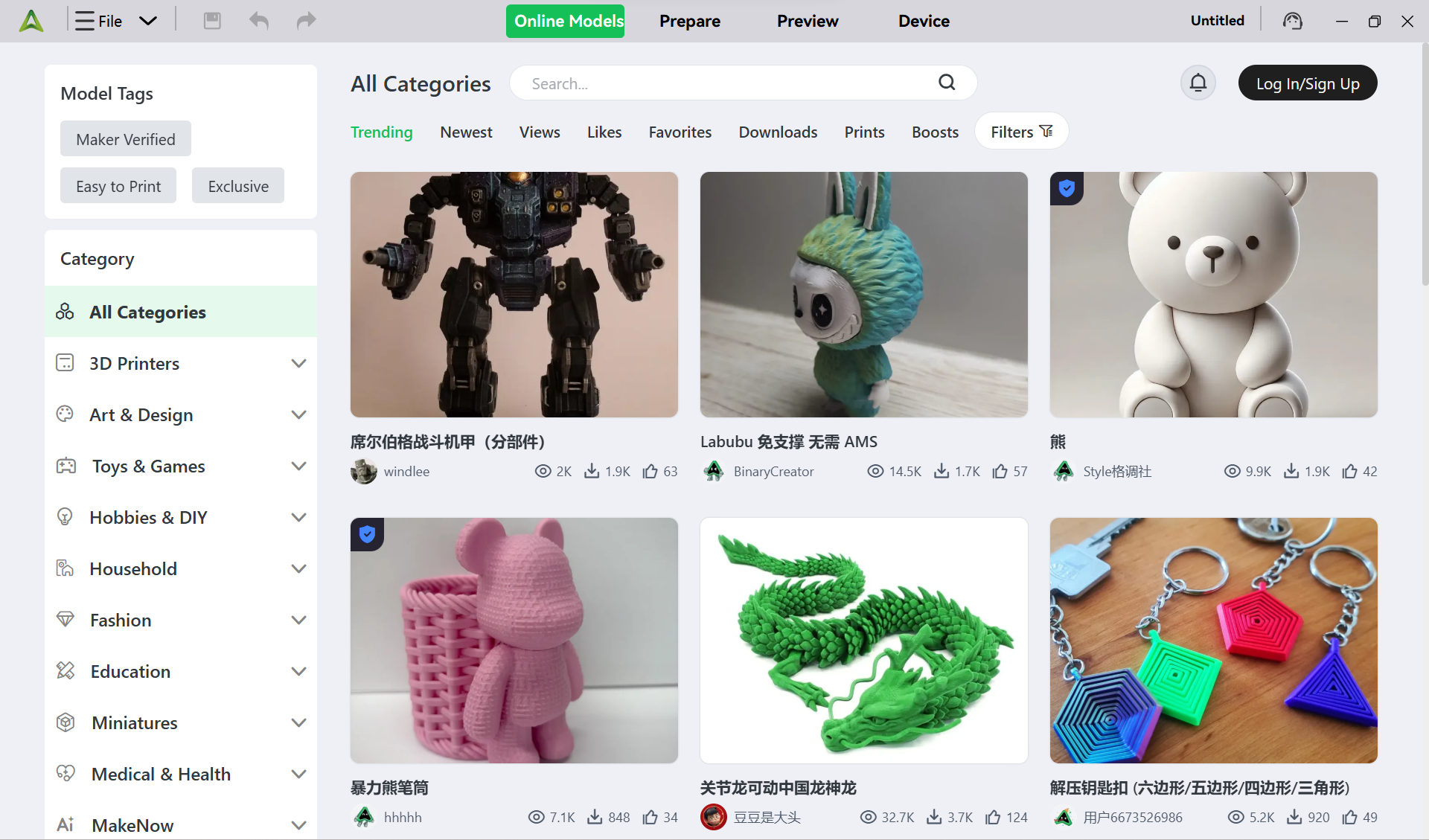

Download Creality Print
Select or import the model you want to print. In the top-left corner, choose the printer model you will use. Tap Slice Plate in the bottom-right corner, and after slicing is complete, tap Send Print.

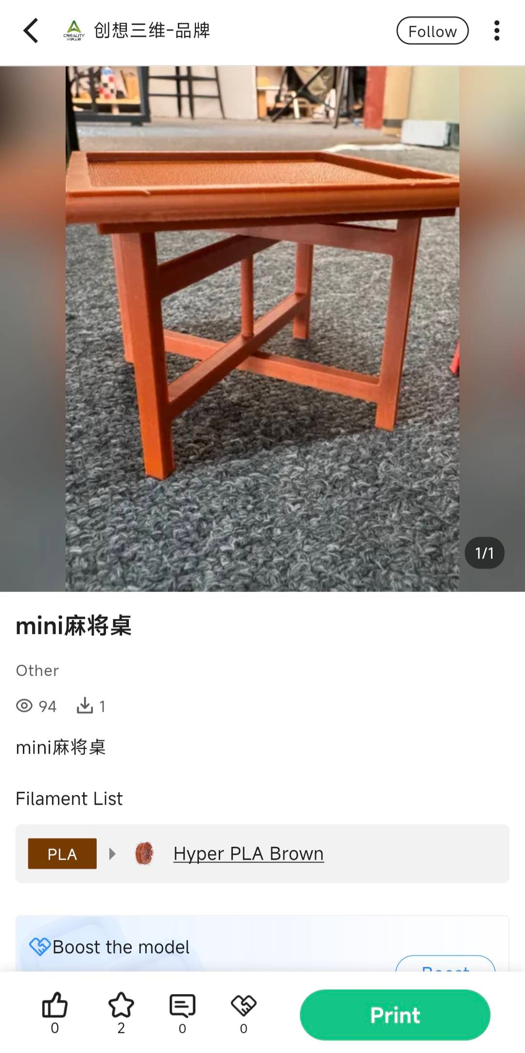

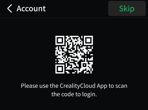

Printing with Creality Cloud App
For detailed instructions, please refer to: How to Start Printing with Creality Cloud App?
Scan the QR code to download the Creality Cloud App, and then scan the login QR code on the printer to complete the binding.
Google Play
Apple Store

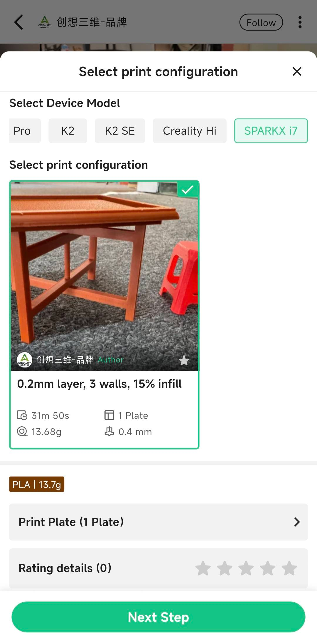

Select the model you want to print, tap Print, choose your printer model configuration, and then tap Start Print.
