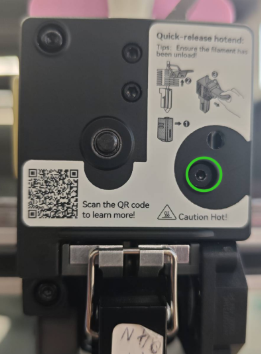

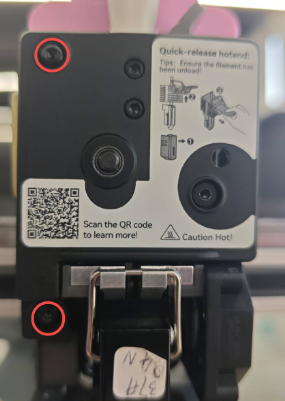

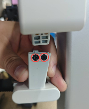

M3×6(A)
Secures the Front Cover of the Extruder
Secures the Purge Wiper Assembly

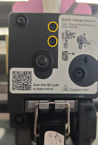

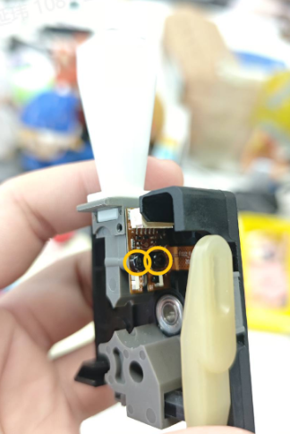

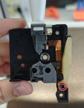

M2×6
Secures the Toolhead Manifold Assembly
Secures the Filament Sensor Board

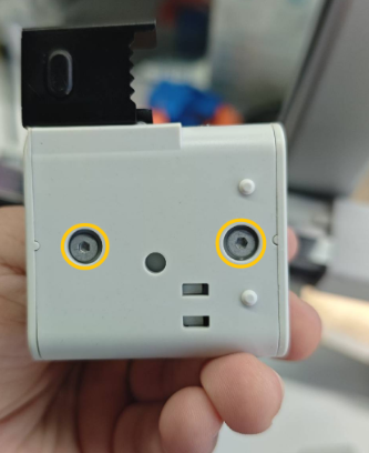

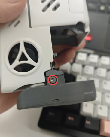

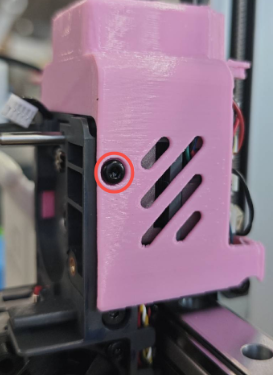

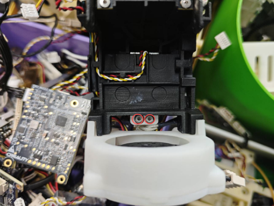

ST3×6
Secures the Rear Cover of the Extruder.
Secures the Base Cover of the Purge Wiper Assembly.
Secures the Part Cooling Fan
