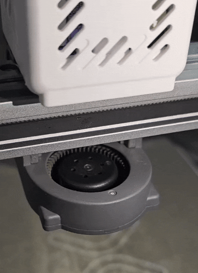

Part Cooling Fan During printing, this fan cools the printed model, allowing the molten filament to solidify properly and ensuring successful model formation.

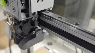

Hotend Cooling Fan This fan cools the hotend heat sink, improving heat dissipation efficiency and preventing heat creep, which can lead to nozzle clogging.

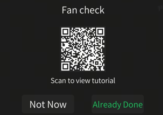

Maintenance Interval
When a “Check Fan” prompt appears on the printer or in the Creality Cloud App, it is recommended to perform a fan inspection and maintenance.

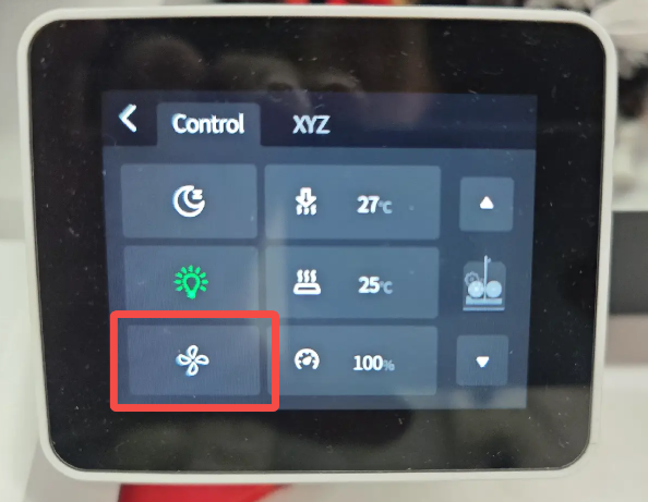

Part Cooling Fan Inspection and Maintenance

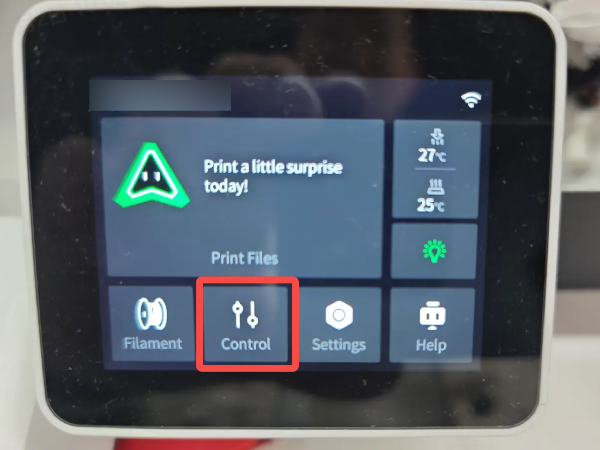

On the printer touchscreen, go to the Device Control page and select Part Cooling Fan.
Increase the fan speed and observe whether the Part Cooling Fan is rotating properly.
If the fan operates normally but dust buildup is present, clean it using a soft brush or air blower.
Hotend Cooling Fan Inspection and Maintenance

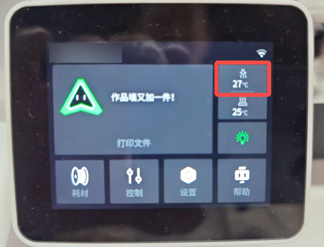

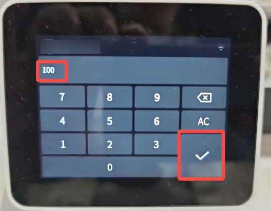

On the printer touchscreen, go to the Device Control page and set the Hotend temperature to 100 °C.
Warning: Do not touch the nozzle during this process to avoid burns.
Observe whether the Hotend Cooling Fan is rotating properly.
