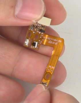

New filament break detection module

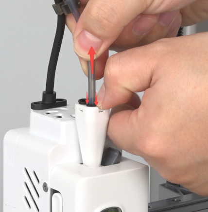

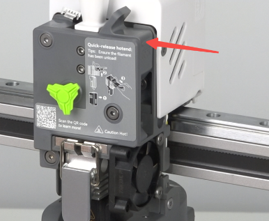

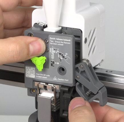

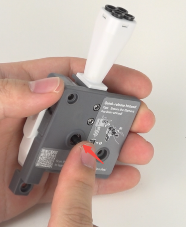

Press the tube connector and pull out the PTFE tube

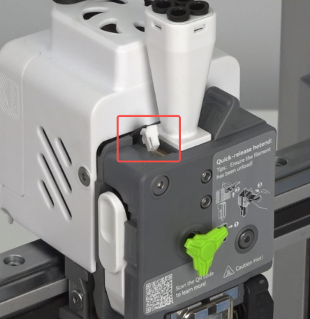

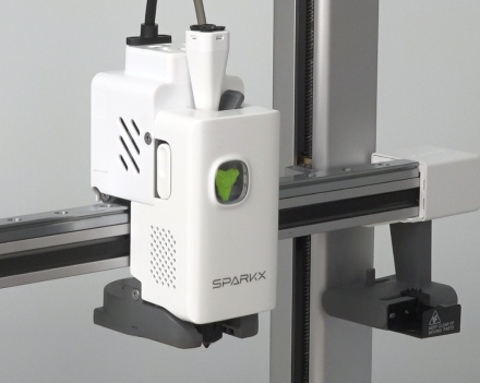

Remove the tool head front cover

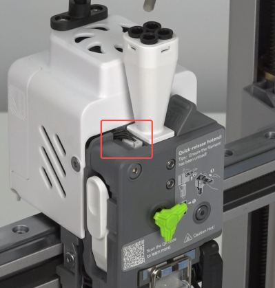

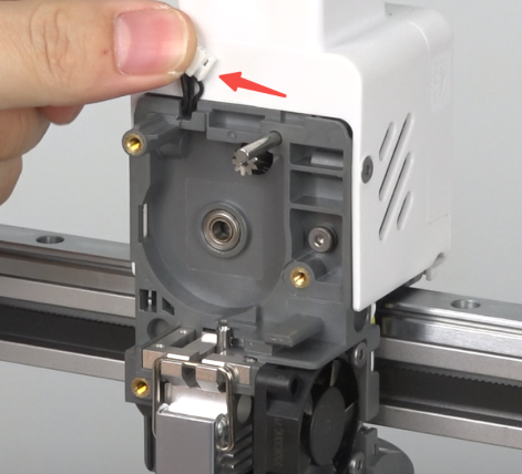

Unplug the filament & cutter sensor wire.

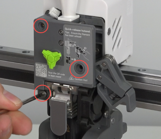

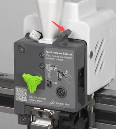

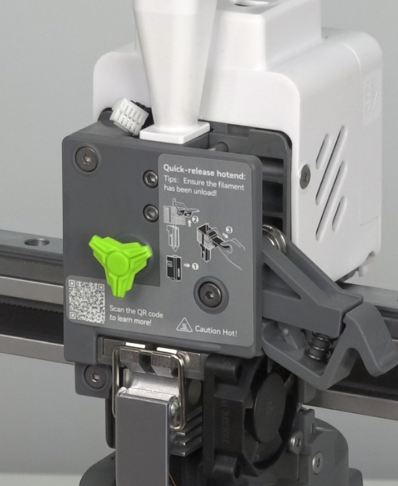

Open the extruder handle.

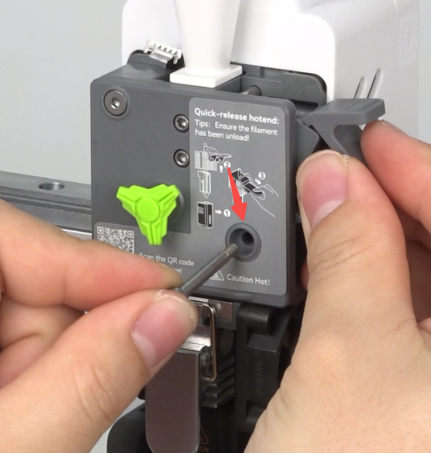

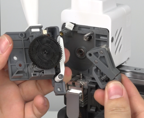

Use the hexagonal wrench to unscrew the 3 screws securing the extruder front cover

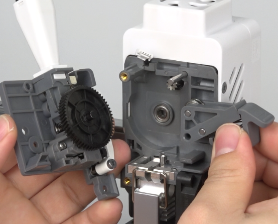

Remove the extruder front cover and extruder handle.

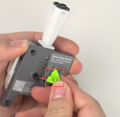

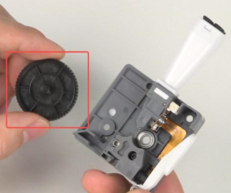

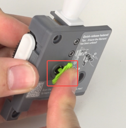

Pull out the small dial.

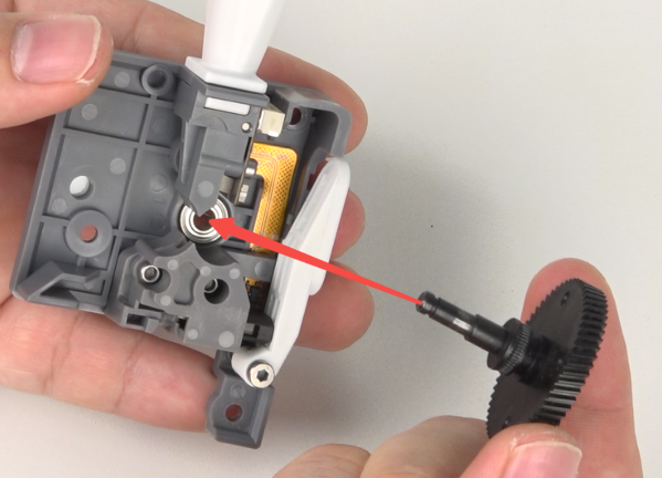

Press the gear shaft with your index finger and pull out the large gear.

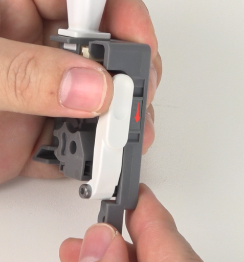

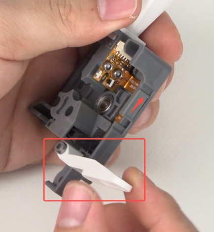

Push the slider upward to unlock the cutter push rod.

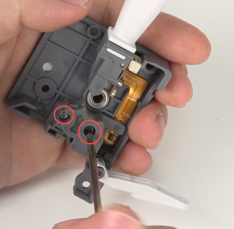

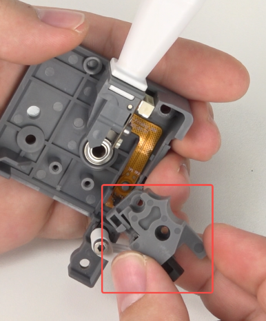

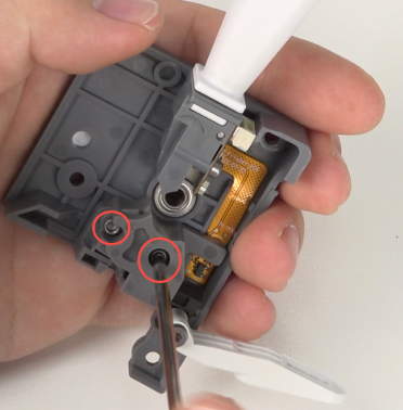

Use the hexagonal wrench to unscrew the 2 screws securing the lower feeder block, and remove the lower feeder block.

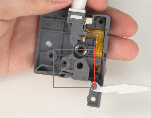

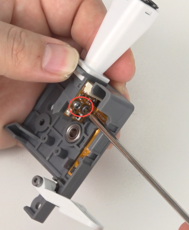

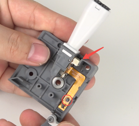

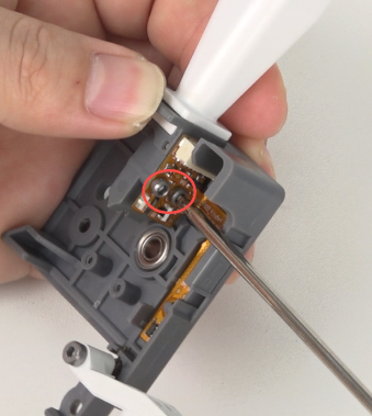

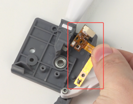

Use the hexagonal wrench to unscrew the 2 screws securing the filament break detection module, and remove the filament & cutter sensor.
Installation

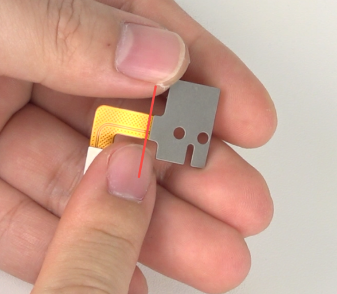

Bend the new filament & cutter sensor’s metal sheet 90 degrees
Place the filament & cutter sensor into the extruder front part, paying attention to align the positioning posts
Use the hexagonal wrench to tighten the 2 screws securing the filament break detection module.

Close the cutter push rod, push the slider downward.
Insert the large gear with the gear shaft passing through the bearing, install the small dial.

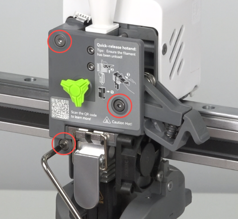

Install the extruder front cover and extruder handle
Use the hexagonal wrench to tighten the 3 screws securing the extruder front cover, holding the extruder handle up to align with the holes.
Close the extruder handle.
Insert the filament & cutter sensor wires

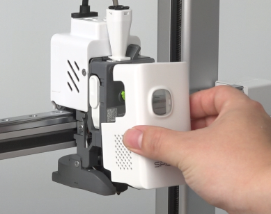

Install the front cover
