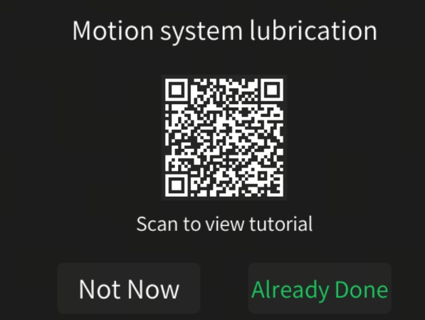

Lubrication Interval
The lubrication interval for the i7 motion system depends on usage frequency. Under normal conditions, it is recommended to lubricate the motion system when the printer displays a “Motion System Lubricate” prompt, or when a lubrication reminder pop-up appears in the Creality Cloud App.
