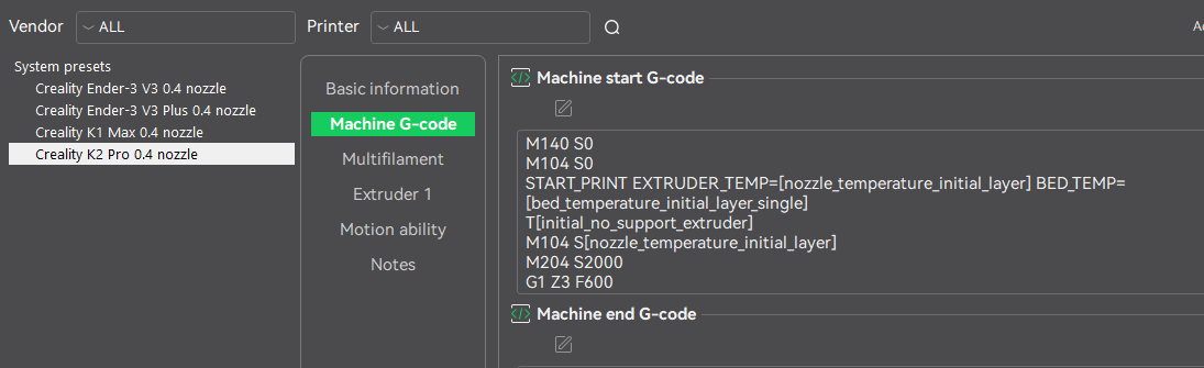

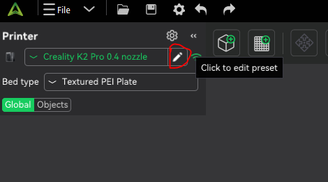

Can you advise on how to enter start/end g-code? I can’t seem to find any documentation on it.
Hello @campingpanda :wave:
This might be what you are asking for:
Pick the machine you want to edit:
