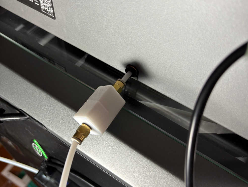

When the filament chokes the inside of the extruder and the CFS tries to retract the filament the whole filament pathway ends up under tension and breaking into it easily is not that easy. I have in the past pulled out the teflon tubing at the back of the CFS until it stretches and exposes some filament and then cut thru that. Yes I know I could remove the extruder and then cut the filament choke point away inside the extruder but I dislike working inside the chamber so was looking to make things easier so have made and inserted a simple filament cutter inline with the teflon tubing at the back of the CFS.

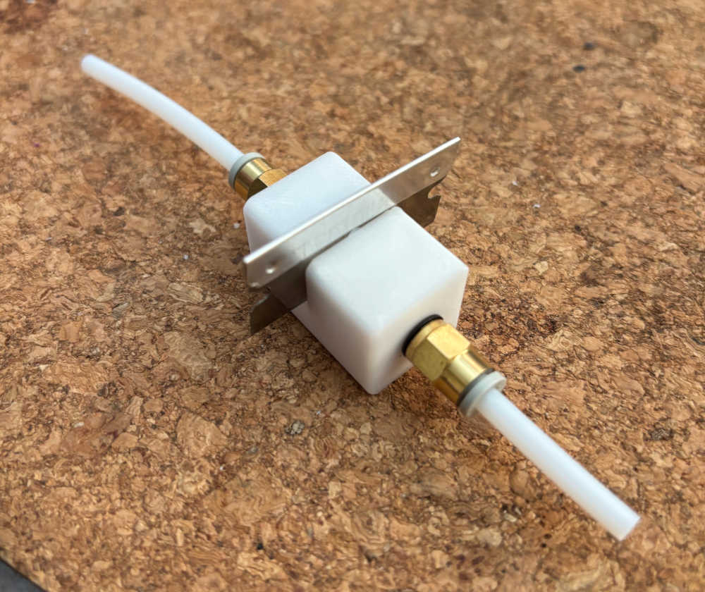

The cutter is a printed block of PETG with two teflon tube fittings screwed into a holes= running through the block and a slot (perpendicular to the hole) just wide enough to fit a razor blade to cut the filament which immediately releases the tension. The remaining filament in between the cut point and the CFS motor is short and thus easy to pull out.

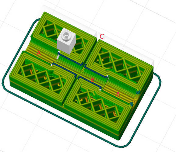

Cross section of cutter shown below. A are 5mm ID holes and threaded using an M6 tap to fit the M6 thread on the fittings. B is 4mm ID which holds a full length section of teflon tubing right up to the backs of each fitting. Then the tubing is cut with the razor blade.

RE . . . must have taken some time, Not really. OpenSCAD programming took about 10 minutes, I printed one prototype (21 mins) to check for filament catching inside the cutter. The first one was without any internal teflon tubing which led me to use the tubing in the second one. I then also printed a spare. So about an hour all up. BTW the brass fittings were from a Bowden upgrade kit so they fit really nicely.
