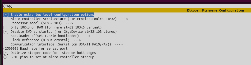

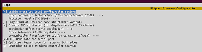

I’ve lost count on how many times I’ve tried to flash my Ender 3 Neo GD32F103 MCU. Creality, in their infinite wisdom, decided it was ok to leave out the GD32F103 from their guided setup on the sonic pad.
Troubleshooting done so far
Running ubuntu via UTM on my MacBook pro
downloaded klipper
run make menuconfig with different combinations of the below
with/without low level config
with/without disable swd
USB/USART1
Baud 112500/250000
generated firmware via make menuconfig and via sonic pad
Via mainsail
updated printer.cfg [mcu] with
/dev/serial/by-id/usb_serial_1
/dev/serial/by-id/usb-1a86_USB_Serial-if00-port0
different baud rates
different printer configs
factory reset sonic pad
refreshed mcu with original firmware - original display starts working fine and printer is fully functional
