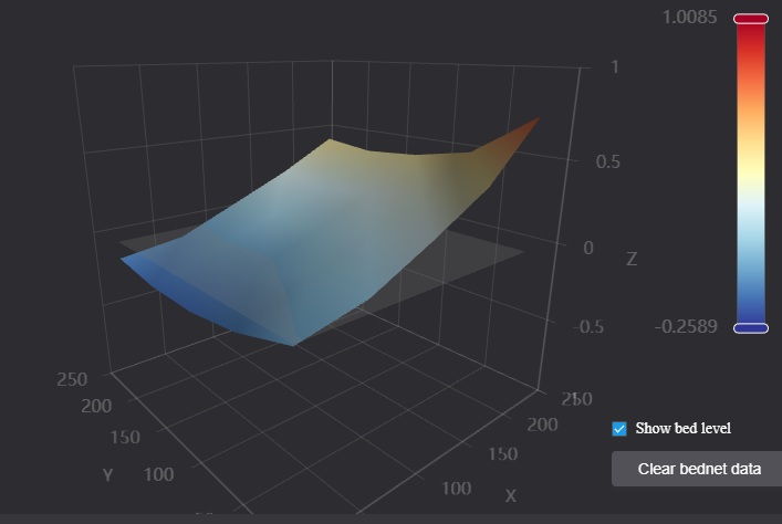

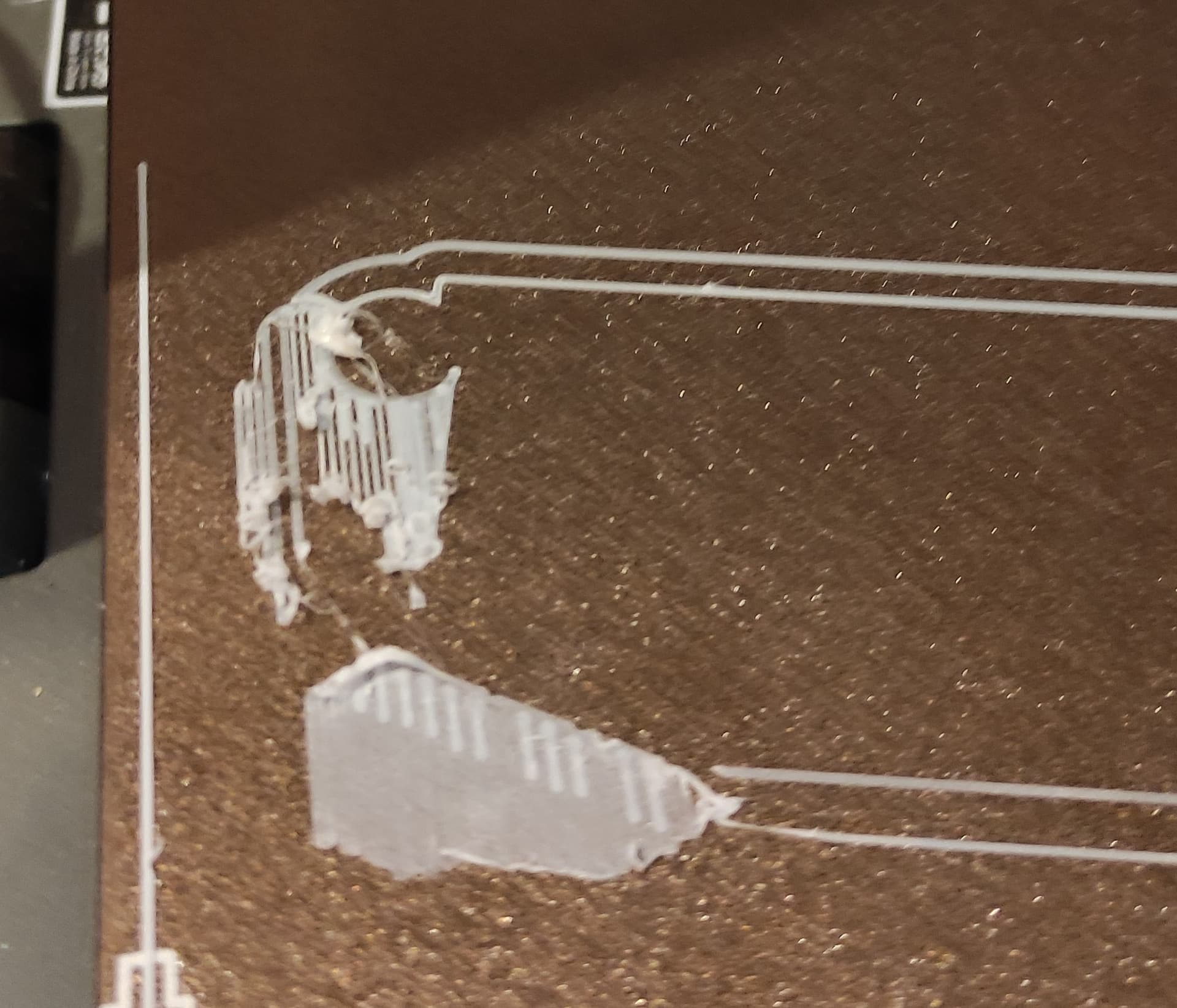

im trying to print something that fits the printing surface. The problem is that almost zero adhesion at the edges, especialy when I print supports.
My table came rather crooked from the factory and I dont know how to fix it

Did you try better “Z off set” numbers? looks to me like a Z off set problem. also that plate is going to need some help from glue or hairspray for first layers in general.
You may want to preheat the bed for 5 minutes before doing the auto level and before printing prints that get close to the edge of the bed
