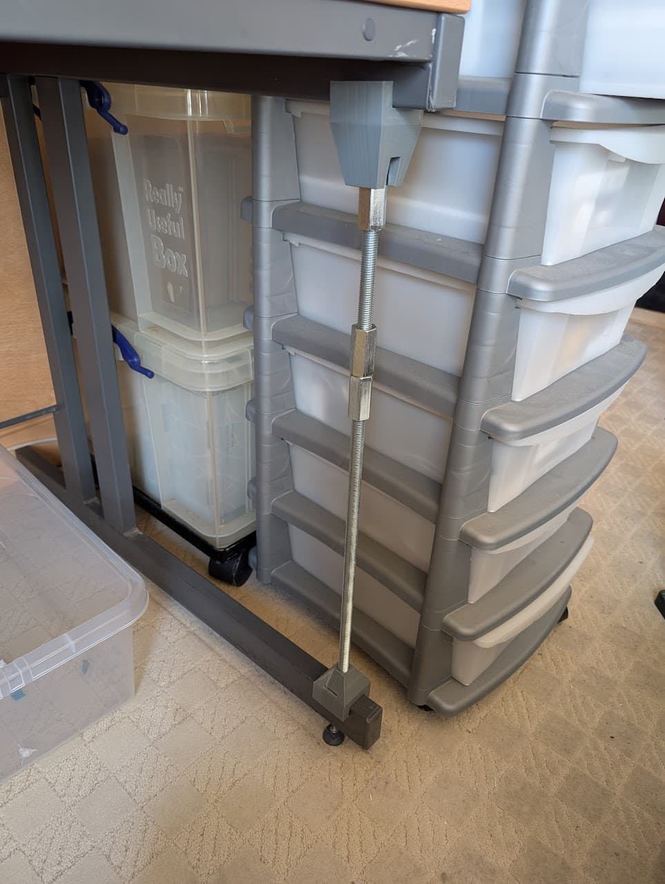

Yeah, my printer is on a worktop bench in my office, which was just using cantilever shelf brackets out from risers on the wall. I had to install an end bracket screwed to the wall and to the front edge of the bench top (the printer is on the end of the bench, up against the corner wall) and a vertical under the printer, screwed to a bracket in the floor. This is now a rigid setup, but it does transmit vibrations through the wall and floor. Fortunately we’re in a detached house, and the end wall with the screwed bracket is an outside wall, but still my wife complains of low frequency rumbles through the house when it’s printing. Not sure how to dampen them with such a heavy printer - my old Prusa was on printed spring feet, which effectively decoupled it from the room - this one is too heavy for that, I fear.

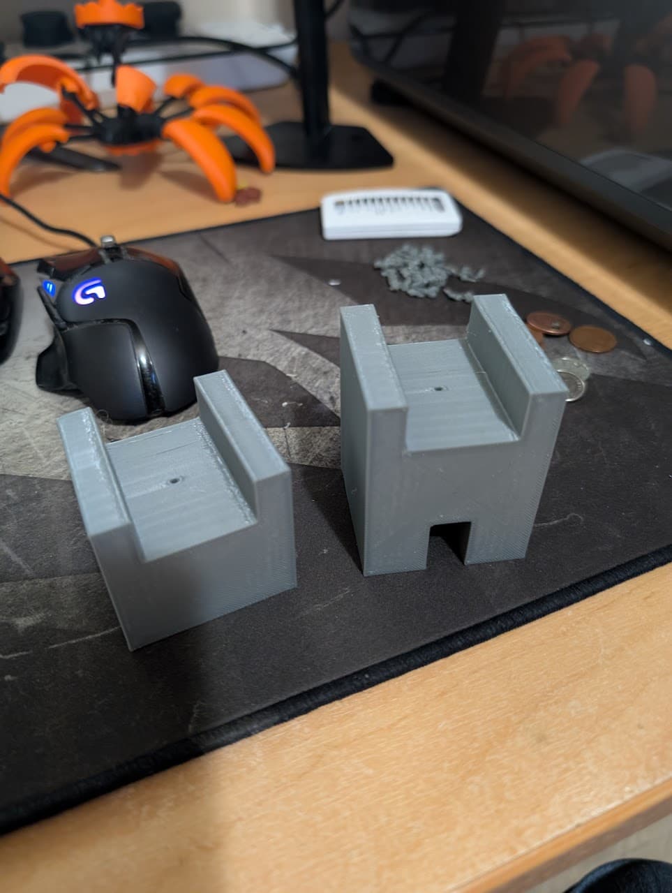

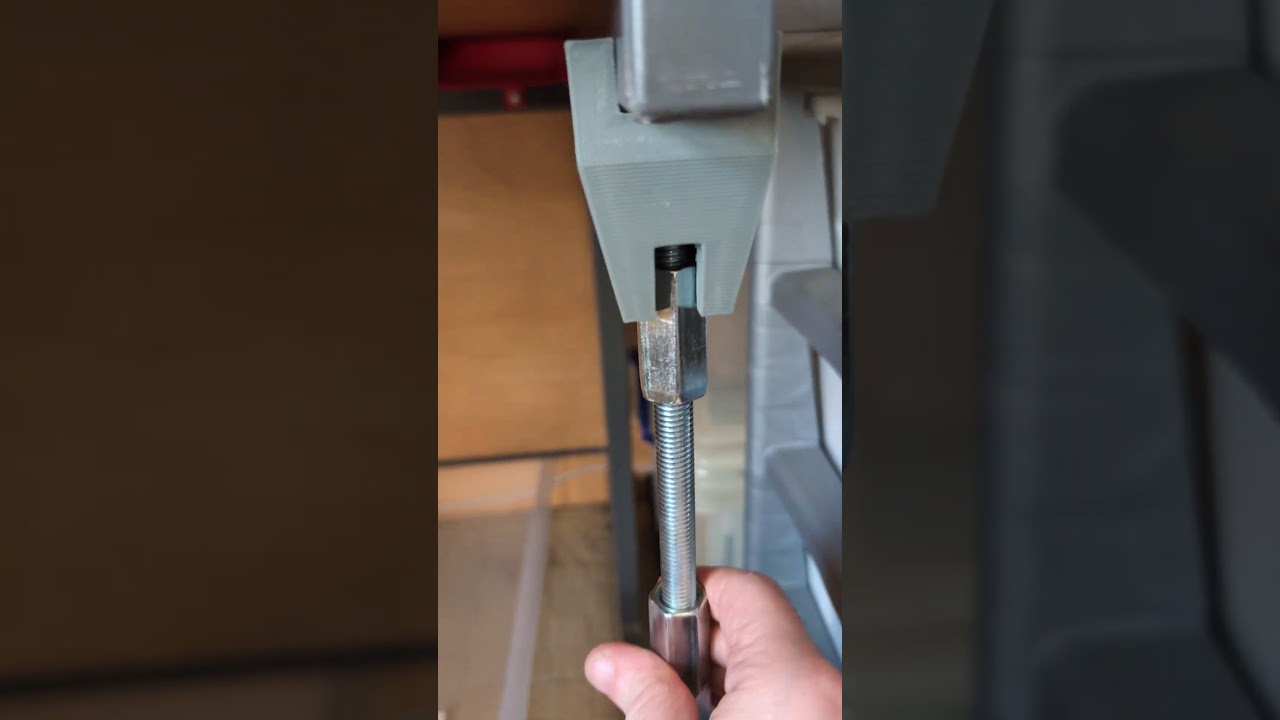

Just musing and decided it’s probably best to use a washer rather than the 5p, for a number of reasons. First it’s easier to slide back out 'cos of the hole in the middle (as long as the hole is still smaller than the diameter of the bar, so the washer still provides the running surface).

Houston, I foresee a challenge but it probably does not matter. Euler buckling. That is a long column, unless you are using a 1 inch threaded rod. There is very little Z acceleration as the bed does not accelerate much compared to the movement of the hot end and Core X-Y gantry. I get no movement at the feet on mine but can feel some x-y movement at the top. I have been toying with the idea of securing the top of the printer to the wall as well via a horizontal plate/shelf. Removing two of the rubber top plugs, machining some aluminum custom standoff spacers for the upper frame bolts, longer bolts and It will get rid of movement and more importantly raise the resonant frequency of the printer as a whole and give me a shelf. More rigid, higher resonant frequency. Ghosting and ringing in the X and Y axes are the target of input shaping and from what little knowledge I have. In bygone days, printing a tuning tower quantified them at various accelerations and graphically represented any issues. I found this on ALL3DP https://all3dp.com/2/klipper-input-shaping-simply-explained.

The vertical rod is at 90 degrees to the X-Y issue and will damp those very little. After sleeping on it, plywood cheek plates against both legs for X and a plywood center plate from leg to leg for Y would make the desk more rigid but there would be some carpet shuffle. Plywood for two reasons, it damps vibration and is quite strong for its weight. Give the Z brace a go and see what transpires.

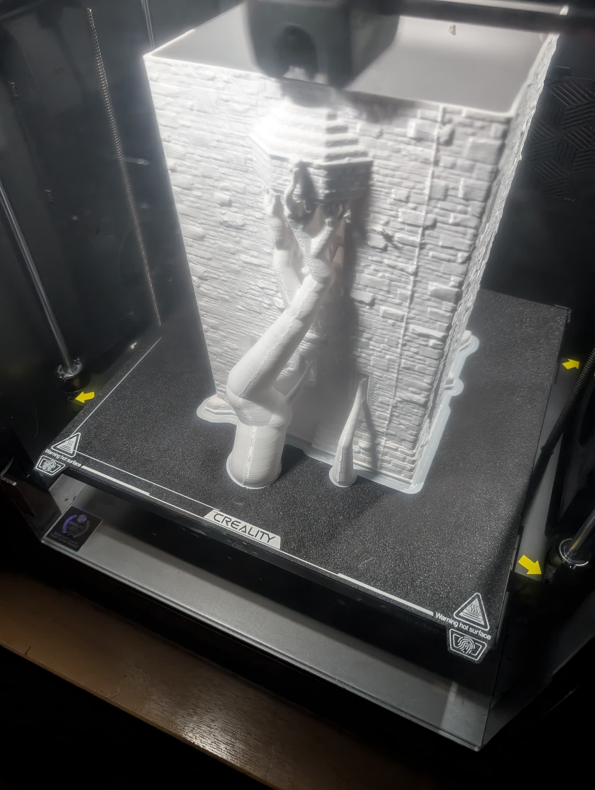

I considered that which is why I went from. M10 to M12…but in my case because of the cantilevered desk I have, most of the energy of the printer is being translated into movement as a sort of pivot around the X axis (in this case defining the X axis as running left to right (if sitting facing the desk as usual) and at the junction of the the cantilever’s upright with the bottom support rail.
I know this because the main cause of actual movement is when the printer does a lot of fast movement in the Y direction (from door of printer to litter tray), and very little when moving in the X direction (from filament cutter stop to spool holder). it is this movement I want to address as apart from the possible effect on print quality it makes my monitor dance which is quite disturbing.
Well., it’s in place and the desk is certainly “stiffer” in terms of resistance to hand movement. I’m going to re-run input shaping and then print the second pair.
Though…if I was looking for quality improvement I may have wasted two days of my time if this is anything to go by…!
A thought; the Creality guidance is to run input shaping with “no filament loaded”.
What does it mean by this? No filament in the CFS? Because I’m thinking sticking somewhere between 0 and 4 kg on top of the machine may have an effect…
Well, this seems to work exceptionally well. The vibration is still there, but the amplitude and energy of it seems greatly reduced; My monitor isn’t dancing around and it even seems quieter.

My braces are both in now and seem to be working well. I might share the design as this is a common type of desk in the UK. Even if people don’t have exactly the same one it may Inspire them!
Think it best to actually print something with them both on first though, so just waiting to dry some clear PETG for another interesting little diversionary project…
