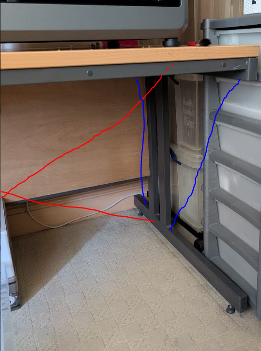

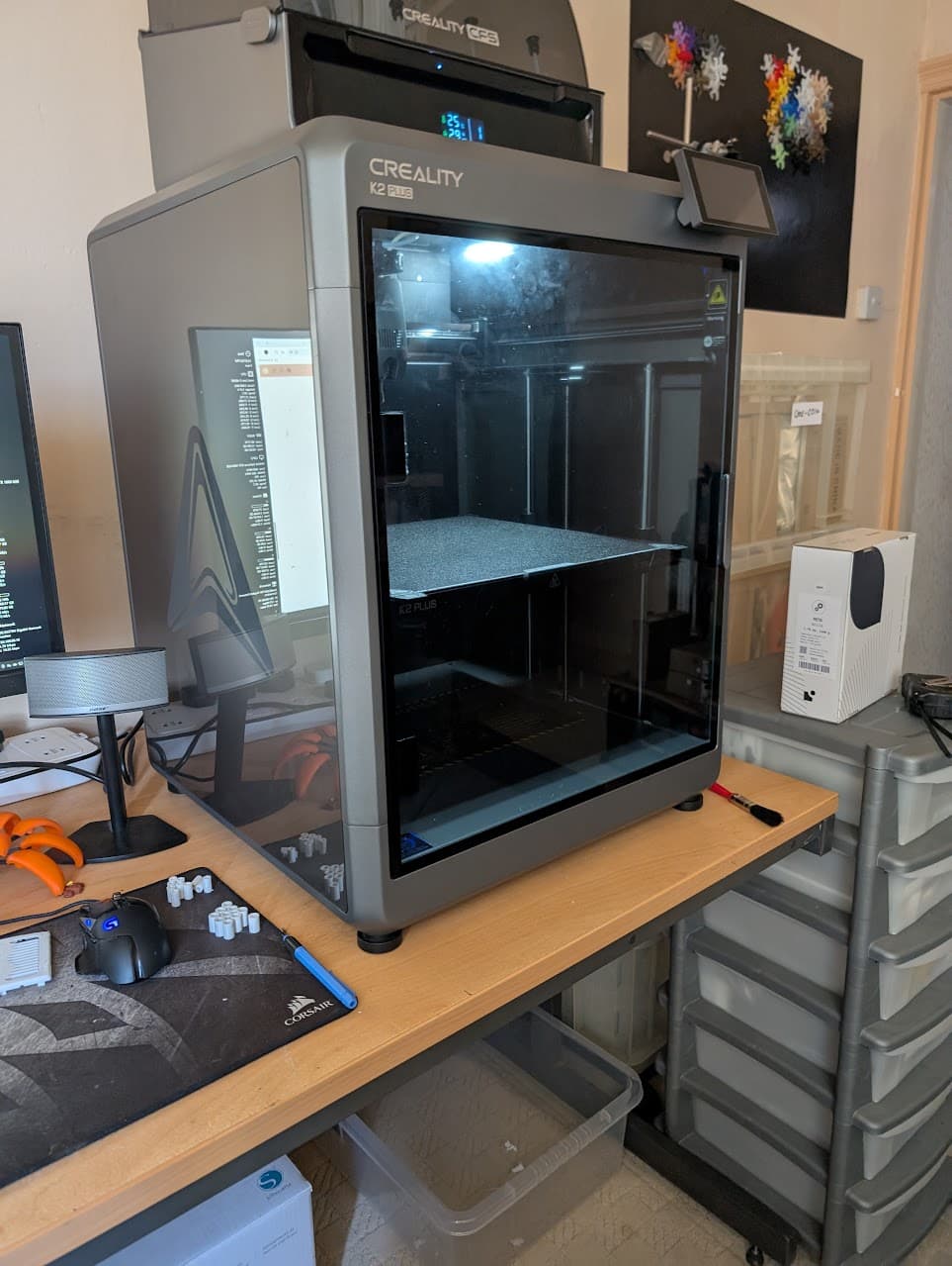

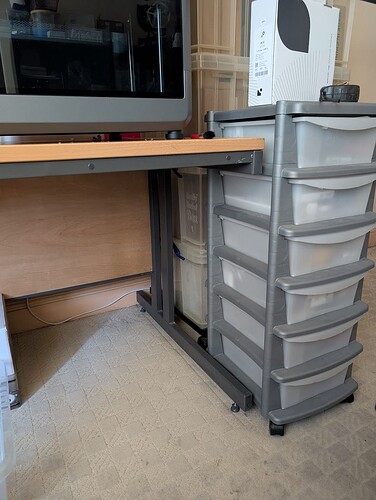

The desk my printer is on is sturdy, but supported asymmetrically - the metal uprights are only about 15cm from the back wall, but 60cm from the front of the desk. As a result…yeah, things move a bit when the K2+ is getting it’s freak on. I am thinking this is Not A Good Thing (Winnie the Pooh capitalisation intended).
I was thinking of bracing it with some timber parts, or maybe threaded rod. The printer wouldn’t move from it’s current position. Would I have to run Input Shaping again on the modified, hopefully less bouncy desk?
I would run it again once finished, the “different” platform will react differently. I moved my Qidi Xplus3 to a different desk and it was totally different in how the printer reacted to the movement in that desk. It is now back to my proper welded workbench, you could stick a big old Myford super 7 lathe on that and it wouldn’t move.

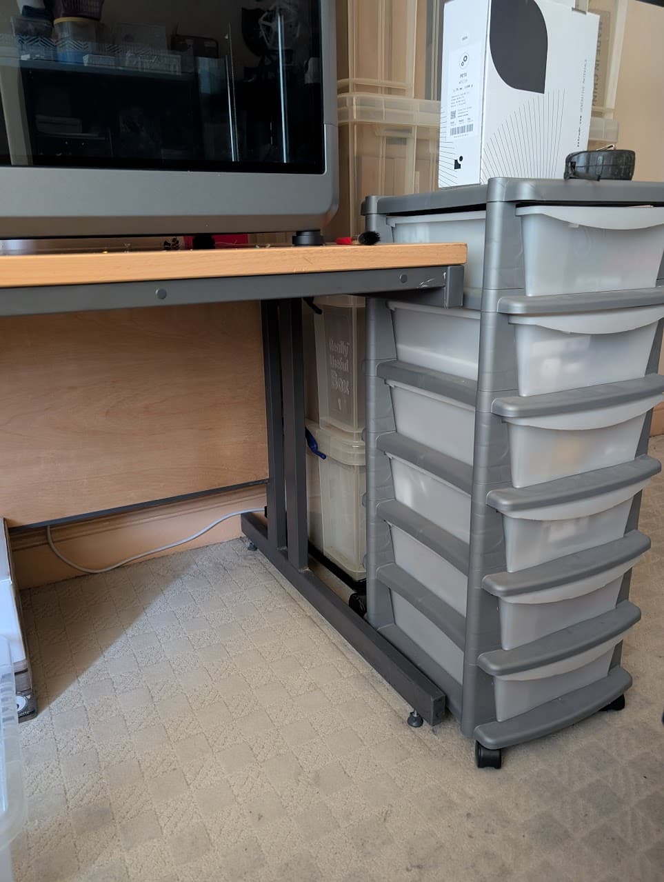

Any chance you could post a photo of what the situation looks like to get an idea for thoughts ?
Cheers.
Sure…the issue is there’s not really any fixing points so I’ve either got to drill through the metal (which is very hard, I’ve tried before) or create some sort of channel to fit around the metal box section. Timber was my first thought, but that changes dimensions with temperature and humidity…that’s why I wondered about some sort of heavy duty threaded rod which would enable me to adjust and allow for changes. There of course might be some 3D printed parts involved!
Even though the printer sits to the far right of the desk, I was thinking I’d have to mirror the support on the left hand side too for it to be completely effective.
Hello GreyArea,
I don’t think you would have the problems with Merbau wood.
That desk is not really the best design to use for something that heavy and vibrating.
I don’t see front struts ??
A cross bar at the back and in the front would help also.
If you are good with wood, you could make some 90deg brackets that attach to the wall and come just past the 2 uprights, with a hole in it between the uprights to use a bolt that goes through another piece the other side of the uprights and they clamp together.

Cantilever desk, think that needs a front strut at least for bracing.
I do have a bit of experience from an engineering perspective on this challenge. I am not going to stake my 35 years of experience on this fix though, lol.
There are some other anti bouncy bouncy at your place (Monty Python) options.
As you noted, the timber that would be needed is big and subject to dimensional change but that would not matter too much. Desk carcass is steel and looks to be reasonably rigid in Z. Not to bad in Y (fore and aft on the desk). X sucks. The desk could be lagged to the wall but fair warning, I did this and on certain prints, one floor above it can sound like distant thunder. If the printer happens to hit the resonant frequency of the wall it is attached to, you may get some not so good vibrations (Beach Boys). By the light switch in the picture, you appear to be in Europe where construction is MUCH more solid as a rule. My tympanum wall is 2x4 stud lagged to a concrete floor, drywall on the other side. If you can lag it to a concrete or brick wall you may be in luck. Attach an angle or similar robust bracket to the steel carcass of the desk and lag that to the wall in at least two places, below the printer legs would be optimal. X and Y will be anchored and the printer does not have much tendency to jump so Z should not be an issue.
If you have a Jack Sparrow response to that option (stop drillin 'oles in my wall!):
The Y axis can be stiffened by adding blue threaded rods (1/4" to 3/8" or metric equivalent, should be more than sufficient). Desk top would have to come off and angled holes drilled with top counterbores. Print up some wedge washers for the tensioning end at a minimum. Or 10 or more self tapping sheet metal screws into a sheet of 15mm ply “cheek plate”. A square/rectangular piece of ply screwed to the outside of the leg. If you paint it, it could look like it belonged there.
My bets are issues with X, across the build plate parallel to the door glass when shut is the worst. The red threaded rods will fix that but impede getting a chair under the desk. One set where the verticals may be enough. One set front and one set aft would be more rigid but may actually bend the desk if tightened too much. You could put the rods through the ply near the steel carcass too and not have to drill as much steel.

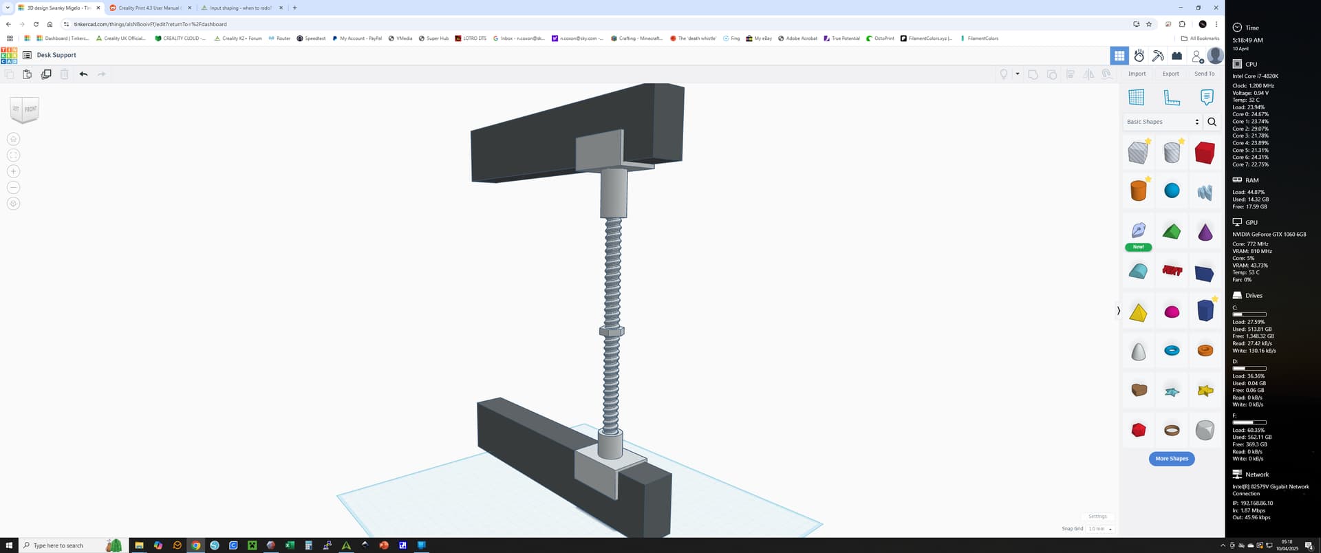

I’m thinking aluminium channel, threaded rod and a threaded cylinder at the top, plain socket at the bottom. The nut in the middle is either welded or epoxied in place so when you turn it the whole bar turns (in the unthreaded bottom socket, but engages the internal screw thread in the upper cylinder to expand or contract the distance between the two brackets.
So I’ve planned it, now I’ve just gotta DO it…!

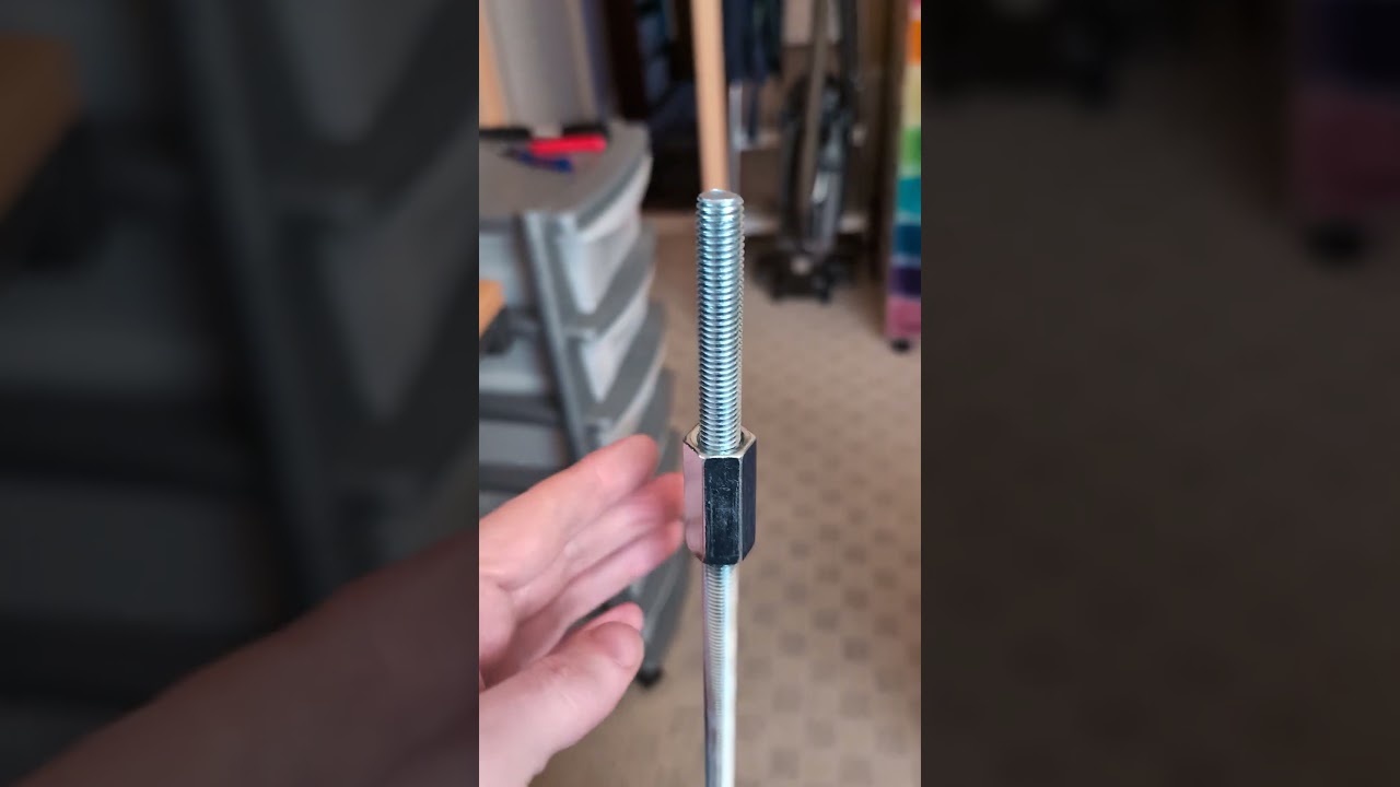

Obviously I’ll need a wearing surface for the rotating bar, but I have an idea about that…and replacing my idea of a single nut welded to the bar, since Screwfix only sell the stud connectors in packs of ten…I’ll just lock two of them together.

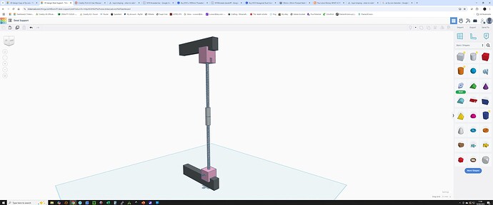

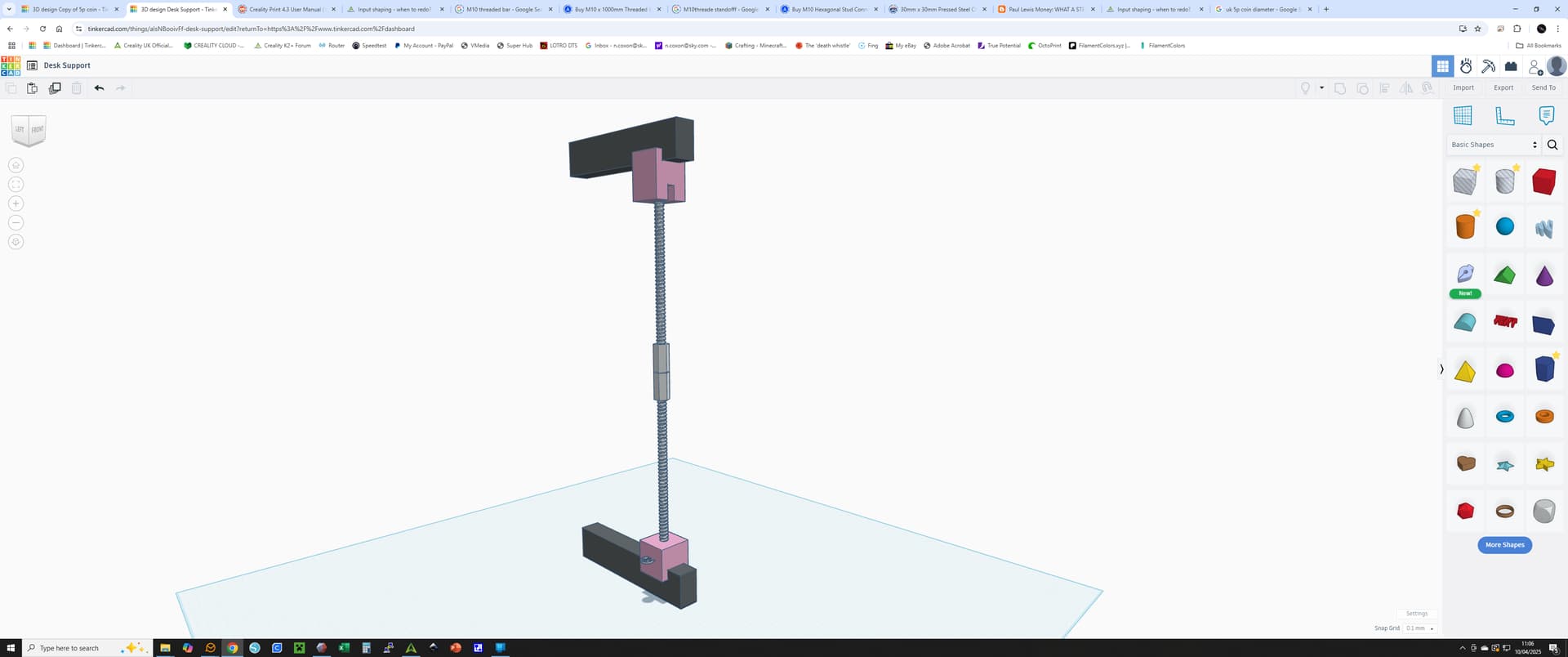

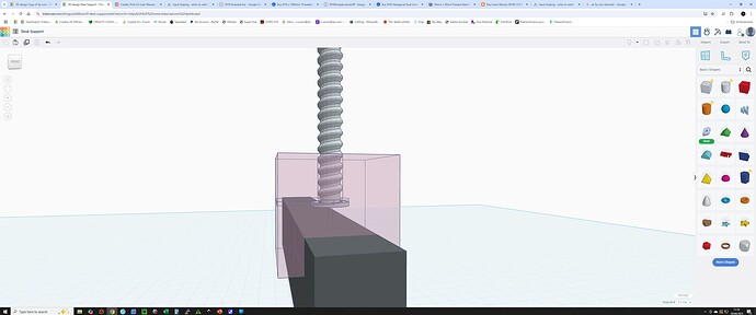

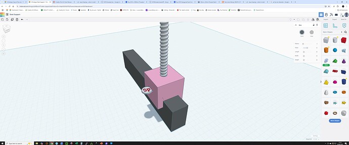

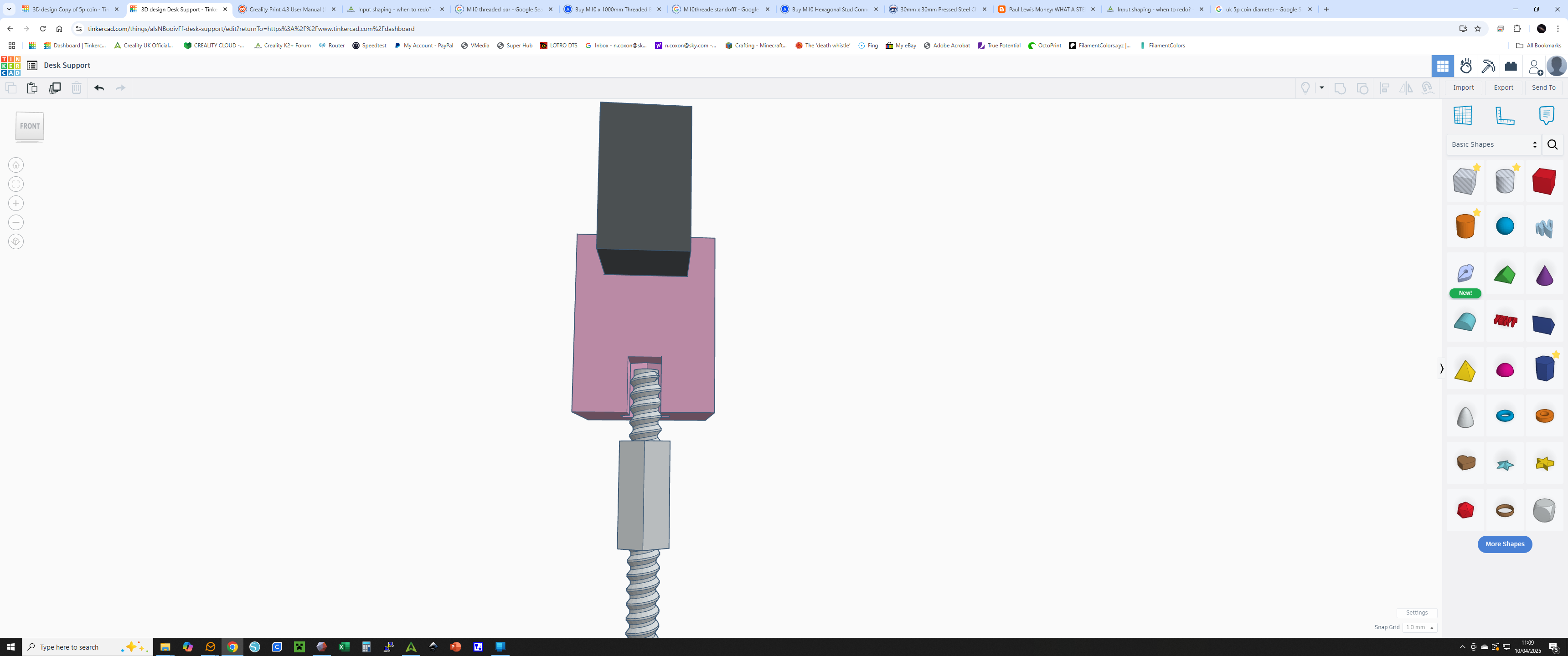

Right…version 2…
The dark grey bars are the spars on the desk. The pink blocks (I call it “prototype pink”, and I use it to make details stand out) I will print from PETG, probably in grey. The threaded bar (on nipping down to my local hardware store I decided M10 looked too weedy and upgraded to a more chunky M12) needs to be 530-535mm. Those big chunky stud joiners are 40mm long, so I have 20mm play either way.

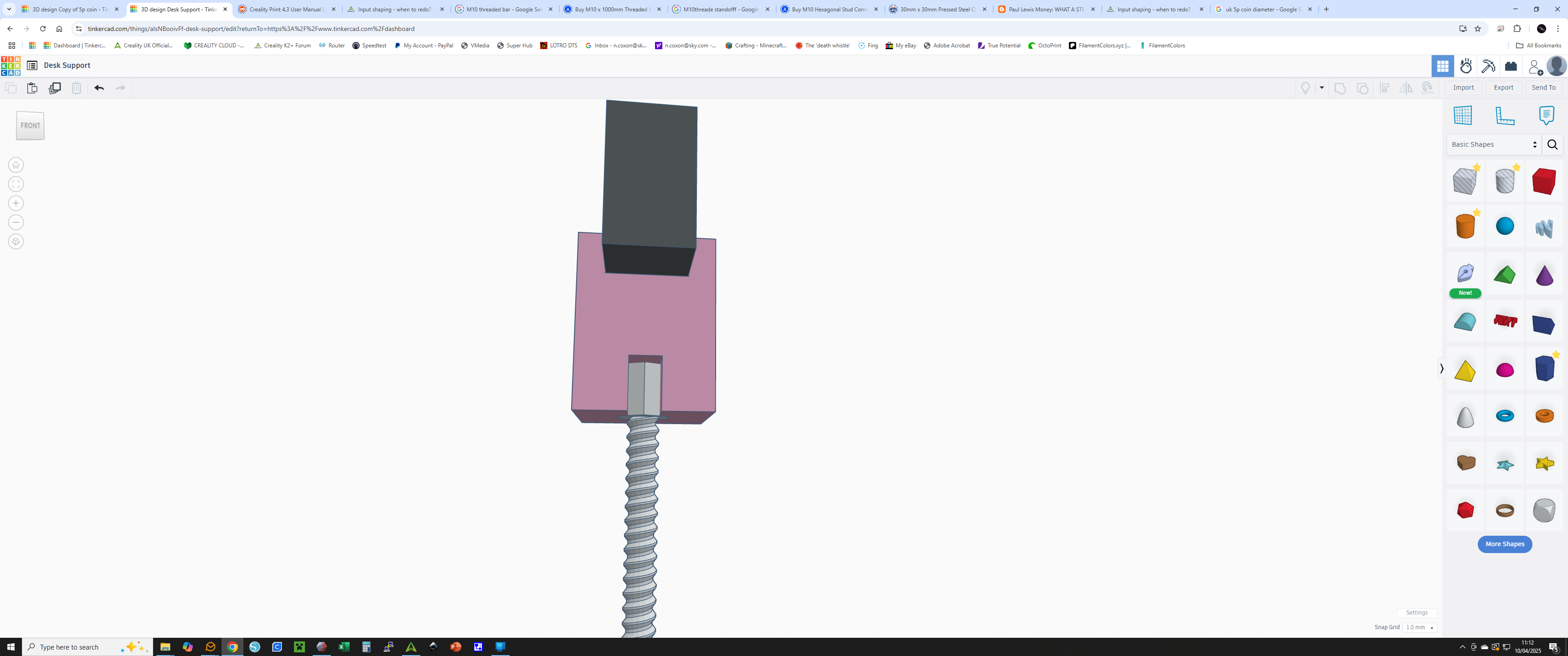

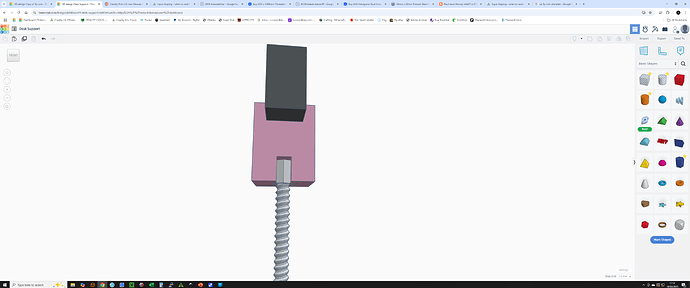

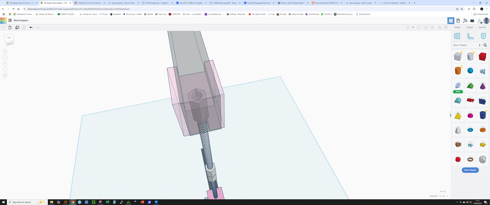

A closer look at each block, top one first;
The slot allows me to push the bar in from the side then by turning the top of the locked pair in the middle clockwise, the threaded rod will push the stud joiner at the top into position.
(I’ve also drilled a 2mm hole in from the other side so I can push the stud joiner out if I need to)

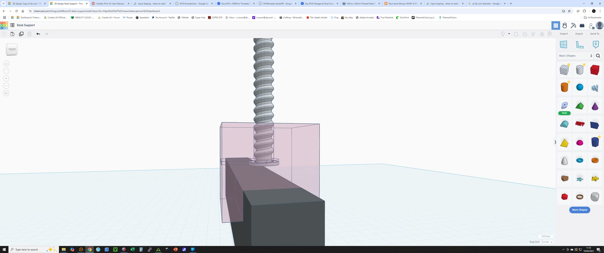

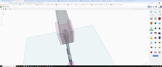

Bottom block;
I’m feeling quite smug about this…obviously if I’m twisting a metal rod on a PETG block, wear is going to be an issue…but that’s where the 5p coin comes in…
The coin pushes in from the side and then drops into a circular depression. Again there’s a 2mm hole so I can push the 5p coin out of the block if I need to.

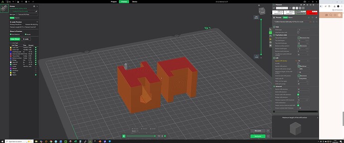

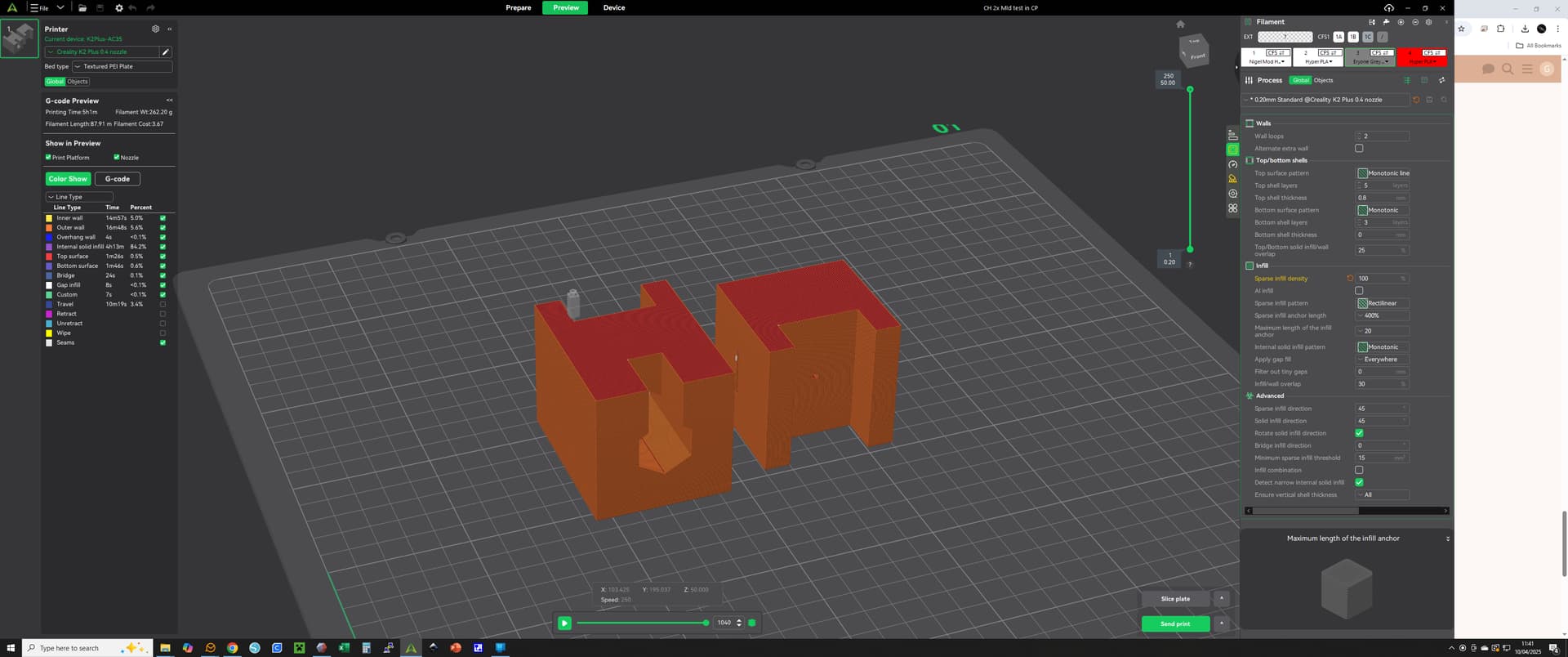

The only issue I’m going to face is orientation when printing…I’ll need
to print without support as there’s no way I’ll get it out of those tiny voids, but at the same time to give the brackets enough strength my printing orientation is pretty much dictated. I’m just about to export them to Creality Print for a play around…there will be no hacksaws applied to my threaded bar unti lI’m sure the PETG brackets can be printed (in fact have BEEN printed).
Think I’ve gone way overboard on depth to be honest…but we’ll see. Just printing one pair for now, but agree I’ll need to do both legs…
I don’t think this needs any further clarification. I’ve got 5 hours till the print finishes…
