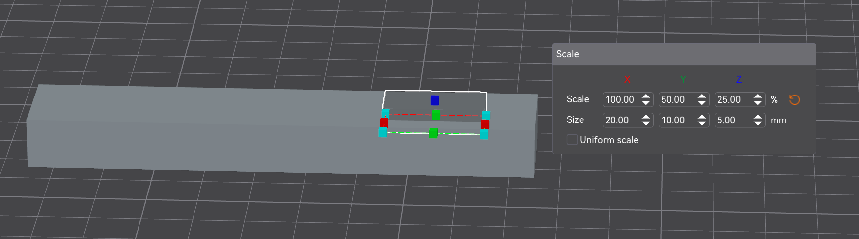

  1. There are multiple ways to do this, but the simplest is to create a negative solid matching the magnet dimensions, then position it where the cavity is required.
    For this example, assume a 10 x 20 x 5 mm bar magnet. The same principle applies to cylindrical magnets.
a)
b)
c) Move the negative solid into position so it just intersects the layer above where you want the magnet to sit.
You can use the dialog box for precise placement; the arrows are fine for coarse positioning.
Magnet
d) Slice the model. Using the layer slider, insert a pause at the last layer before the magnet will be fully covered.
The pause must occur after the cavity is printed but before the encapsulating layer is laid down.

Create the model you want to add a magnet to as normal. Import it into your slicer and slice.
On preview screen, figure out what layer you want the magnet to be into by using the layer slider on the right.
Back in prepare, right click on the model and add negative part. I use a disc for disc magnets. Make the negative disc very slightly larger than your magnet. Move it into position at the layer you want the magnet.
Reslice. On the preview tab, use the layer slider again to check the magnet void. Go to the layer just before it starts to add the top over the void. Right click on the + at the top of the slider and add pause at that layer.
Reslice.
When you print it, it will pause at the layer you set. Add the magnet, then resume the print from your main screen as normal.
