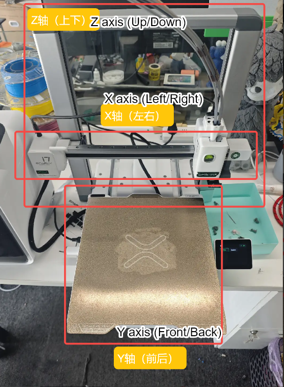

The i7 uses a Cartesian coordinate motion system with a maximum build volume of 260 × 260 × 255 mm³. Its motion system consists of the following components:
X-Axis Motion System
The X-axis motion system consists of a high-precision linear rail and a horizontal beam. The print head is mounted on the linear rail carriage, which can move smoothly along the horizontal rail. By controlling the left–right movement of the carriage, the print head achieves precise positioning along the X axis.
Y-Axis Motion System
The Y-axis motion system is composed of two high-precision linear rods and the build platform. The build platform is mounted on linear rod carriages that can slide freely along the horizontal guides. By controlling the forward–backward movement of the carriages, the build platform moves accurately along the Y axis.
Z-Axis Motion System
The Z-axis motion system controls the vertical position of the print head relative to the build platform. It consists of a dual linear rod and linear bearing guide assembly, dual lead screw and nut sets, a stepper motor, and a synchronized belt drive system. The two lead screws are mechanically linked via a timing belt driven by the stepper motor, ensuring synchronized motion. In addition, the timing belt is equipped with a quick tensioner and works in conjunction with a belt tension detection algorithm to maintain optimal belt tension. This design ensures precise and stable movement of the print head along the Z axis.

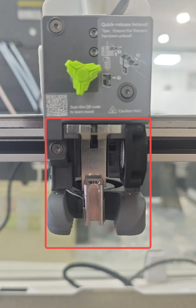

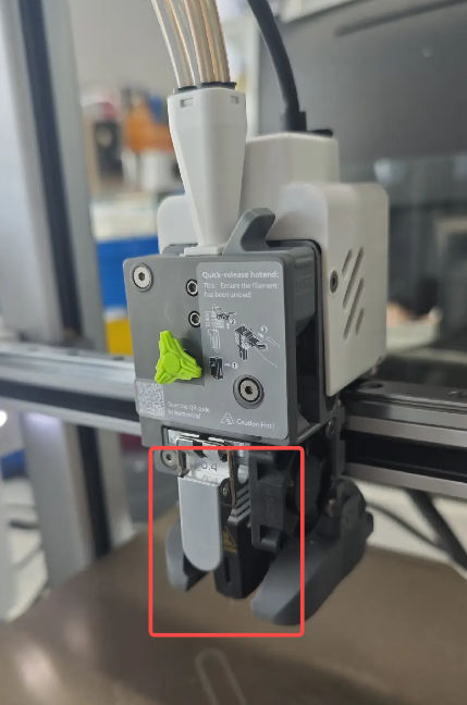

Toolhead Module
The tool head module is one of the key components of the i7. The i7 tool head module mainly consists of the following parts:
Tool Head Module
Hotend and Silicone Sock
Hotend Heating Assembly, Hotend Fan, and Part Cooling Fan
Hotend Assembly
The hotend assembly consists of the hotend heating assembly, hotend, silicone sock, and hotend fan, and is the core component of the tool head module. Its function is to heat the filament to a specified temperature, melt it, and deposit it layer by layer to form the printed model.
The i7 features a quick-release hotend with an integrated nozzle and heat break. This integrated design enables significantly faster heating compared to conventional hotends, and allows the hotend to be removed or replaced without the need for tools such as screwdrivers.

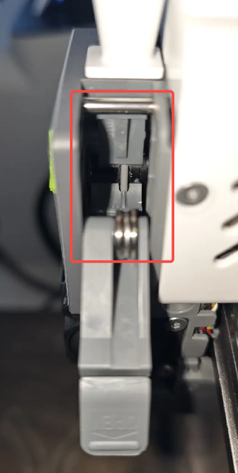

Within the extruder assembly, the latch at this position can be opened to directly inspect filament jams, filament grinding, and filament debris accumulation. This design makes maintenance and cleaning more convenient.

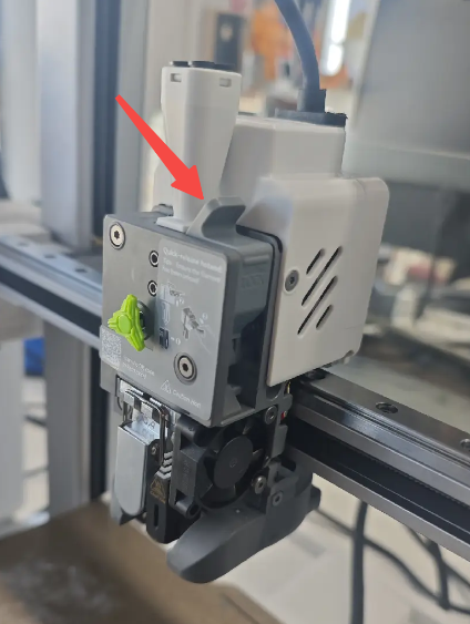

Filament Cutter

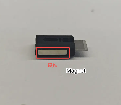

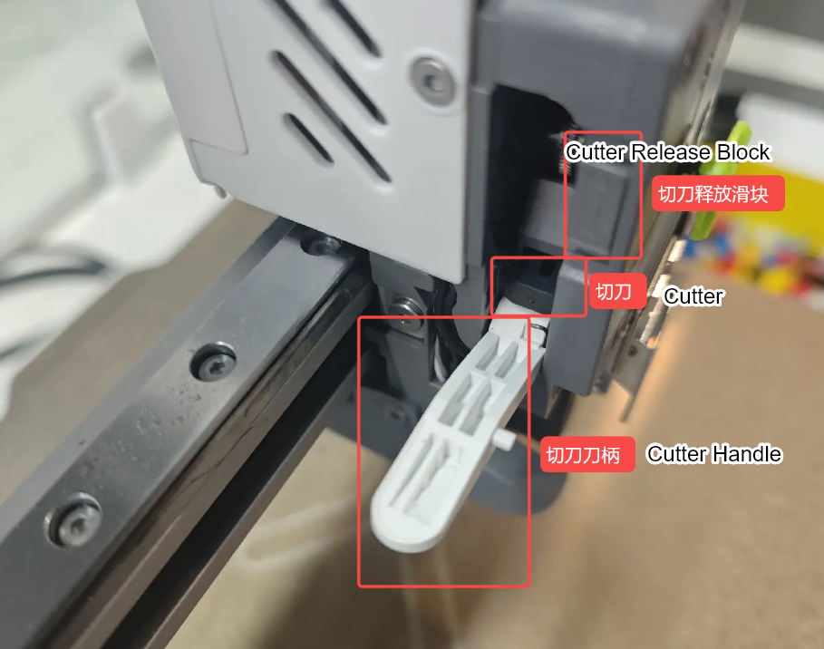

The filament cutter handle is mounted on the extruder assembly and is used to secure the cutter and the filament detection magnet. During the cutting process, the cutter is actuated by pressing the handle with the X-axis left-side pin, which drives the blade to cut the filament. A magnet is installed on the side of the cutter, which repels against a corresponding magnet on the tool head. This magnetic repulsion allows the cutter and handle to automatically return to their original position after cutting.
The i7 features a split-design filament cutter, allowing the cutter to be replaced without removing any screws.

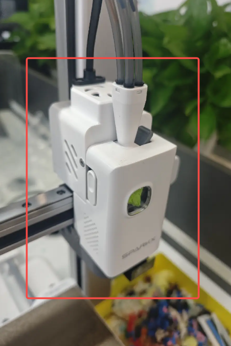

Toolhead Manifold and Filament Sensor
The PTFE tubes are connected to the tool head’s Toolhead Manifold, which secures the four tubes together and allows the tool head to feed up to four different filaments. When used with the multicolor printing module, this enables multi-color printing.
Below the Toolhead Manifold is an Filament Sensorthat detects whether filament has entered the extruder gears. If filament is present in the extruder, the baffle is displaced, triggering the optical sensor.
(Diagram of the five-way connector and optical switch)

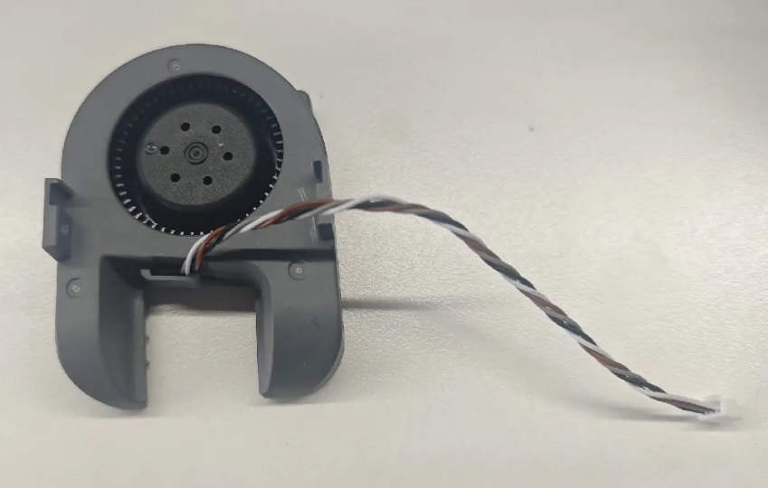

Part Cooling Fan
During high-speed printing, effective cooling of the printed layers is essential. The i7 is equipped with a custom 5015 centrifugal fan with two opposing air outlets, directing airflow precisely near the nozzle to ensure rapid cooling of printed parts.
