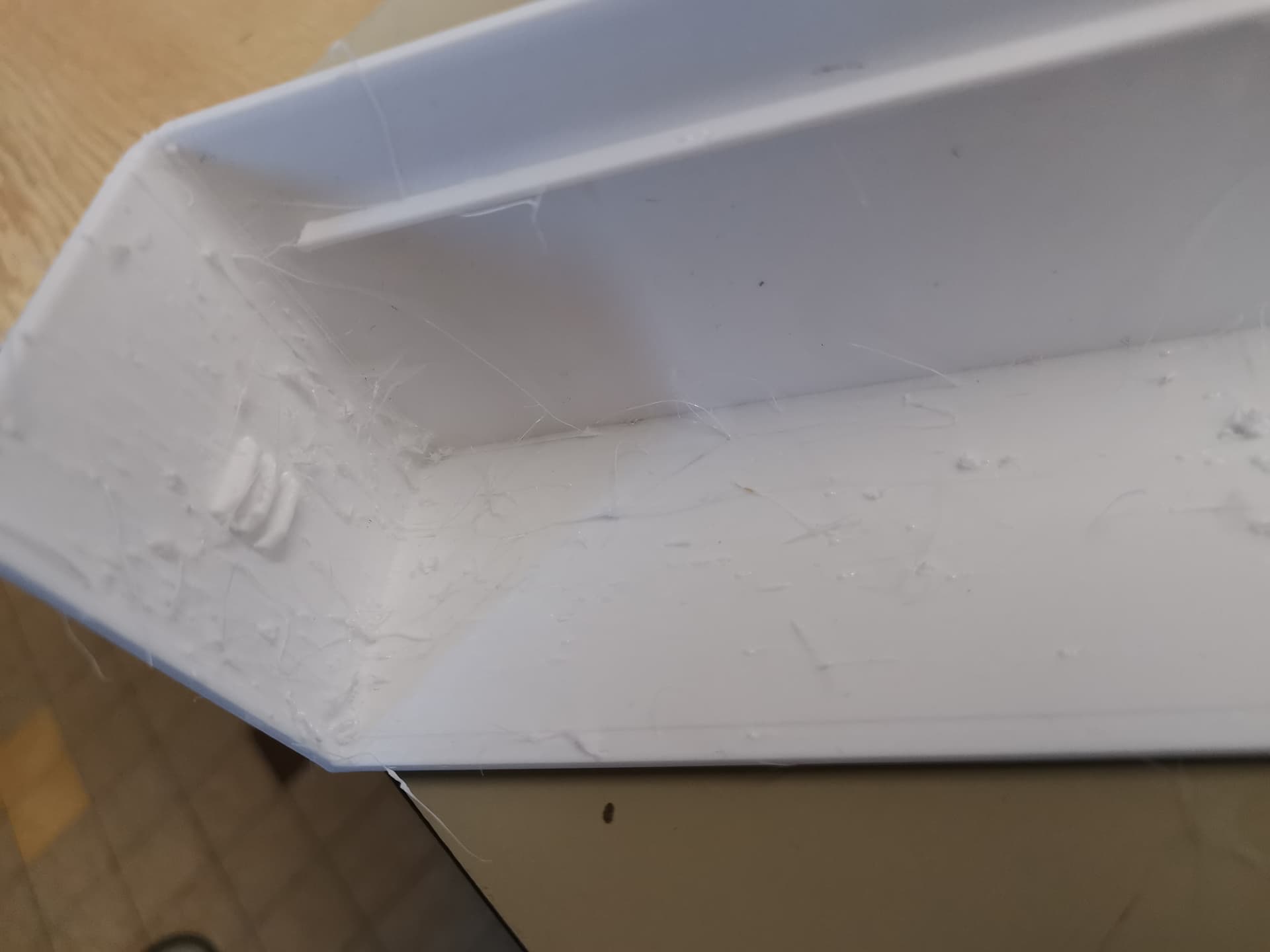

So what’s happening today is we have a creality CR-10 max. It always had a few issues, mainly just stringing on prints but it was ok.
Until recently when it became nightmarish. I don’t know what caused the recent changes. Maybe it got too cold at some moment ? Maybe it’s because it wasn’t used for like 1,5 months ?
I added the pictures to make things clearer.
So here’s all what happened :
We started with issues on the print. At first we tried to calibrate the bed, to ending up noticing it had became warped (the center is lower than the sides).
After some trial and error, I ended up with a very satisfying result… at least for a few layers because after it turned wrong.

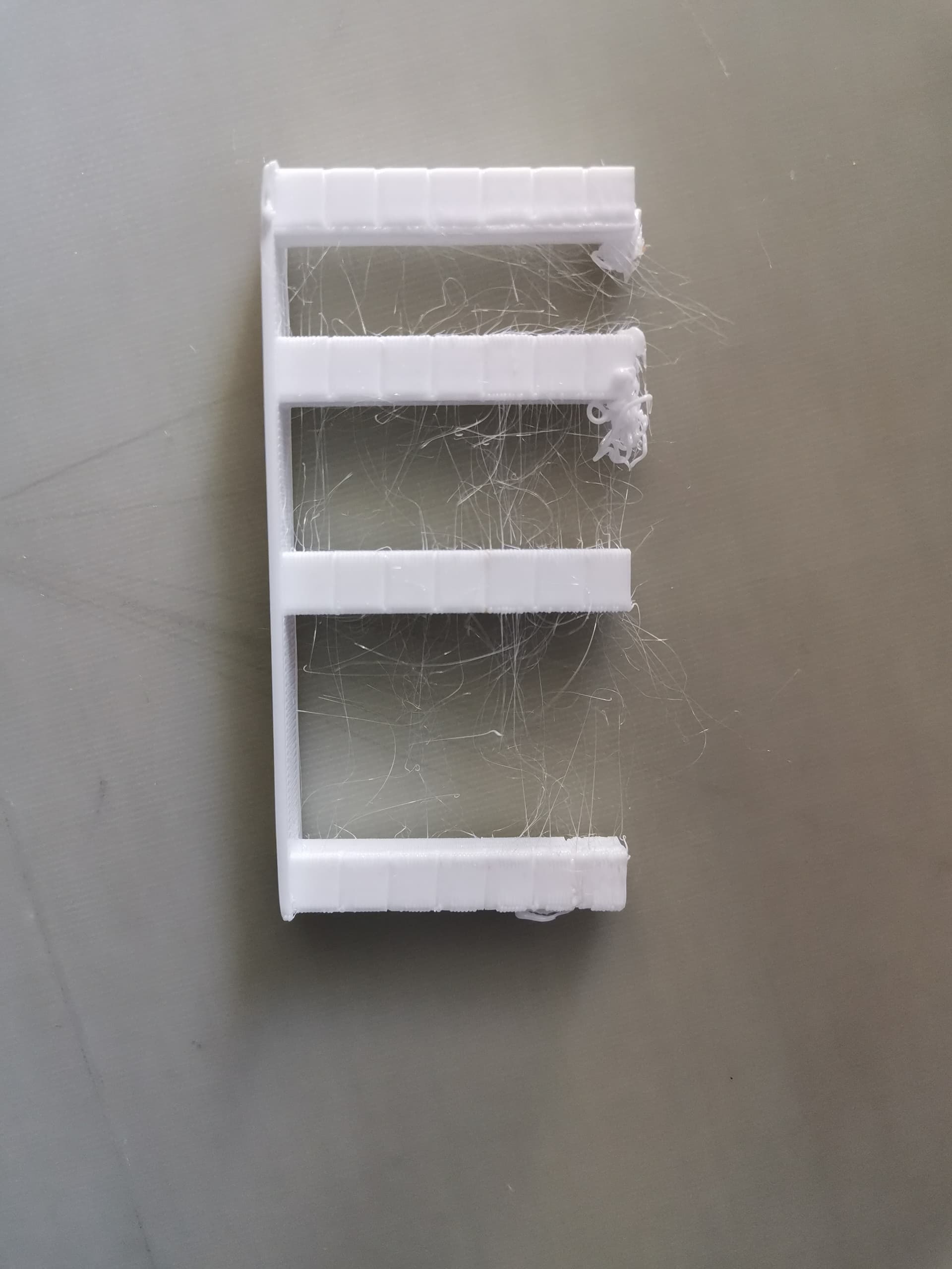

We tried to clean the nozzle, we tried different retractation settings. I looked up and tried a retractation test model (you can see it on the pictures). It started ok but when I came back, as you can see a bit on the top it started to go spaghetti and print on air.

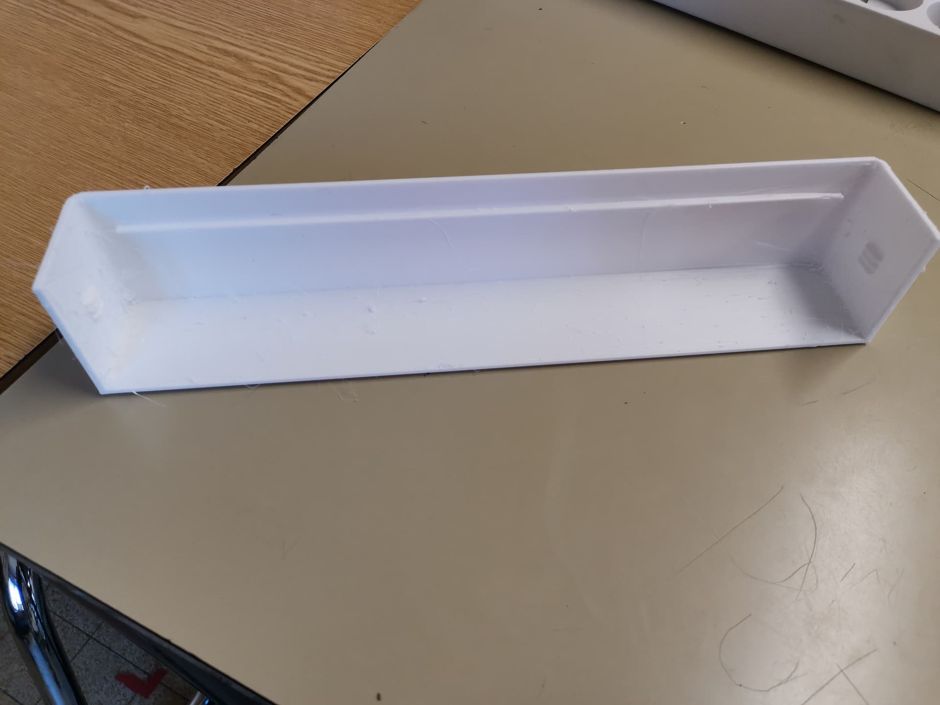

Anyway, you see here picture of the piece we have to make.
I don’t think retractation settings are the problem here. But no matter my research or time taken to try settings, I have zero lead to what could cause the issues here.
For information, at 120% speed it managed to string way less. But there’s still damage on the print.

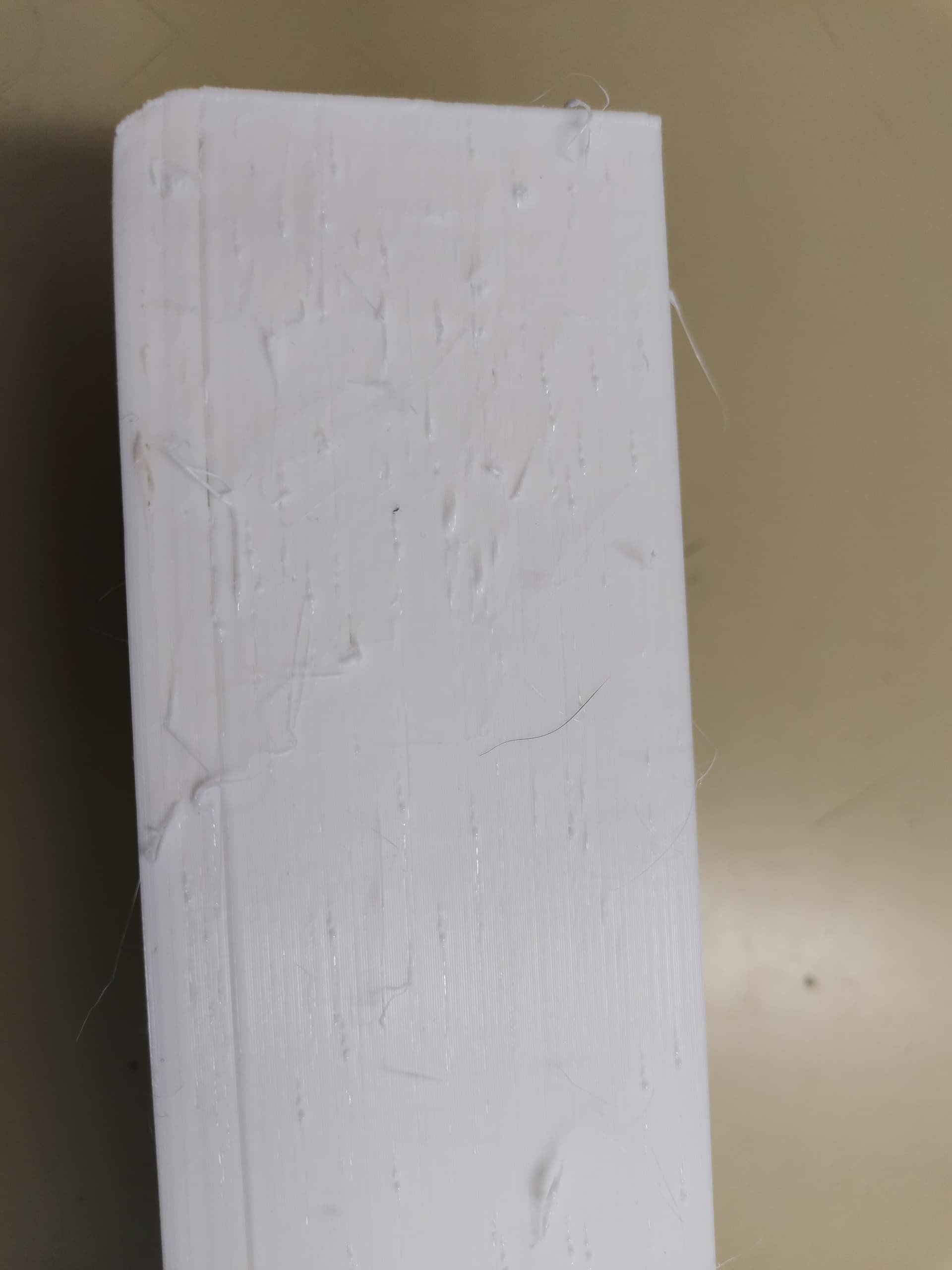

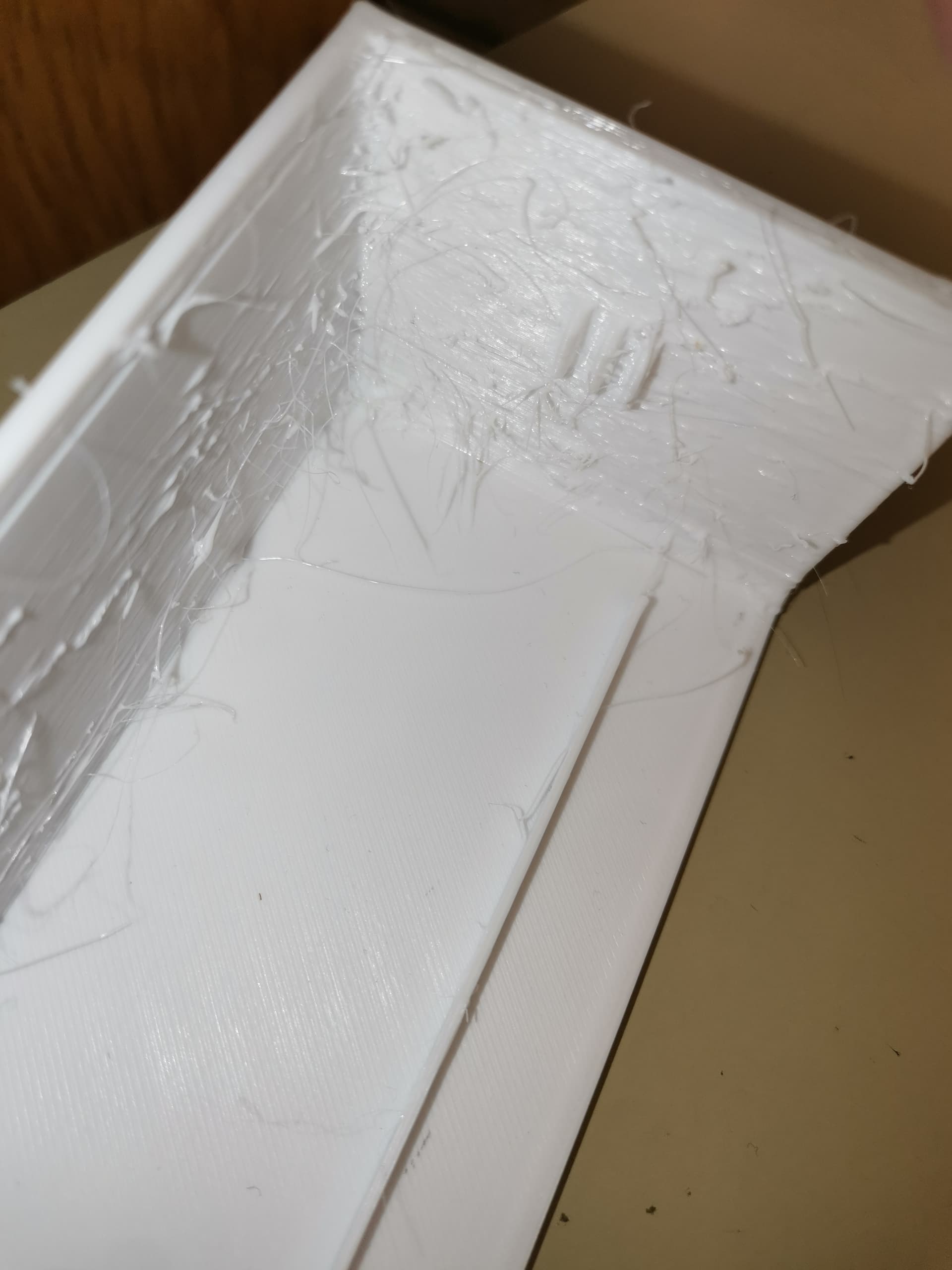

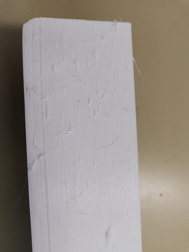

If anyone has any idea to what could cause this (the damaged walls), I’ll be extremly thankful.
