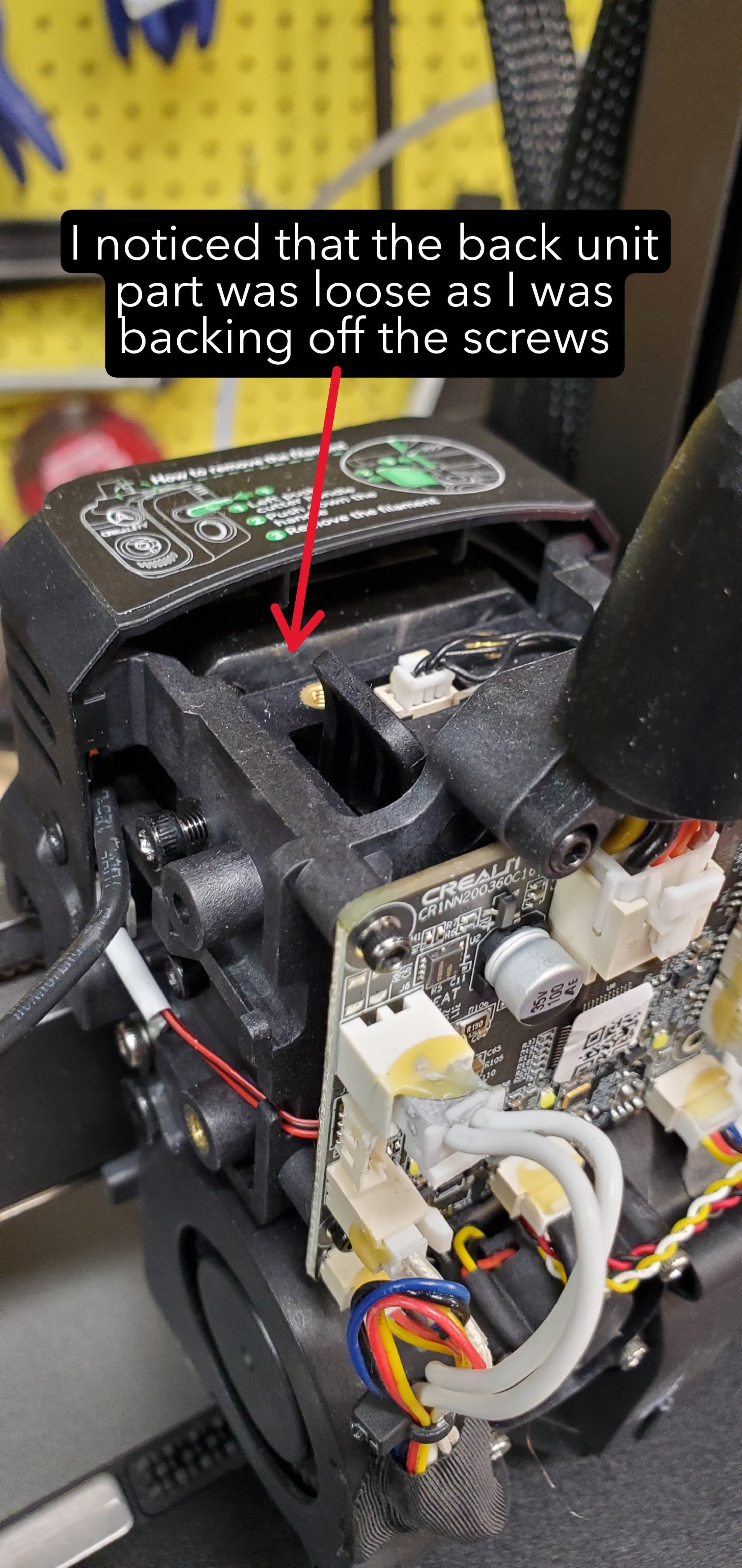

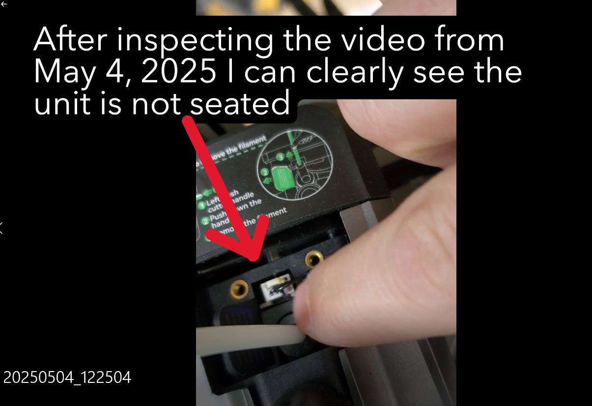

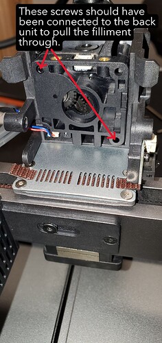

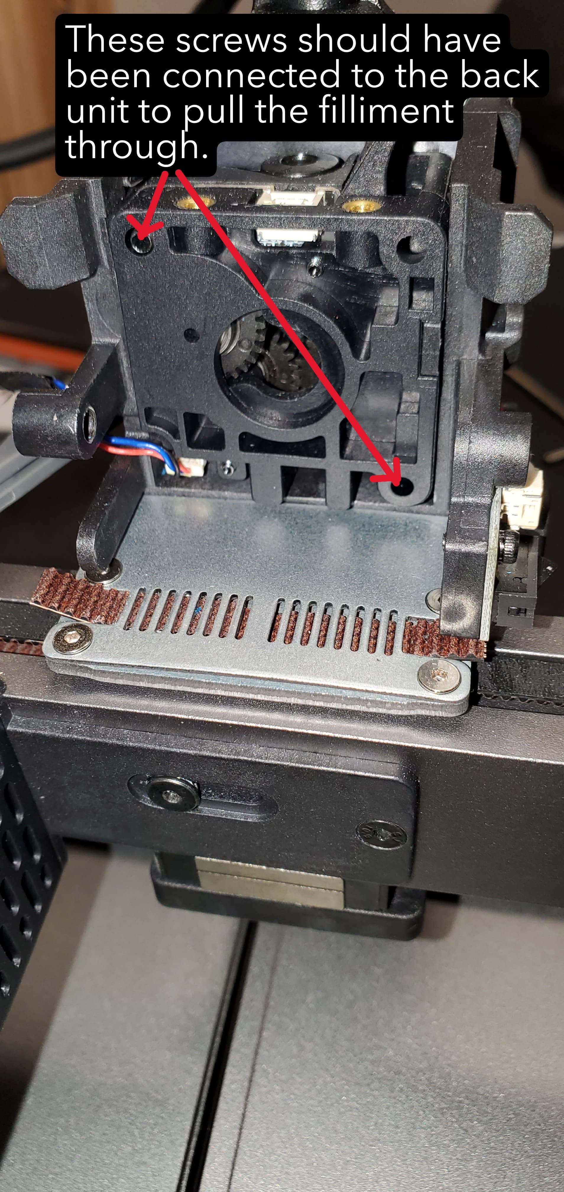

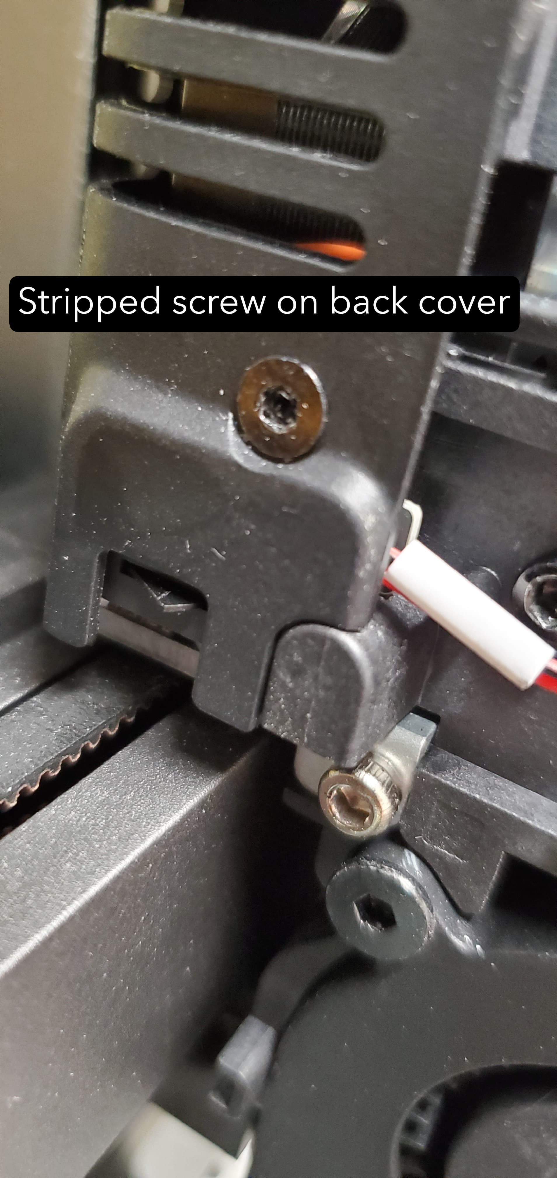

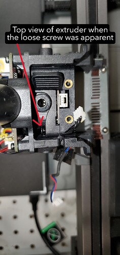

A quick update on the issue. It turns out the extruder gear motor piece was not assembled correctly from the factory. I was working with support via email and they sent me instructions to disassemble the head, once I got through some stripped screws (not happy) I then noted the screws were not attached to the extruder motor part. I simply seated them, re-assembled and have been printing ever since.

Yes I have, these are the pictures that I sent to service when I discovered the issue. I think it was just a poor quality issue from the factory. Essentially the extruder unit was not attached, the side screws holding the cover plate on were stripped and I had to extract them the hard way (drill them out and use a screw extractor).
