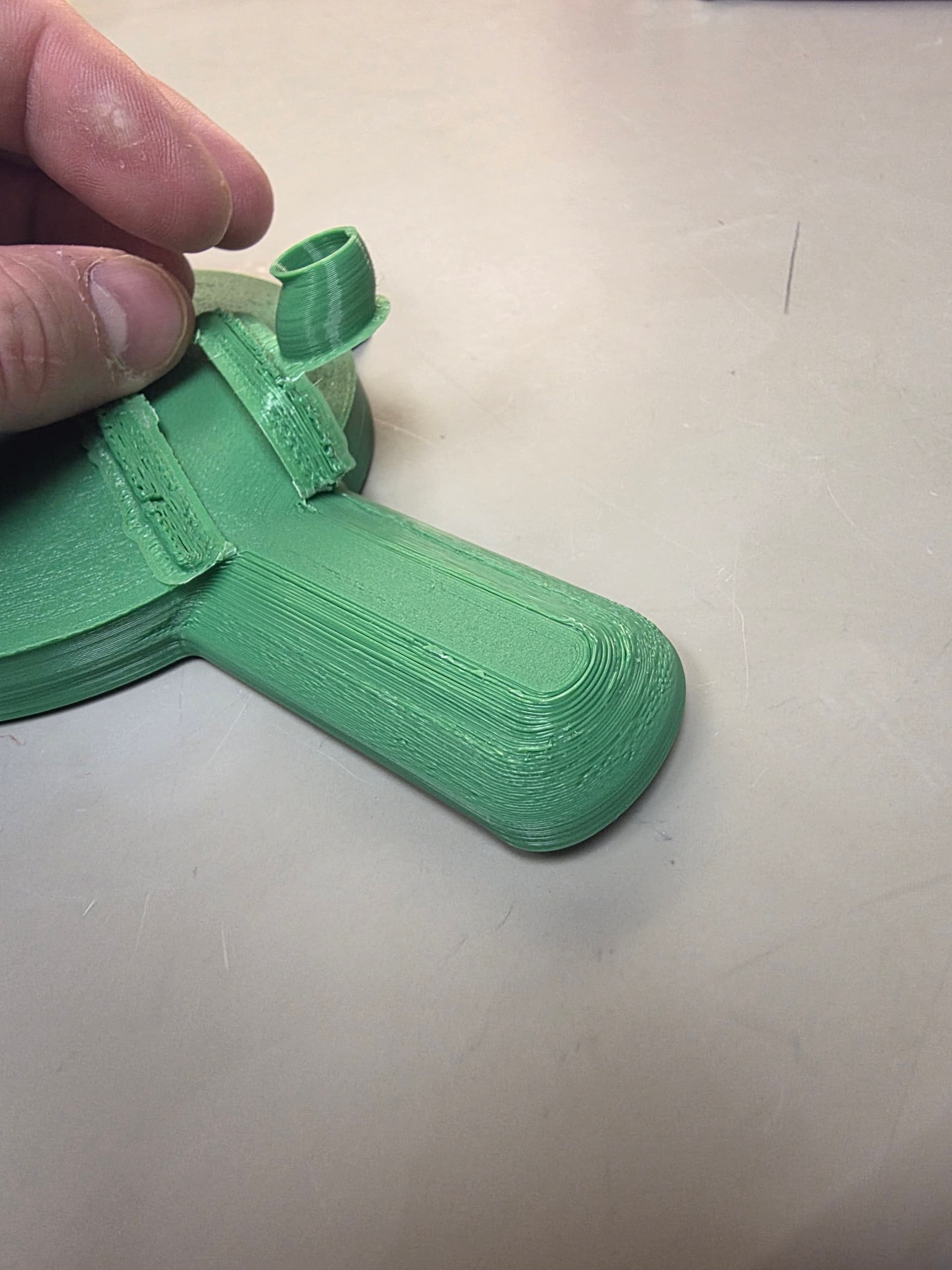

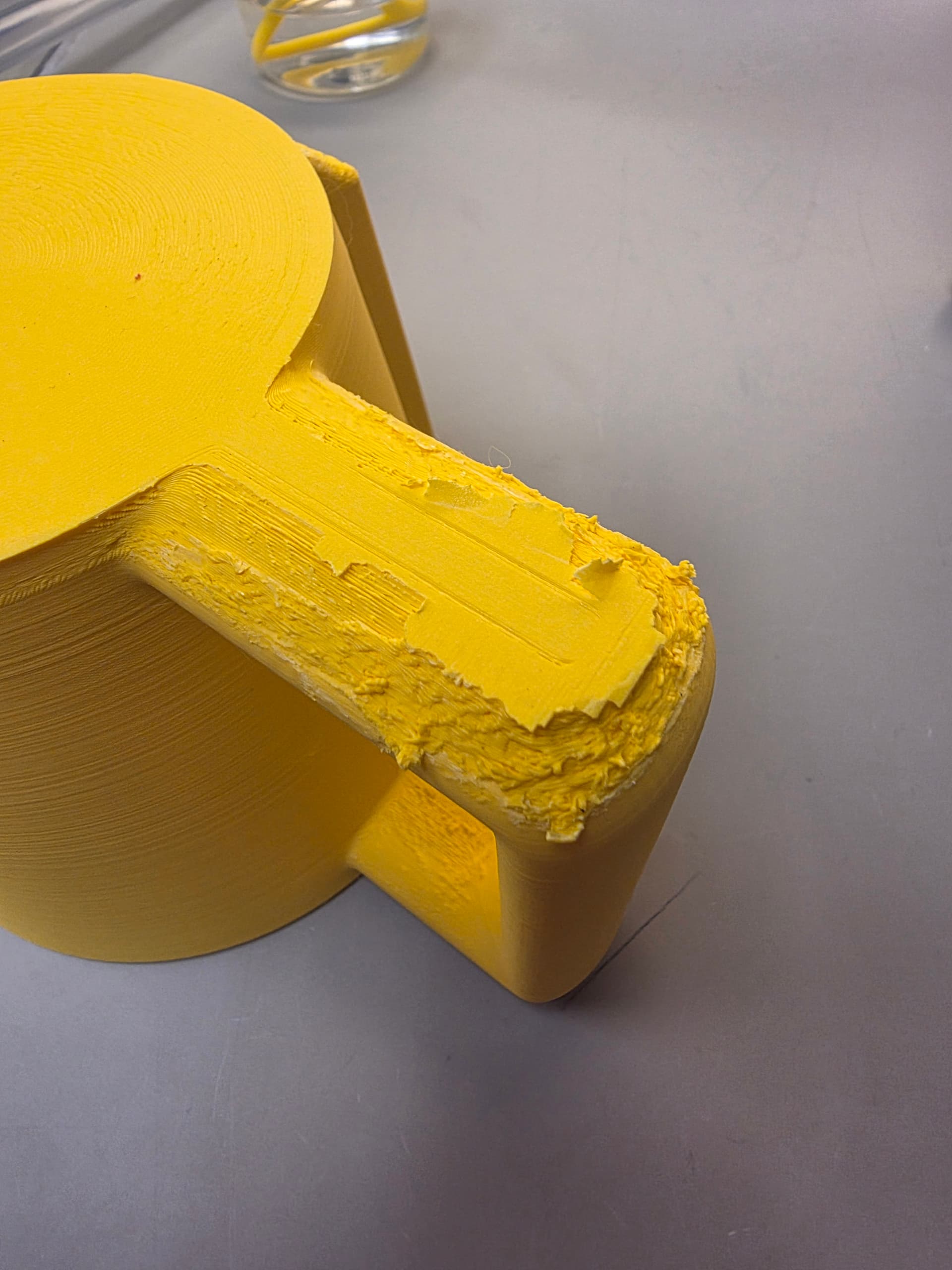

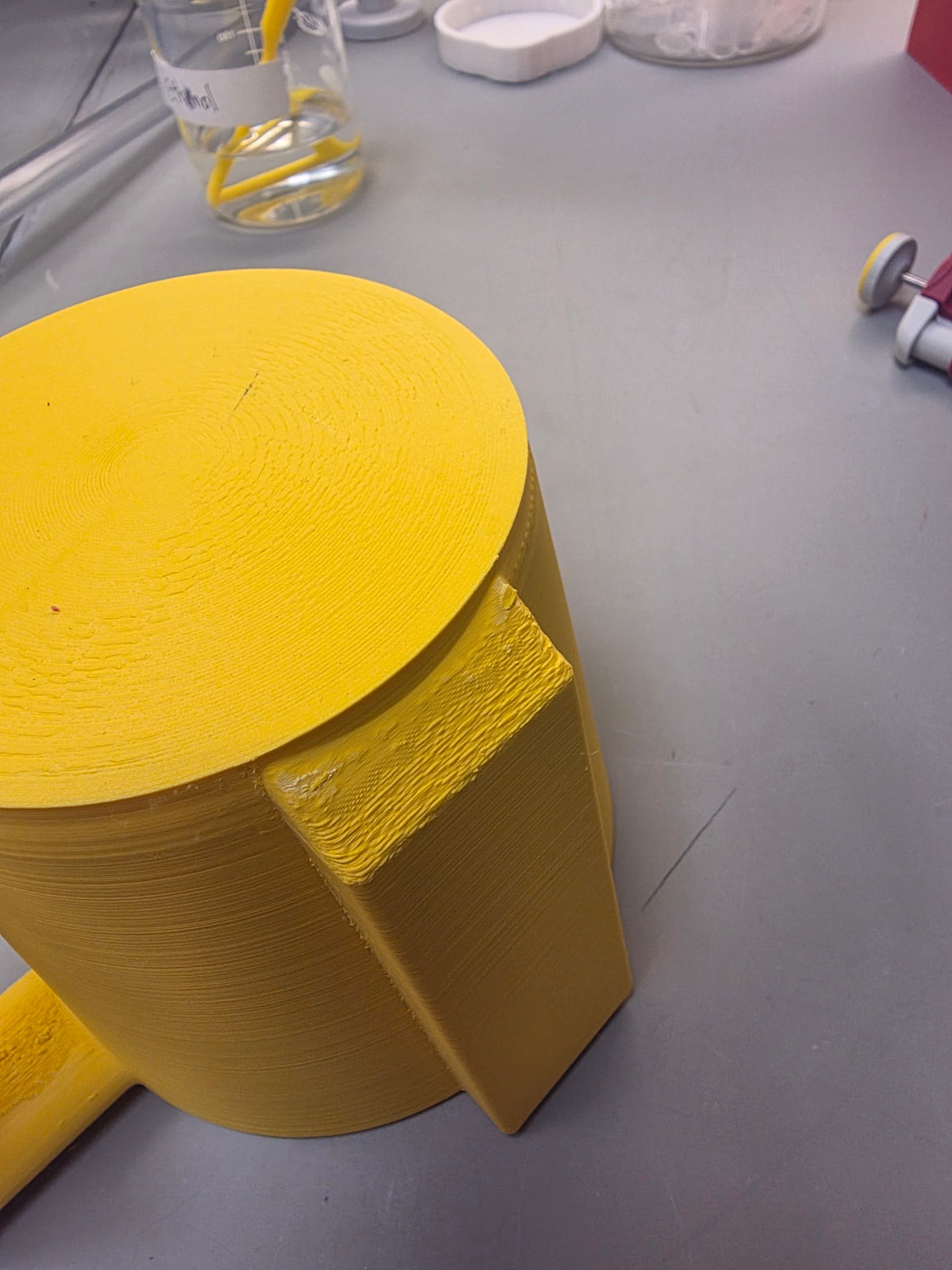

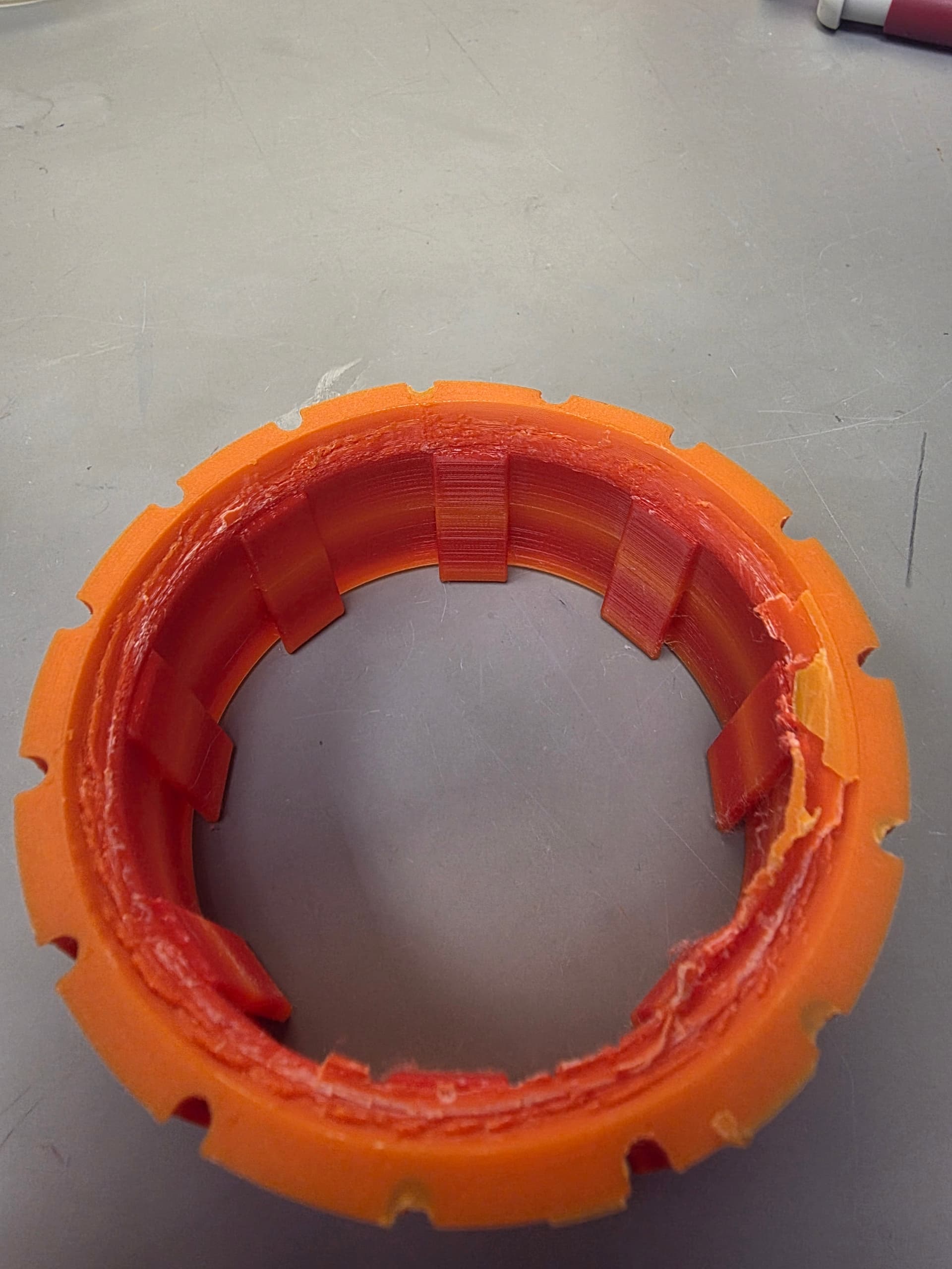

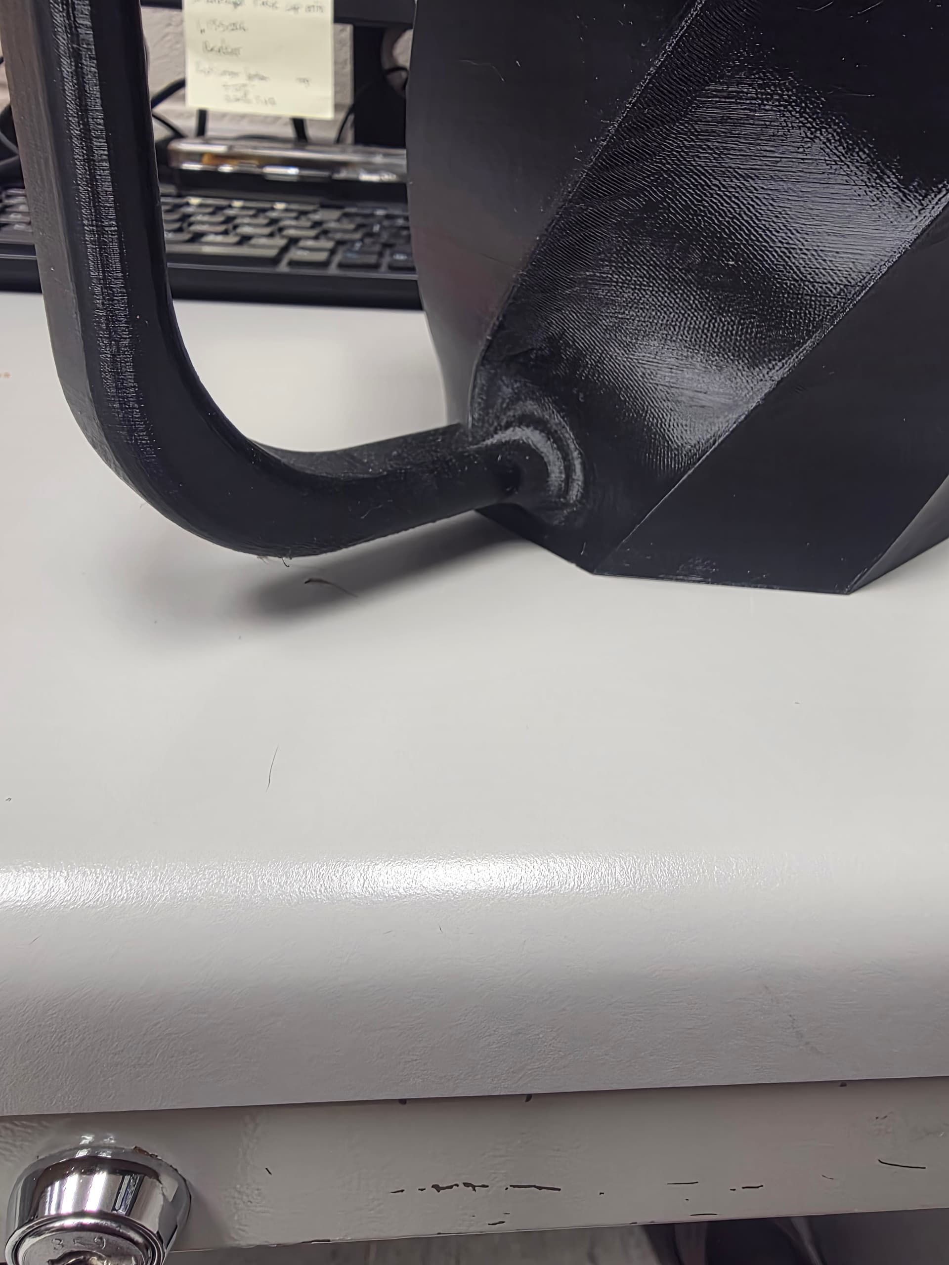

I have just recently run into some trouble with printing slants. It is a recent issue and I figure replacing the front of the print head or some changes to the setting would have done it. I made sure everything was working correctly, and I thought I changed all the setting back but I am still getting poor results. Can someone help me? The black and green item are how they used to print, and the orange and yellow is what I get now when I’m doing the handles. I have even printed some of the yellow mugs fine before and have one at home. I tried different filament, all different support settings, speed settings, and I don’t know what is going on!
This is extremely over extruded.
Is the filament off in diameter? Normally it’s not that extreme.
You need to calibrate the flow multiplier for each of these filaments.
Also the overhangs are not printing nicely. Can you try the latest Creality Print 7 and the stock profile for your printer there and just adjust the flow rate? It should have better settings for overhangs with the stock profile.
