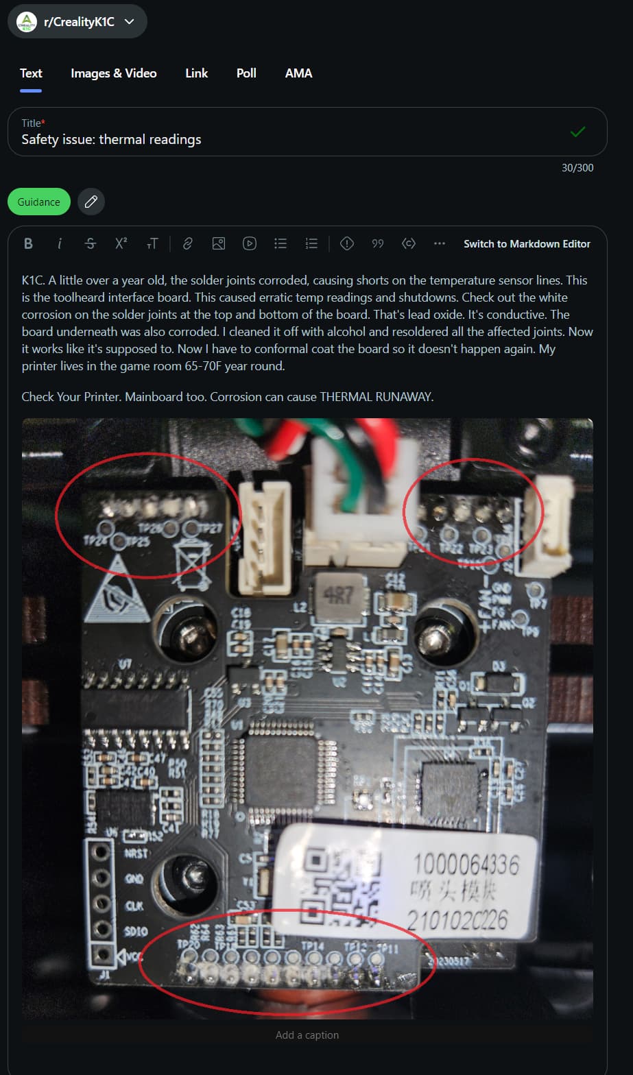

K Series safety issue: Corrosion
Flagship K Series
trouble-shooting
D_O1
August 5, 2025, 9:59pm
1
923×1568 148 KB
