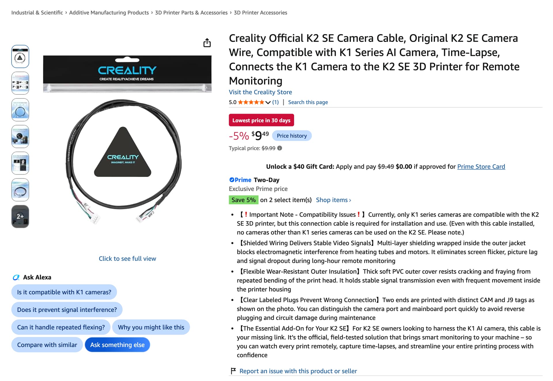

i have the K1, and the camera. .the camera stopped working so i purchased a new camera. the new camera still does not work, so it is my suspicion the cable must be bad. is this cable replaceable? i’ve seen a camera cable replacement on amazon/ebay, but im unsure if this is the cable to purchase to replace internally.

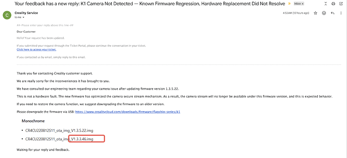

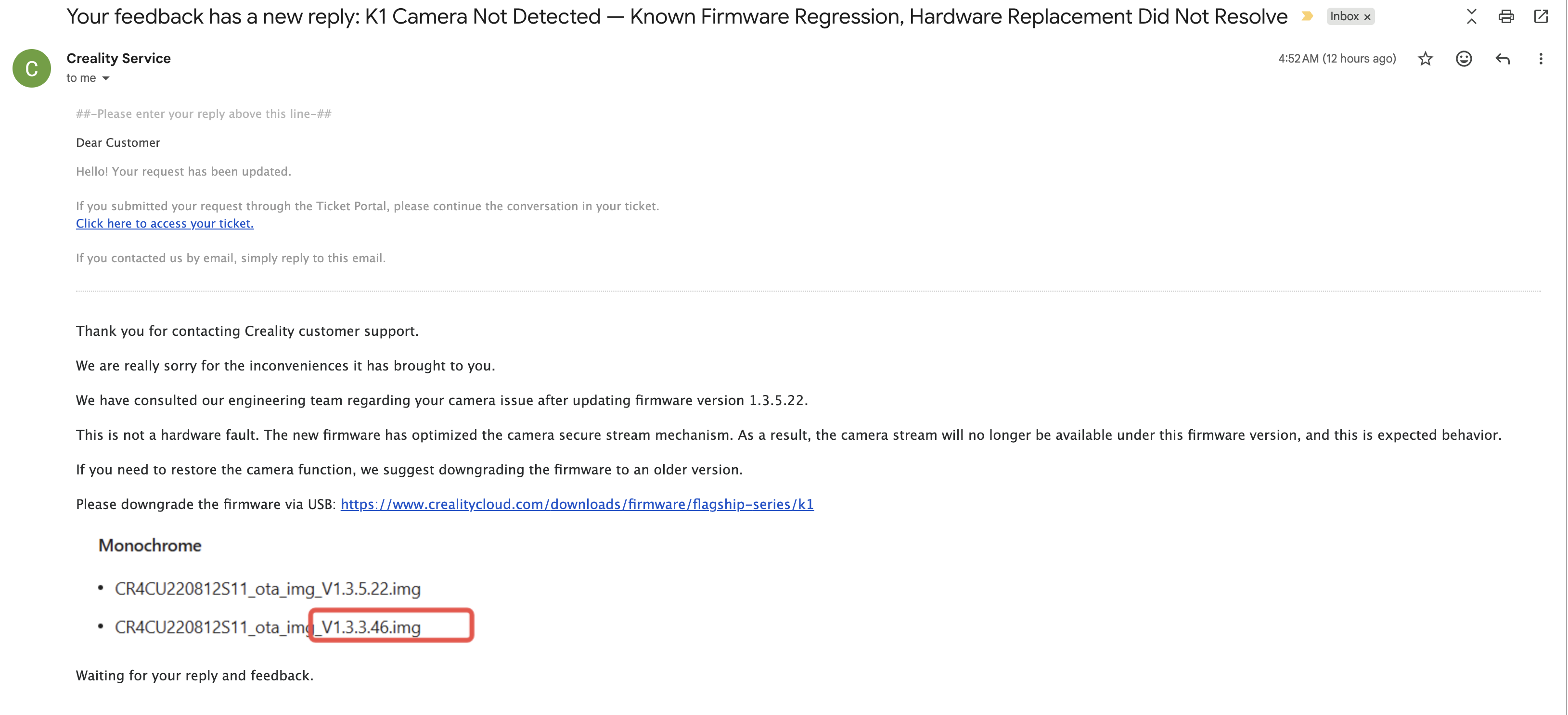

So this is crazy. After reaching out to Creality, they essentially told me that with the current firmware for the K1, camera stream is deprecated.
From the email:
hank you for contacting Creality customer support.
We are really sorry for the inconveniences it has brought to you.
We have consulted our engineering team regarding your camera issue after updating firmware version 1.3.5.22.
This is not a hardware fault. The new firmware has optimized the camera secure stream mechanism. As a result, the camera stream will no longer be available under this firmware version, and this is expected behavior.
If you need to restore the camera function, we suggest downgrading the firmware to an older version.
Please downgrade the firmware via USB: https://www.crealitycloud.com/downloads/firmware/flagship-series/k1
