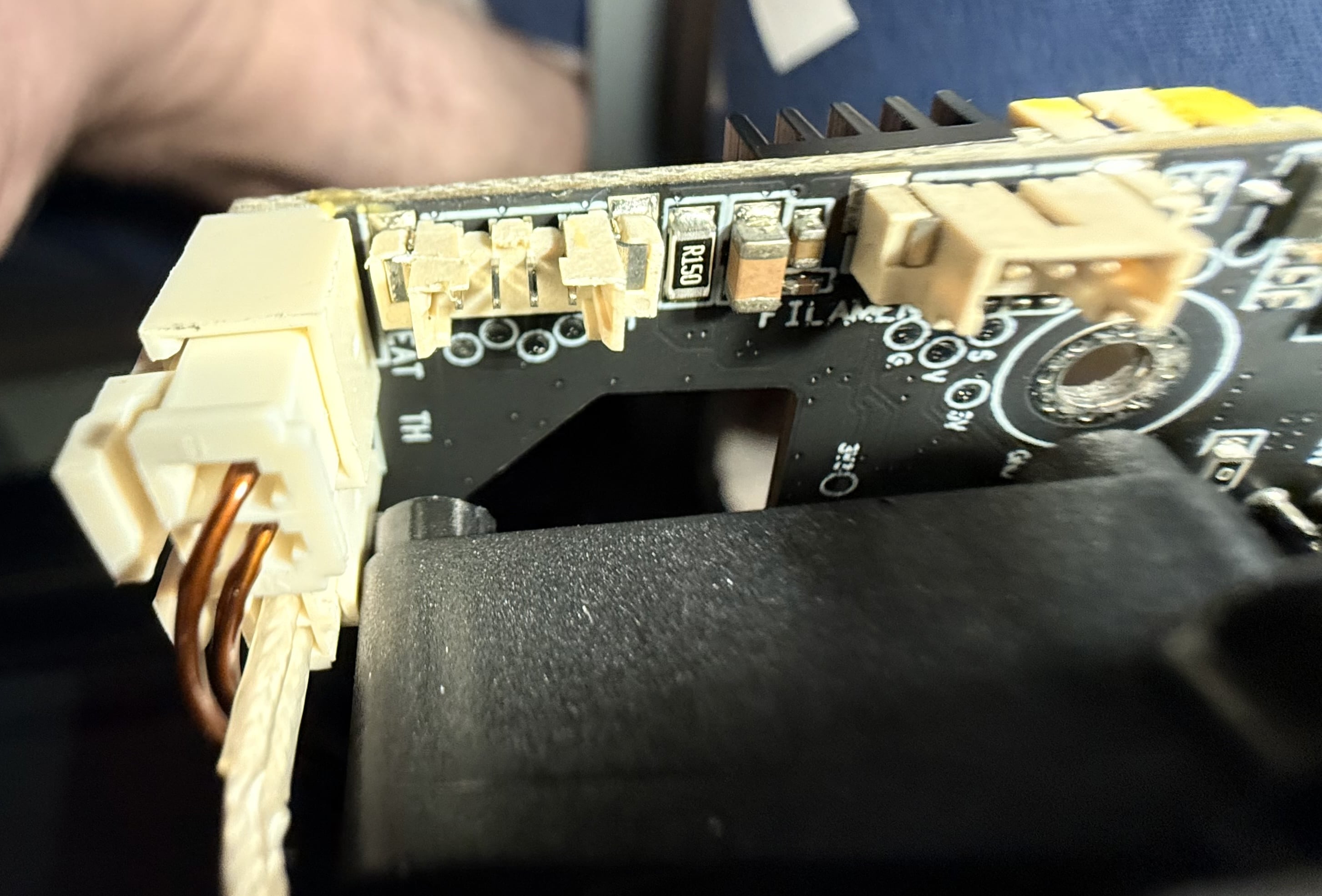

Running into the exact same issue, but on a K1C 2025 (the printer.cfg header shows k1c-x2600 as the model codename — seems to be a newer hardware revision than the ones discussed above).
Confirmed the DXC sensor is plugged into the correct dedicated connector on the toolhead PCB — it’s clearly labeled “FILAMENT” on the board silkscreen, with S / 5V / G pins (photo attached).
Tried nozzle_mcu:PA10 (the pin everyone above uses) — Klipper rejects it: pin PA10 is reserved for serial. So this board revision apparently reassigned that pin.
Tried nozzle_mcu:PB0 instead — Klipper accepts it fine (no errors), but QUERY_FILAMENT_SENSOR shows “filament not detected” regardless of whether filament is actually loaded, removed, or manually pushed further into the extruder.
Has anyone with this same 2025/X2600 board revision found the correct pin for the DXC sensor on nozzle_mcu? Happy to share my full printer.cfg if useful.
