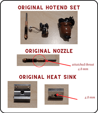

Hello, i had a problem with my hotend and i needed to change. However when a hotend that i bought is different from mine, and all of hotend that i found on internet that says compatible is the same of the hotend that i bought, i dont find anyone like the mine.
The hotend original is this:
With noozle and throat attatched and the external width of 4.8mm and the heat sink has 4.8mm on hole.

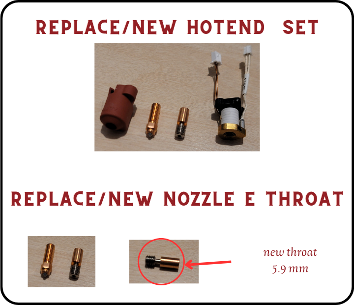

The New Hotend is this:
these have the noozle and de throat separated, and the external widht of throat is 5.9mm witch is larger than the heat sink hole.

My questions is:
  1. What is the correct hotend for Creality K1?
  2. If has difernt versions, there is a name/serial number for that?
  3. Shoul i change the heat sink too? if yes, what is the model/part number of it?
Your original hotend is the new ‘unicorn’ 1 piece nozzle. What you bought is the first hotend they used in the K Series printers. You need a 1 peice hotend replacement, like: https://s.click.aliexpress.com/e/_DEWMMUr (aff link)
Thank you, you helped me a lot, I’m going to buy the nozzle you recommended
