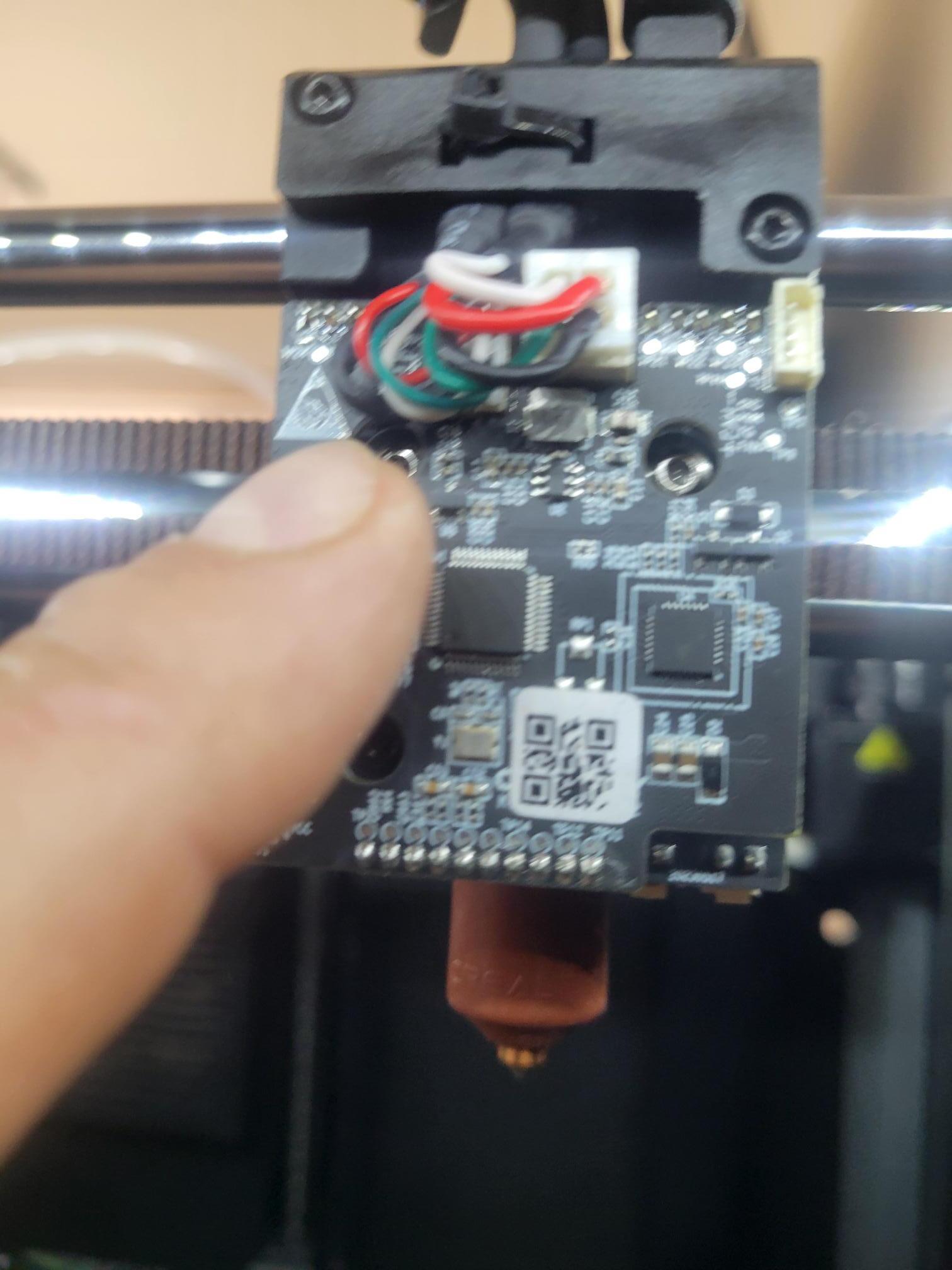

I have a K1 Max that i turned on the other day and was given a “2335 unknown exception” i have not been able to find much information, i have replace hotend and hotend board. still same looked at connections on mother board don’t see any issues. Any help would be greatly appreciated. so far creality is no help.
From what I’ve found on Discord, “you need to move the thermistor so it’s near the nozzle. That error is to do with it not detecting nozzle temperature.” (that fixed it for a few people) But a lot of people have had that issue with the CFS kit…
Thank You it is a whole new hotend and the hotend board, newer versions and same exact problem.
Bonjour, avez vous trouvé une solution? J’ai exactement le même problème aujourd’hui. J’ai un kit CFS
any updates on how to fix, just encountering this issue new hot end and no idea what to do next
Any reading on the hotend temperature? You replace the thermistor?
