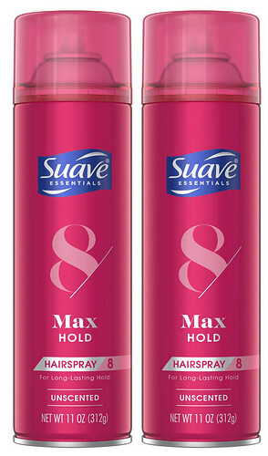

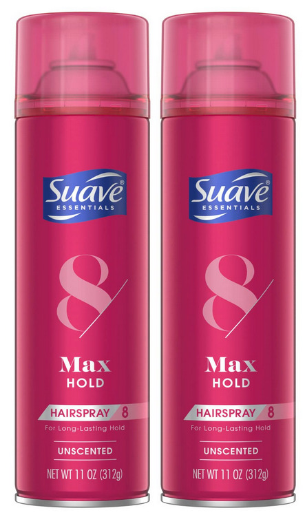

I have the K1C, I use cheap Sauve 8 unscented hairspray from Amazon for glue on the smooth plate. For the textured “B” plate I normally don’t use glue. If I don’t use some sort of glue on the smooth plate, I have a harder time releasing some models. I use Isopropyl 99% alcohol for cleaning when it looks like it needs it. The alcohol hasn’t affected either of the plates at all in the six months I’ve had the printer, probably 300-400 prints of various sizes.

Yep, I find the glue is more of a release agent than glue. Stuff sticks to the smooth plate better than I sometimes want, the hairspray allows me to get it off easier.
I like the hairspray simply because it’s so easy to apply, a few waves of the can and the plate is covered in seconds.
I don’t really have a sense for the exact number of prints before washing, I just eyeball it and wash when it seems like a good idea. Again, a paper towel with alcohol and in a few seconds I’m ready to go. I buy the 99% Isopropyl alcohol on Amazon by the gallon, it’s shipped in four quart bottles. It’s pretty cheap that way, and it lasts a long time, still have over half of what I bought and I’ve been printing up a storm for six months. :smiley:
A good wipe down with IPA before every print is good too, though if it is still hot it can be a bit overpowering. Tried hairspray but I think I got the wrong brand as it would release halfway through a print. We are also confusing over here, we buy beer in pints, petrol in gallons but IPA in litres.
This is the stuff I use, someone that had been using it for years turned me on to it. It’s worked pretty well for me.

Lol reminds me of the ultra hold stuff I bought in the 80’s, think it was called Cossack. Was great for when I was going through Glam Metal {Motley Crue/Poison} phase…oh to be 18 again.

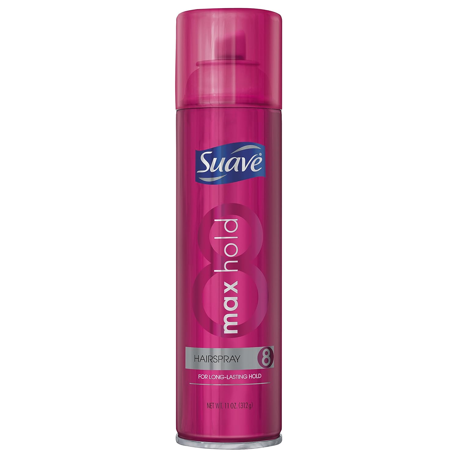

On your recommend I got a bottle of the non-aerosol version at the local Wally World quite cheap. Will test soon… :+1: :smiley:

I never saw the non-aerosol packaging. I like the spray because it’s fast and easy. :slight_smile:
11 oz. Bottle.
Yep, I looked and found that. I suppose that will do the same thing, just happened on the aerosol cans first. :slight_smile:
