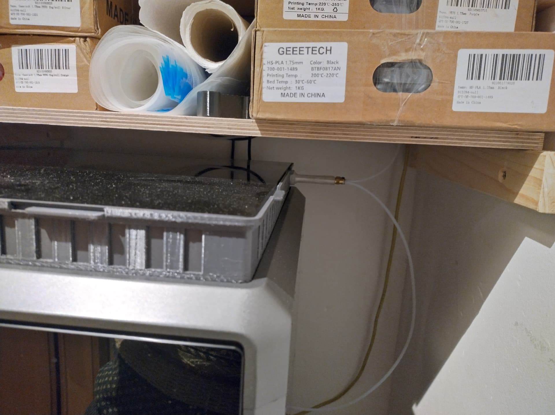

My K1max is from 2024 and needed some upgrades for the CFS: 1. Upgrade to K1 series ceramic heating block kit 2. CFS upgrade kit There are tutorials for the upgrade. Important: You need a riser to raise the top. I installed a Y-splitter for the filament in the riser so that the tube exits the printer horizontally. One part of the Y-splitter leads to the filament buffer, and the other part allows me to feed filament directly (spool).
