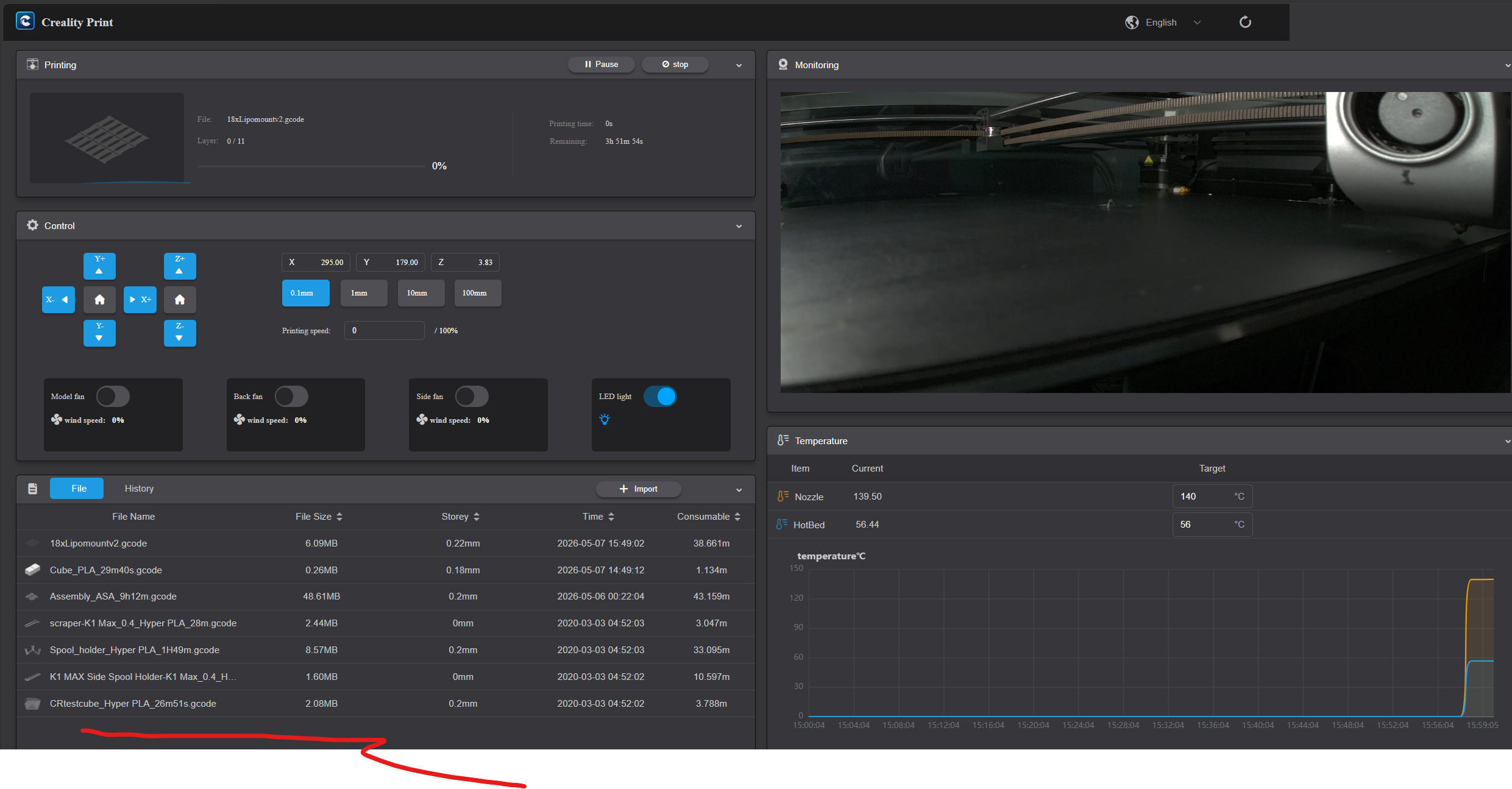

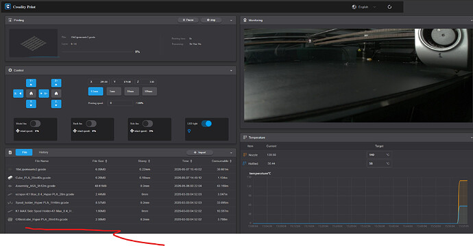

K1 Max, camera works but uploaded files are not visible and remote print cannot start in OrcaSlicer
After recent firmware updates, my K1 Max connects to OrcaSlicer over LAN and the camera stream works, but uploaded files do not appear and I cannot start prints remotely.
The same behavior appears when I open the printer by IP in a browser. So the printer is reachable, but file management and print start are broken.
Please confirm whether this is a known firmware issue or a current limitation. If others have the same issue, please report your firmware version.

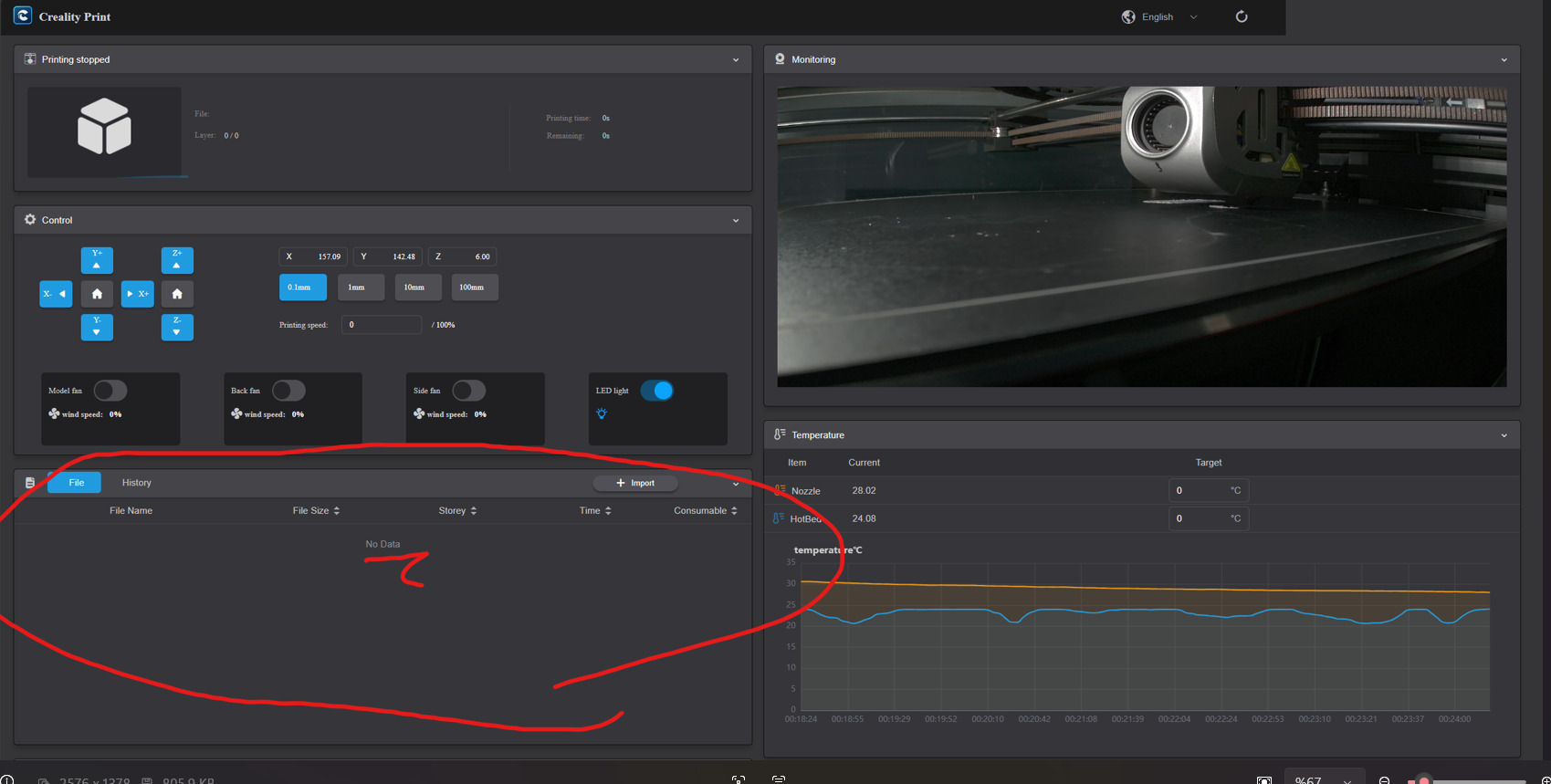

Just got my printer going after having to mothball it for 6 months due to construction. It asked for an update when it powered on. Now I’m having the same problem as Craycle. Web GUI, Creality Slicer or Orca. Doesn’t matter. No Remote File management is available. My Print History, however, is available.
Same issue here. Clearly related to an update. I just unboxed a printer I ordered back in November and I set it up with Orcaslicer and ran 2 prints without issue. I did not think to write down the old firmware version unfortunately.
I was then prompted by the printer to do an update and accepted it (version 1.3.5.19). After the update I opened Orcaslicer to send some new files over and found that the file list will no longer populate, but controls and monitoring still works. Unrelated, but the old UI on the touchscreen was blue, the UI on this new update is green.

Quick update, issue resolved on my side.
The rollback procedure provided by Creality Support worked correctly.
I successfully rolled both of my K1 Max printers back to:
CR4CU220812S11_ota_img_V1.3.3.46.img
The problems were present on all firmware versions released after V1.3.3.46, including the newer green UI / CFS firmware versions.
After returning to V1.3.3.46, all issues disappeared.
OrcaSlicer remote printing works correctly again, uploaded files are visible again from the browser interface, and remote printer management is working normally.
For my setup, V1.3.3.46 is currently the last fully stable firmware version before the green UI / CFS firmware generation.
I do not use CFS, so this may help other standard single-filament K1 Max users experiencing similar issues.
Important note:
The rollback could not be done with the normal public firmware files alone. Creality Support provided a special rollback firmware package and a specific recovery procedure.
If you have the same issue, I strongly recommend contacting Creality Support cs@creality.com directly and following their official rollback instructions carefully instead of trying random downgrade methods.
