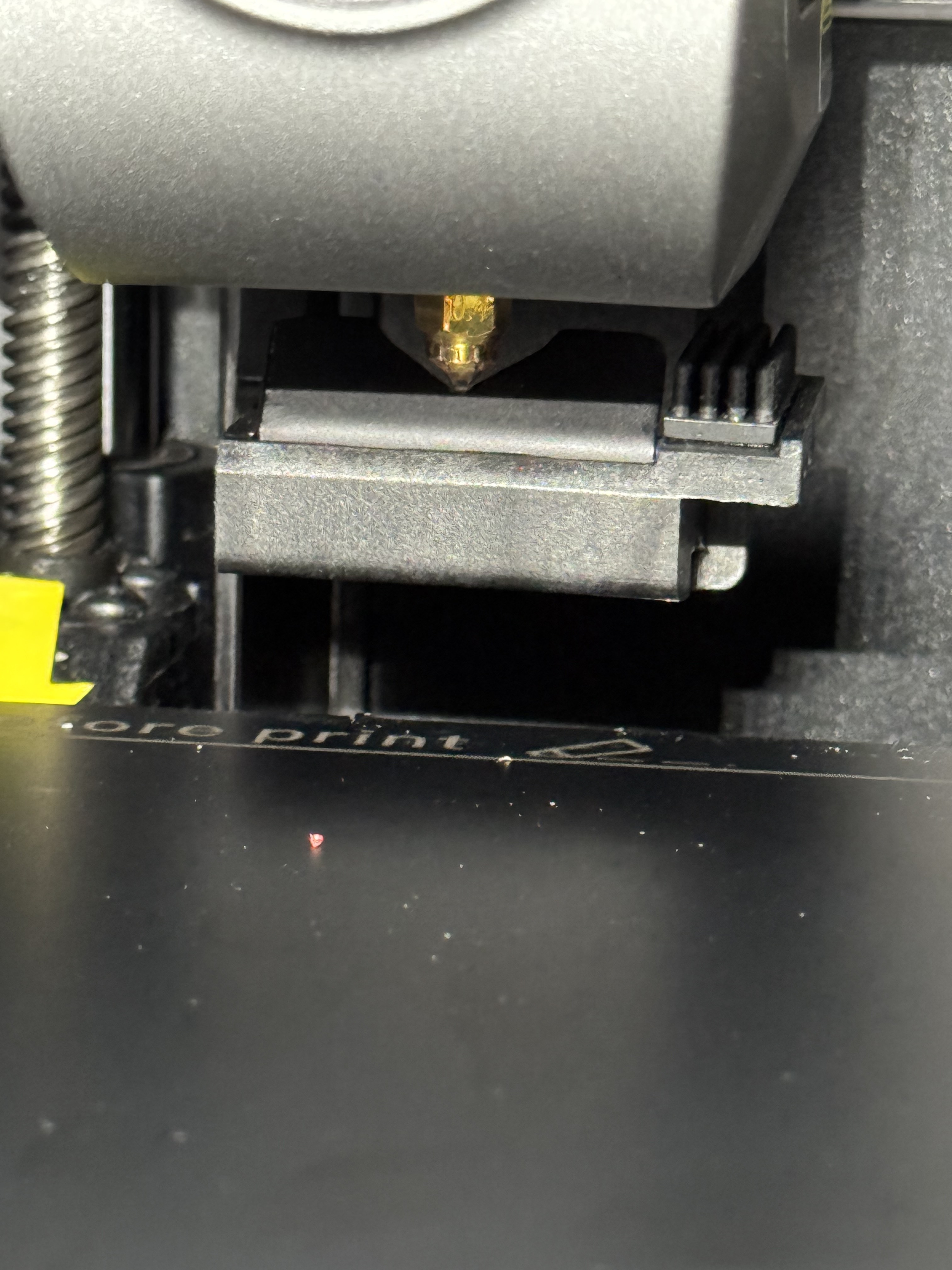

I have a K1 Max I just installed CFS upgrade kit. I’m having a problem with the purge chute. I go to purge coordinates settings to set it the nozzle is catching the chute a little it gets hung up when you try to bring it back out. How do I fix this?
It barely hits the nozzle when it goes back but gets hung up when it try’s to go forward. I have the chute tightened all the way and it’s seated in good. I got the K1 Max December of 2023 so I installed the new hotend for the CFS upgrade kit. I wonder if other people have had this problem on the older K1 Max. I wouldn’t think there be a difference between the older K1 Max and the newer K1 Max for the CFS upgrade kit to fit differently.
I am having the same problem . I emailed creality support waiting to hear back from them. quick question does your hopper sit down into the mount block on the lead screw. from the videos I watched it look like it goes down into the mount block when you tighten it. but mine does not. Hope we can figure it out. mine was bought in April 2024.
