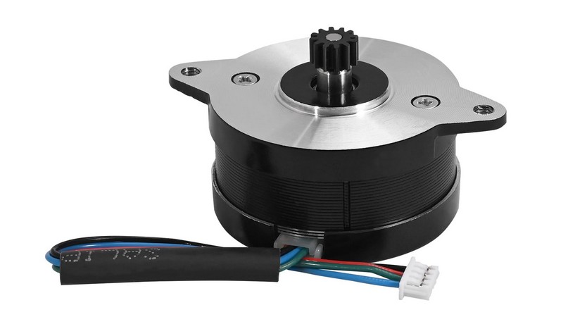

I had the same issue, 1 broken orange wire and I was not aware what the cause was. Frome the K1(C)/Max facebook group I was informed 2 weeks ago and now I read the same problem overhere. Replaced the steppermotor with a clone which has a suitable connector (see picture below) at the motor chassis and after swapping the motor with the new one I checked manually and visually what happens when the rear side of the motor bangs against the inner rear side of the printer via the attached extrusion/retraction mechanism. So far it seems to be ok now but it is definitely an upgrade kit design flaw, Currently I am searching for a spare CFS extruder replacement which is hard to find in Europe. I had email contact with Creality support in China but they are constantly referring in buying the CFS upgrade kit which I obviously already have and installed. I contacted today the Creality EU store with the question when they will sell the CFS extruder stand-alone, hopefully I will get an anser soon. At least the Australian webshop sells it likewise also Amazon in the US but ordering a spare extruder in other continents doubles the price regarding transport and customs import duties & tax….
