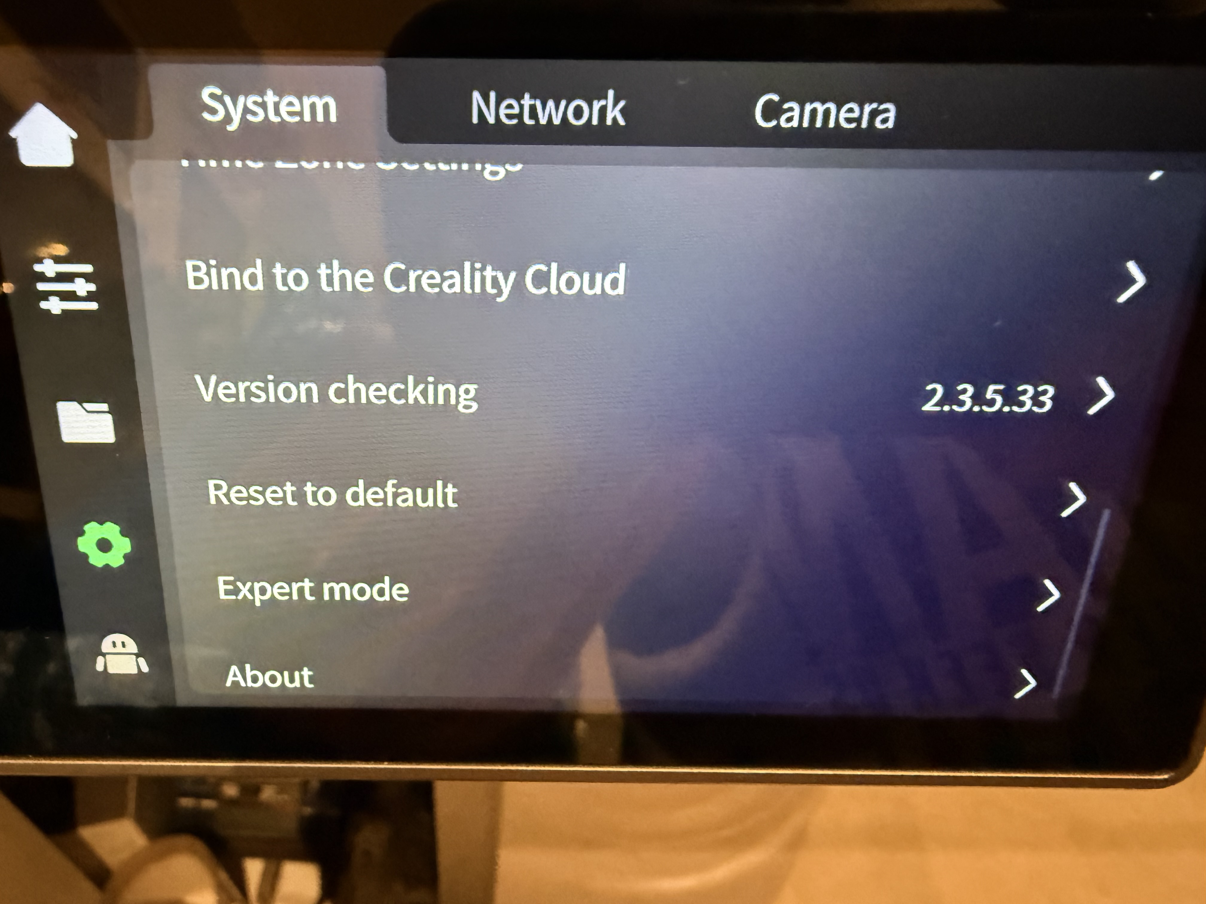

K1 Max dim printer screen after CFS firmware upgrade
I used the network connection to let the printer update itself - now firmware version is showing as 2.3.5.33

Toggled the screen time out and seems to have solved the issue for me too. Kinda points to a backward incompatibility in how the settings are stored between the older firmware and the CFS firmware. Resetting to factory default would indicate this also.
Fix with changing from 3, to 5, to 3 min

I do know that it has been reported that 2.3.5.34 has corrected this issue.
So where do you find 2.3.5.34 version? No versions are on the website since December 2024, and doing a version check from the printer says 2.3.5.33 is the current/most recent version.
You have to contact customer service via their web site and chat with service. A word of warning from my experience I installed 2.3.5.34 and found that the Z offset was terrible and no matter what I did I couldn’t change it to resolve the over squish (resulted in really bad first layer results). I tried in the slicer (updated to the beta Linux slicer, modified the start print macro, nothing worked). I ended up reverting back to 2.3.5.33 which gives good first layer results, I’ll just put up with the display issue until they release a “good” firmware.

I experience this as well, unlike some of the suggestions here, it happens regardless of what time you set it to, I noticed that it reproduces after you finish a print, then start another print without clearing the print finished message on the screen itself.
