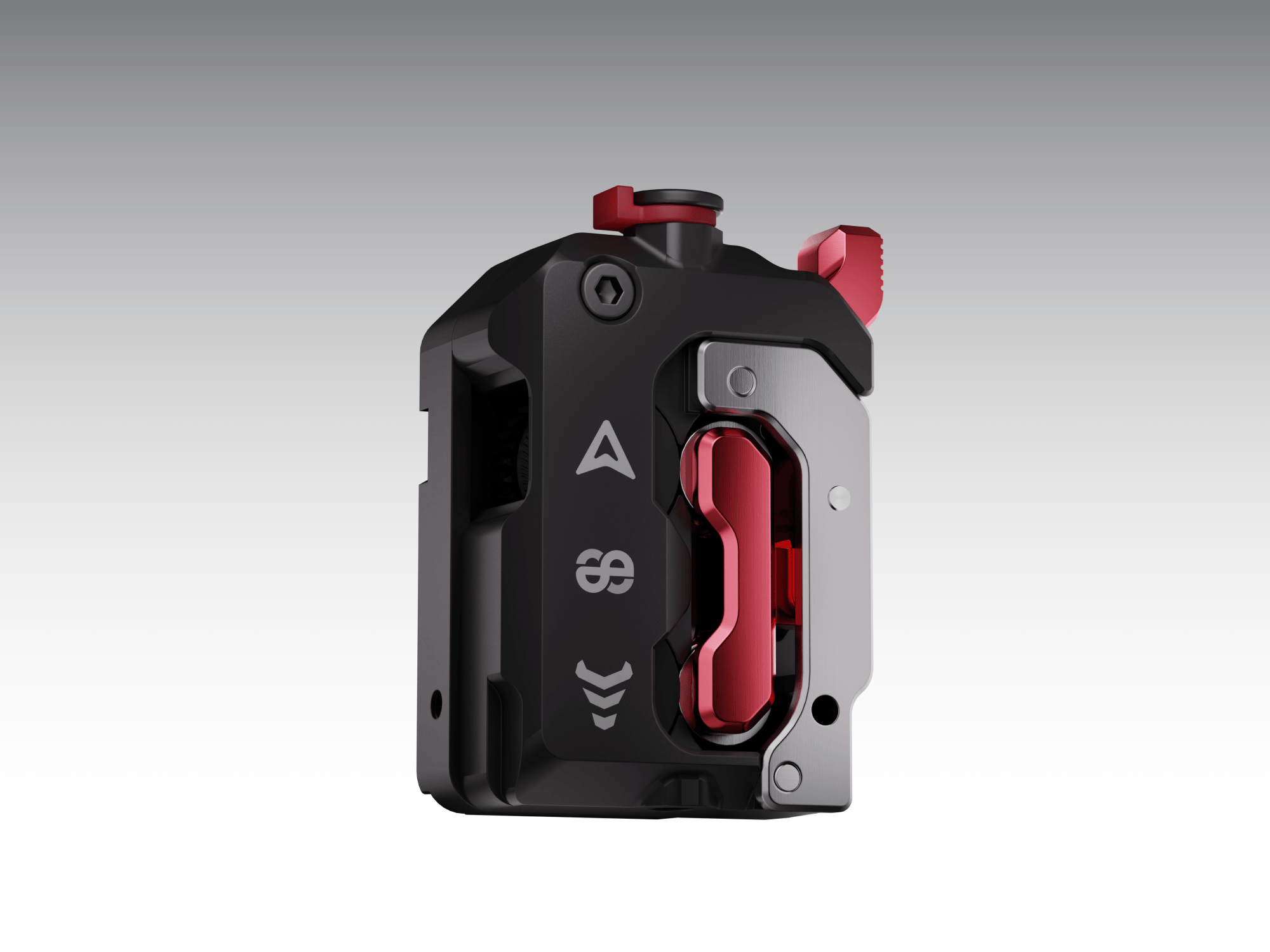

I had better luck with toolhead filament sensor and removing the stock sided mounted ones, the dxc extruder some with toolhead sensor.
I saw that extruder and it seems to be a good replacement.
DXC Extruder

I think you will need top hat (or no top hat), as this vendor mention it. Also not compatible with cfs upgrade as no cutter, pheatus website seem to lack this information their product page.

DXC is a good option for upgrading from stock extruder. I got better print results with TPU.
The filament runs out sensor is closer to the extruder. It is a better design than the stock one.
