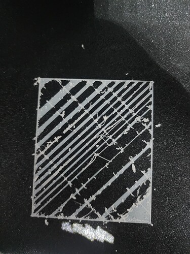

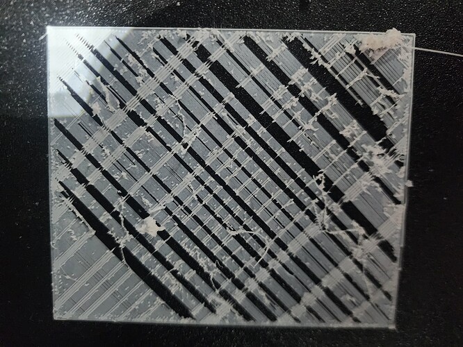

-.04 z axis
-.04 z axis
I’ve adjusted the z axis from .05 to -.1
I can’t get a first layer to work. Plate is clean, new filament. Any thoughts?
-.04 z axis
-.04 z axis
Hello @Joseph_Holbrook ![]()
Basic stuff to check:
1.) Even new filament might need to be dried. Try another roll if you have one..
2.) Do a filament extrude and watch how the filament comes out of the nozzle. See if it comes out smooth and in one piece. If not it could also be a partially clogged nozzle…
3.) Also how did you clean the build plate..?
Ok, I did it for both printers. Oddly enough, despite the prints almost looking identical where the filmanent didn’t stick… these are two different printers. I’ll try another STL file and see… I’ll keep you posted. Thanks for the advise.
