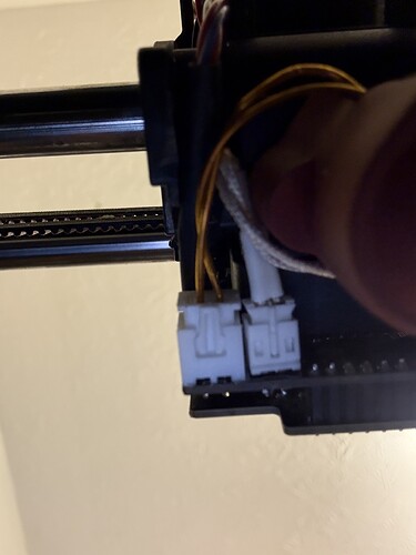

K1 max hot end won't wires won't plug into the motherboard

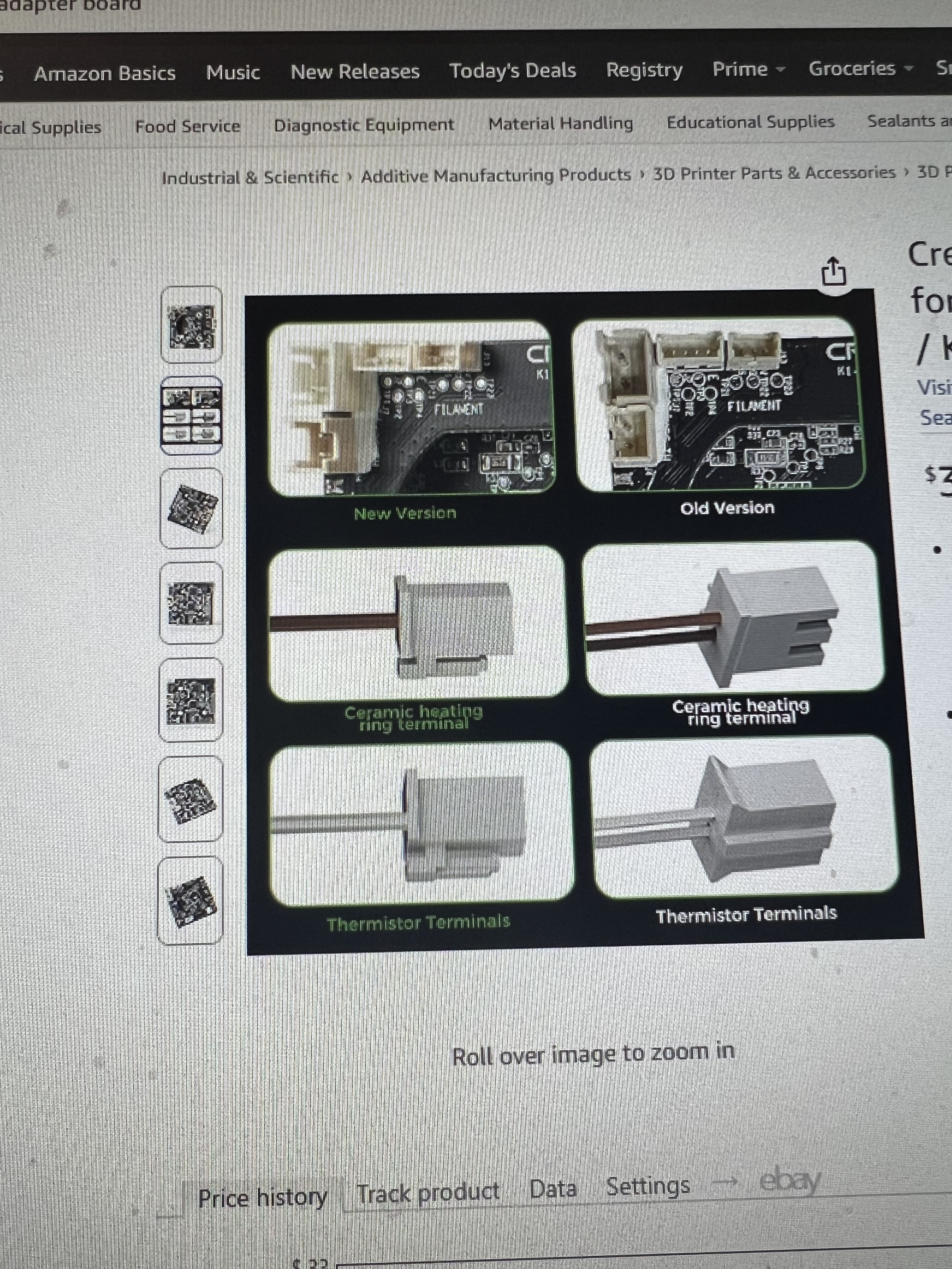

I was printing , and when I came back hours later, the filament had globed around the hot Inn. I heated it up and pulled it off, i snapped a wire in half from the motherboard to the hot end so I took it apart through the hotend away and bot a, new one. Everything looked fine on the motherboard. Nothing was damaged, got a new hot end, from amazon and it is crayality it says it’s for the K1 Max, but it definitely won’t plug into the motherboard. The ends are definitely different

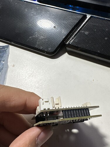

Hello! I am running to the exact issue you are having right now. I tried contacting support and they keep offering to send me a new hot end that I know won’t fit. I kept trying to tell them I need a new hot end with the clips at the end and I even sent them this picture but they still do not understand. Did you manage to find a replacement hot end?
Hey, so I actually had this problem about a month ago too (woke up one morning and found a tumor that f** up my board and hotend) and just now was able to fix it.
TLDR, I had to solder in new connections.
Customer service was no help at all. So I checked my closest microcenter, scoured every single fourm and chat GPTed everything.

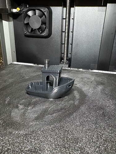

At the end, I bought like 5 boards from aliexpress and the connectors from amazon along with flux, solder, etc to unsolder the old connectors and put in new ones. Eventually after 2 tries (popped a capacitor on the first one and burned one out trying to desolder) I got the 3rd board to actually work. I did get an error 111 (something wrong with connection to board error) so i checked the solder joints for any bridging (when 2 solder joints connect or something like that) then checked for any loose connections. After that I was golden and printed the default benchy that came with the printer after the fix.
Links for parts down below.
The pcba boards on aliexpress

The 2 main connectors (took me a looonnnggg time to ID them.
JST-XH 2.54mm 1S 2 Pin
JST-PH 2.0 2 prong
Where I got the jst-ph 2 prong female connector out of
Another thing, don’t let the images in ali express fool you. The actual female connectors won’t fit the current hotends.
I have run into this issue with my K1 with the new motherboard not having the same connectors that my hotend does. I will give what @sai_syhavong suggested. Thank you for your sacrifice good sir.
