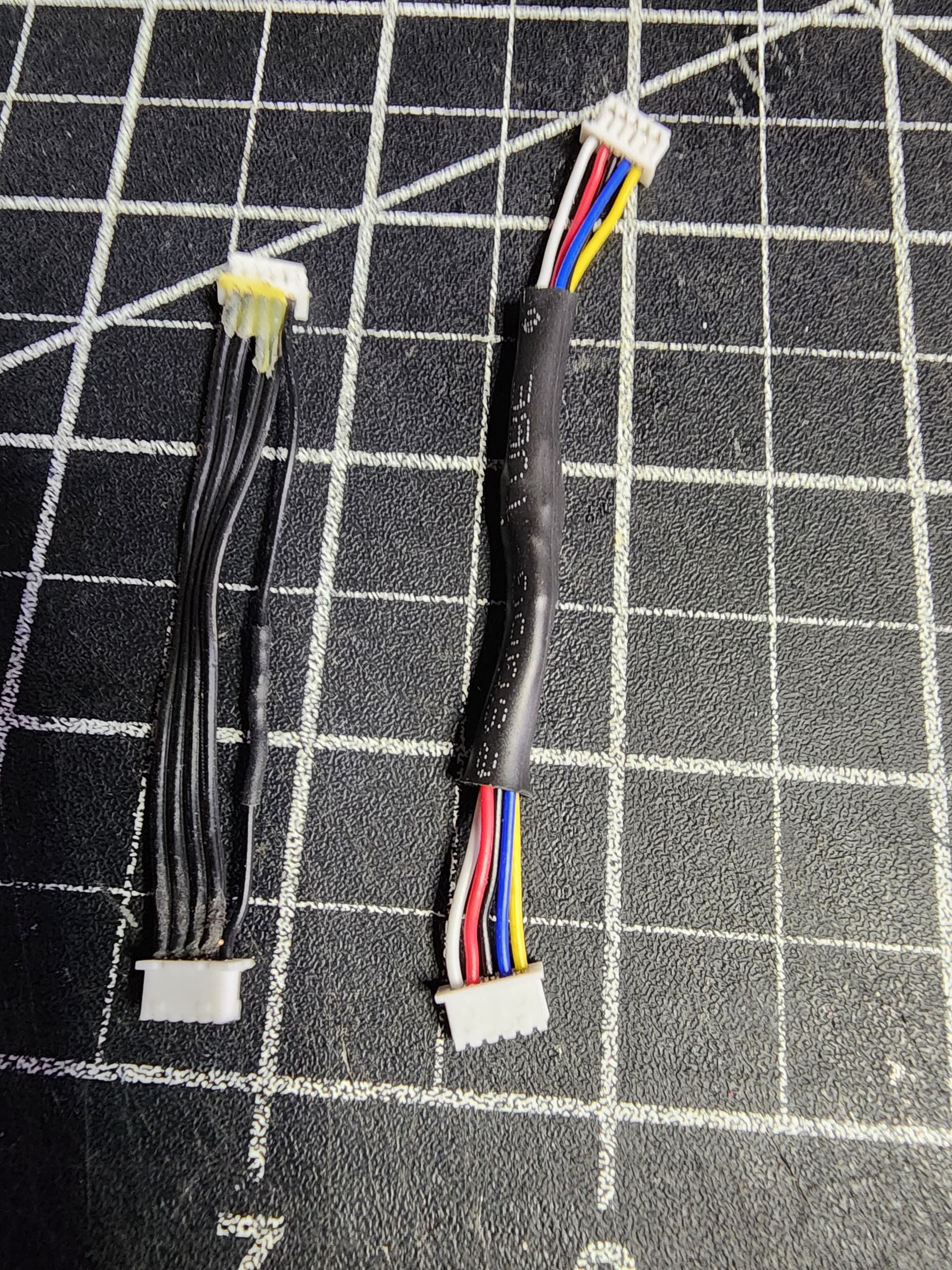

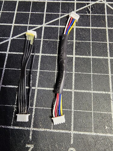

Incorrect, not 1mm Pitch, it’s 1.25 MM pitch
Just replaced mine and fixed the original cable to keep for an emergency spare.
You are looking for JST MX 1.25 mm Connectors 28AWG Cable.
The kit is the best. You can cut the wires and solder them to make any length you want.
Also, repair your original cable.
The link to them on Amazon.
I managed to make one with cable and connectors from aliexpress. Don’t make it too long and take your time. Hopefully they will sell them on Aliexpress one day
