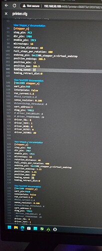

I have installed the bootycall jones linear rail gantry and some LDO 42STH48-2504MAC motors. Im getting stepper X and stepper Y overheat warnings in klipper whilst the printer is just holding the motors and doing bed levelling.
These are my current settings in my congig
did you ever figure this out? Im getting overheating stepper warnings from klipper too.
The run current seem bit high, otherwise you need some cooling on the motor.
