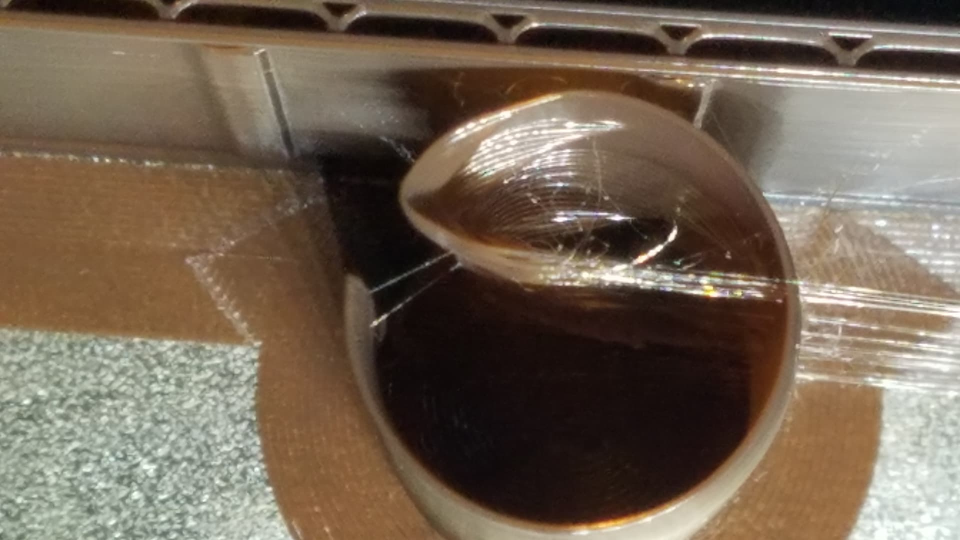

Hello, I was printing an upside down basket, with medium autogenerated tree supports. It was a 21 hour long print. The part itself is printing fine, but the tree supports are all messed up. First they are not sticking to the bed even after applying lots of glue, and then they are stringing, maybe because the base of the supports is moving when the extruder moves over them . Please help with any suggestions. Thanks !
This is the bottom view

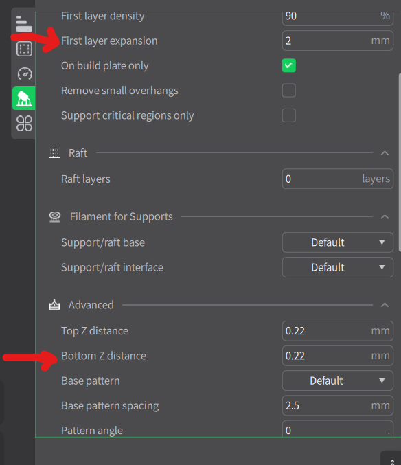

If the print is sticking ok, then its probably in your support settings, check these:

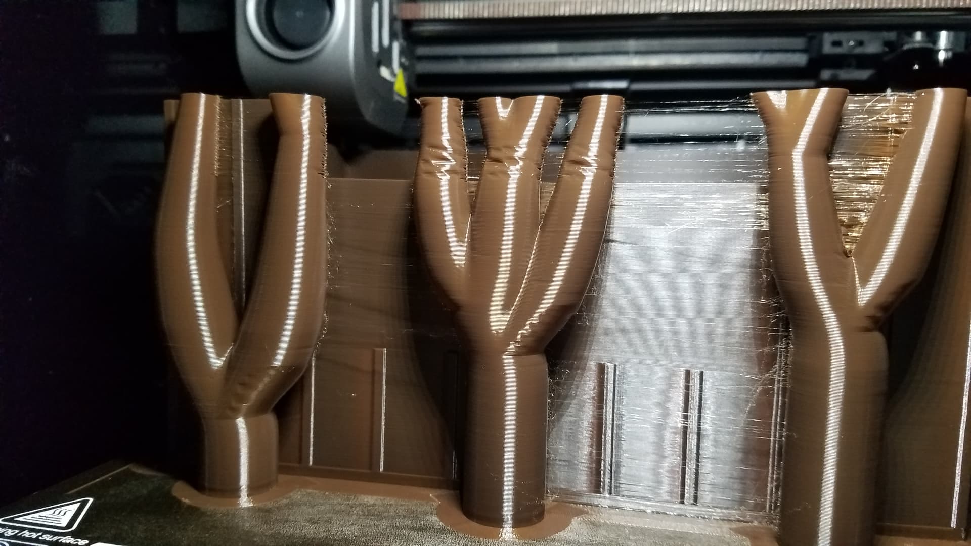

mine sticks fine on my K1C but I sometimes get his
weird :clown_face:
