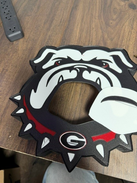

K1 Max with CFS different colors not welding together
So I have a K1 Max with CFS. I am trying to print a LED sign. Prints just fine looks great but when i take it off the plate I find the colors are not welded together. I dont know what setting to adjust to correct it. Anybody know what I could do?
Hello @SASH3D :wave:
The first thing I would look at is what type of filament you are using… PETG doesn’t really stick to PLA.
Thanks alot of good info here. so Its all pla just different colors I can barley push on the white and it cleanly pulls off. Im trying to add a photo but it doesnt give me the option.
There got it to attach.
Are the colors from the same brand?
I’ve seen similar issues when using different PLA brands or colors. Even with PLA, temperature and cooling settings can affect how well the layers bond.
Yes they are the same brand. Ive tried to print it at different temps hoping hotter would make the colors fuse together but not luck. So the file is a .3mf created with Bambu Studio. So i run it through that and it printed fine well not fine Bambu Studio swapped the colors around and what was supposed to be white printed red but that’s another issue. So a setting is not translating between softwares. Creality slicer and Orca slicer both print with it detached they display a error when importing the model
