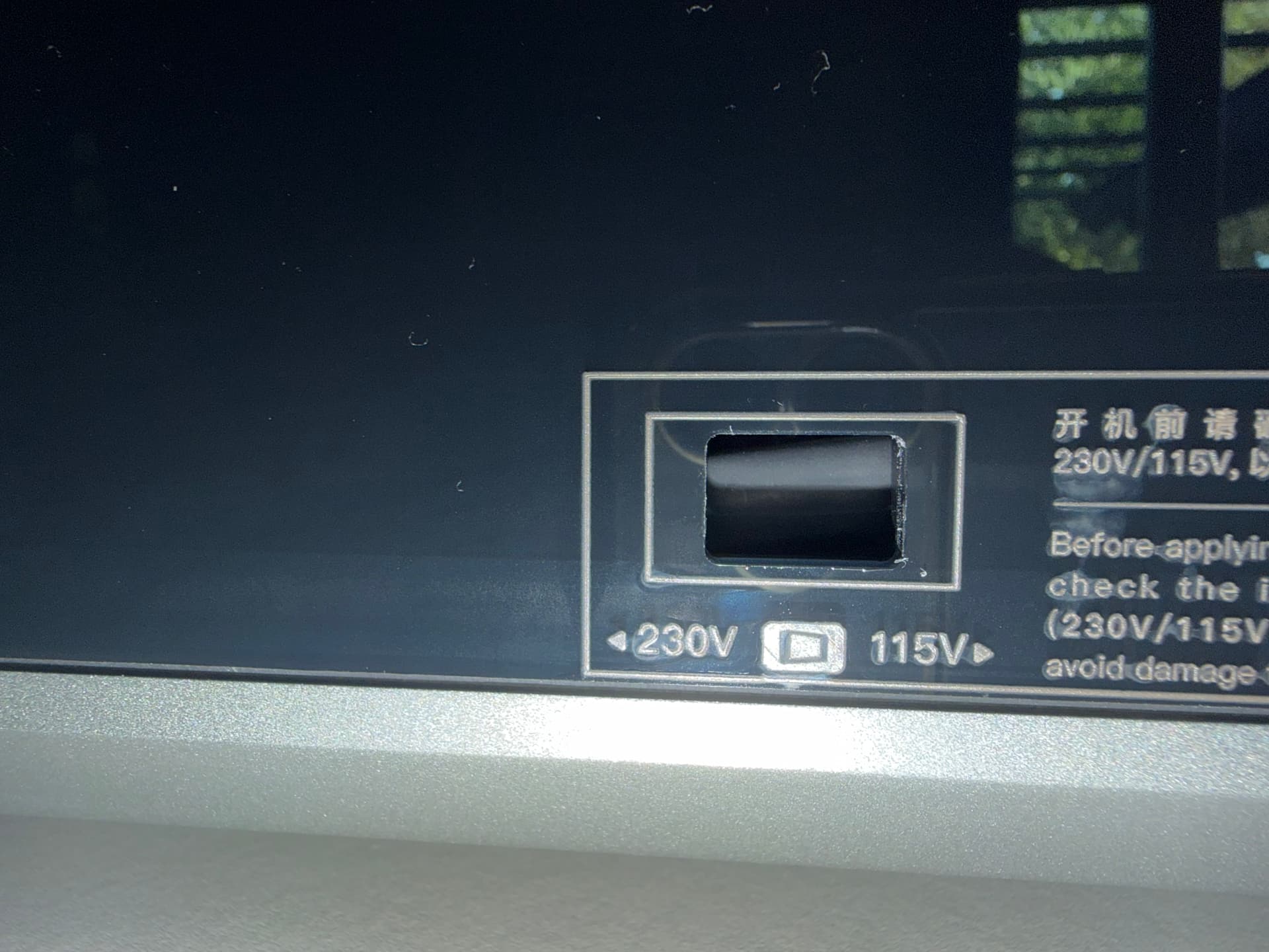

I’ve just unboxed my printer and I’ve read the instructions about making sure the power switch is selected to the correct voltage. I live in the UK, so it should be set to 220V, the issue I have is that there is now switch and just an empty hole.
Any help would be appreciated as it’s mainly my daughters birthday present for today
They may use a different power supply for the EU market. They have higher standards regarding consumer electronics which would require a higher end power supply (RSP VRs LRS ). Those power supply’s have automatic voltage regulation and do not require a selector switch.
