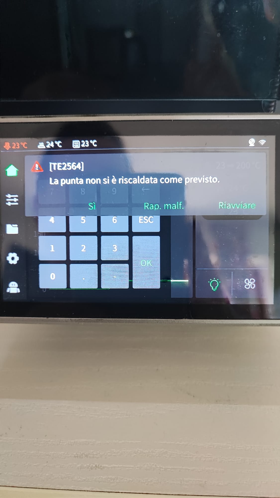

K1c 2025 two error today and not working
Hello

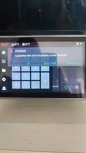

Today my k1c 2025 after 1 month of usage , it stopped working, with two errors, after a normal start-up
TE2564 (temperature of hotend low) and after this a CL5003 “auto leveling failure“
what happen ? All wiring seems ok, but I don’t want to disassemble anything due to warranty
i open a tickt, but Creality support are very slow to reply
Is there a chance it will work again, how does creality support work?

Thank @For_Ward , the problem is that the temperature doesn’t move from 20 degrees (celsius), as soon as I ask it to go up it goes into error.
as I was asked by the official creality support, to check all the cables if they were in place, but error persist
I think the hotend is broken, is it possible after just a month of use?
Is the hot end heating? If the temperature is indicating 20c then the temperature sensor is working OK normally if the sensor is faulty the reading would be 0 or maximum not 20. I would remove the cover on the hot end and check the heater connection on the circuit board. if OK then you may have a faulty heater cartridge. If this is so, replace the heater and nozzle block.
Bill
@Bill.b , no the sensor i think work well, the 20 celsisus is the hotend temperature, same of the ambient, this because hotend temperature wont up, with the error in screenshot.
But Creality support hesitates with questions if the cables are all connected……..

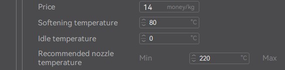

In the GUI, there is a section that states the filament settings.
This may help you.

Today Creality reply to my ticket with a new nozzle kit and hotend to replace mine..hoping it arrives soon

i’m using creality print v 6.3.1.3548, the 7 version have too bug on it..
but the problem is on touch screen and system, during the heating process, it does not rise in temperature
so so the slicer has nothing to do with it

Update:
Creality send me new nozzle kit replacement, and a new leveling board with sensor.
Today i’ve mounted all and now working very well as new one….
great experience with creality support
