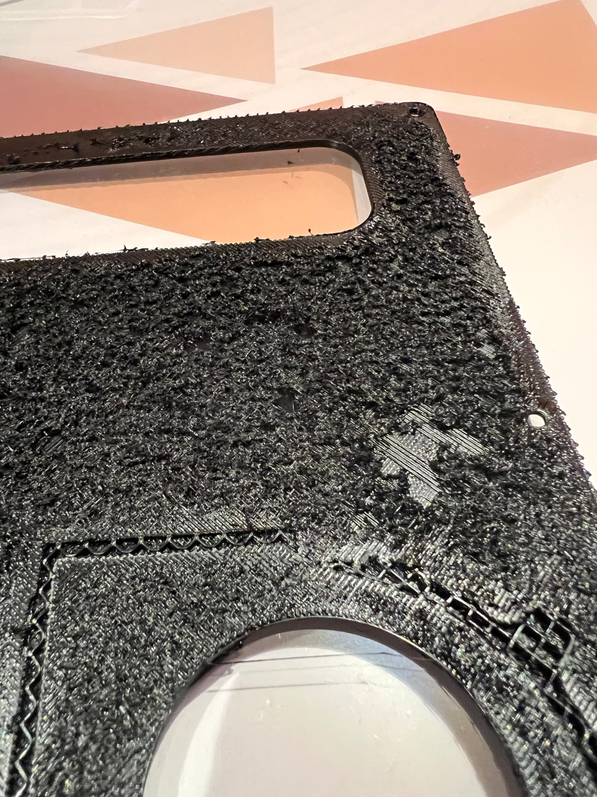

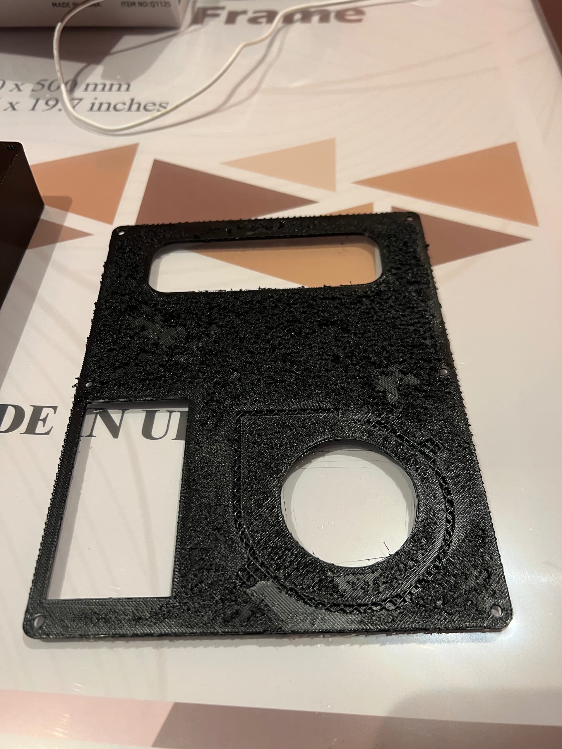

Hi - I’m lost for an answer now, using eSun ASA+ filament - had a few OK prints but a lot of tweaking.

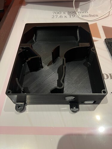

Trying to print a heater box - after trying to get config correct, managed to get a good print of the main case, now trying to print the lid, prints start ok but after some time maybe 40 - 60 mins in, the surface looks like Velcro and there’s little bits of filament ‘grains’ all over.
I tried slowing the prints down, tried speeding them up- using standard creality ASA filament profile as a base- I have tried limiting speed to 30 for first layer and 80 - 100 for remaining.
Chamber temperature around 50C
Filament dried in a Creality dual drier box
I did flow calibration for Orca and the prints were neat - but going on to print case cover it all goes to rubbish.
I have successfully printed PLA, PA6-CF, PETG.
Attached images show good case print and the failed lid.
Please can someone give me the benefit of experience to point me in the right direction because I am wasting loads of my time going round in circles

I print ASA at times. I currently have ASA on the machine (K1C). I use a heated build chamber for ASA, i.e. as it tends to warp easily with this ole, drafty house.
Anyway, the problem is not apparent to me. It could be the actual file and settings.
Have you tried to build the file with presets instead of regular, homegrown settings? Did you use the same presets if you did follow the Creality presets for the enclosure and fitted top?

Check the file. I forgot to mention it. The .stl or .stp file may be made irregularly.

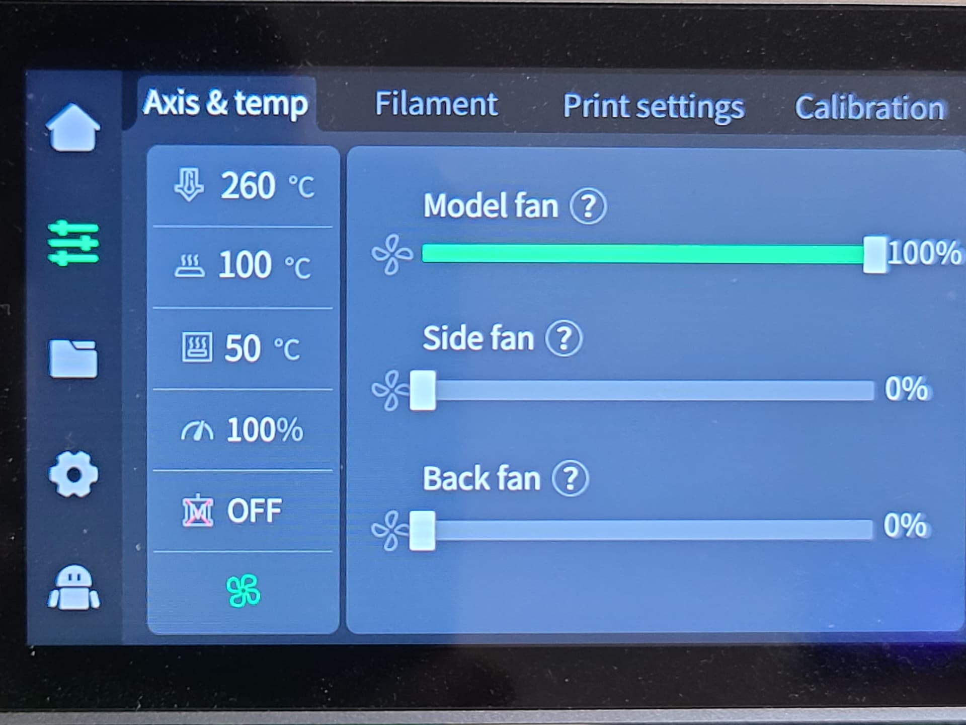

PS. The fan is showing 100% but most of the time it’s at 10%.
Edit:
Another thing I noticed was that the chamber temp which needs to be 50°C doesn’t get up to temp until after the print is started. I tried to preheat the chamber first before the print started but the K2 Pro wouldn’t let me. It shows the setting as 28 :arrow_right: 50
Is there a way to preheat the chamber on the K2 Pro before the print starts..?
