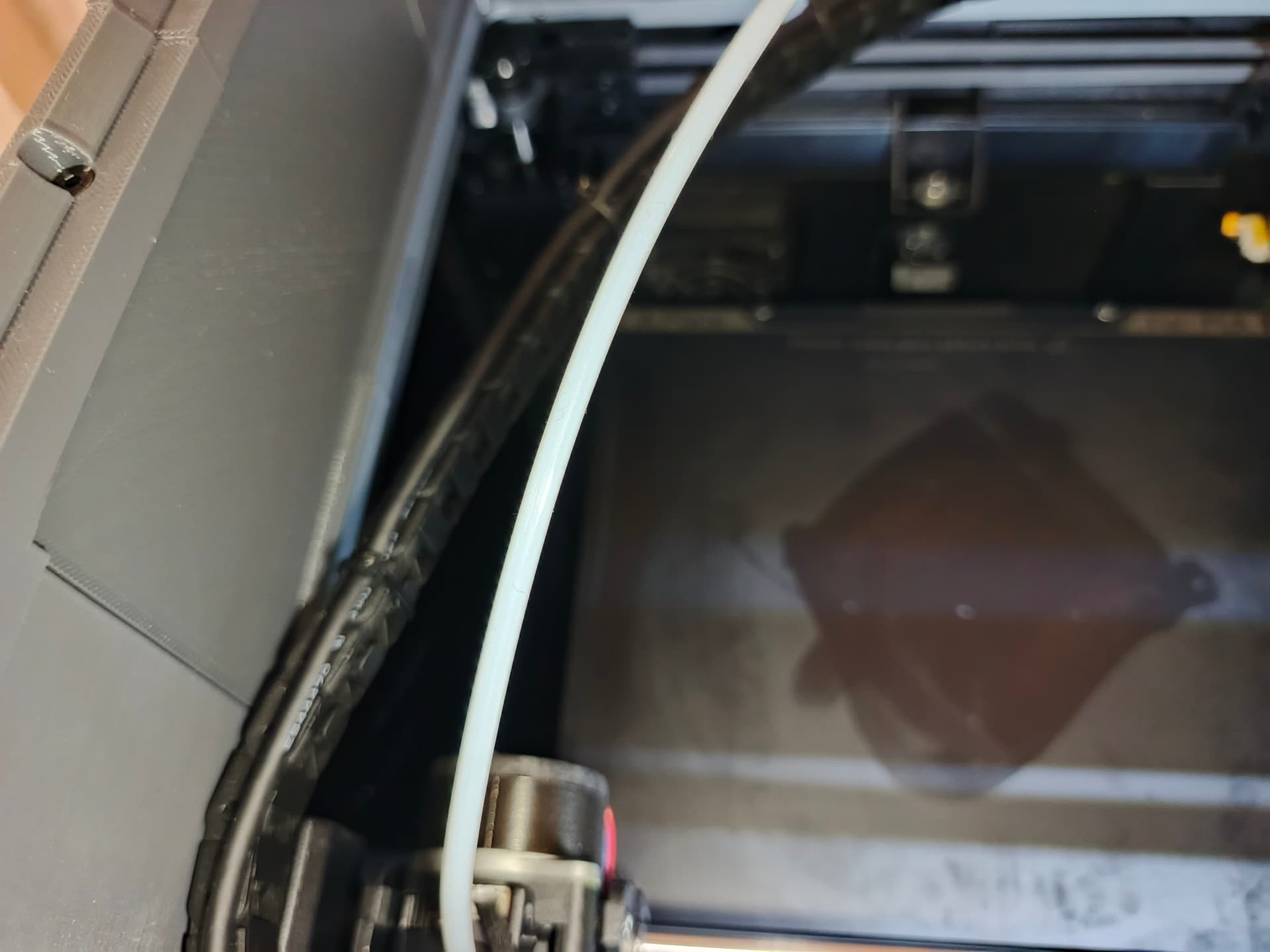

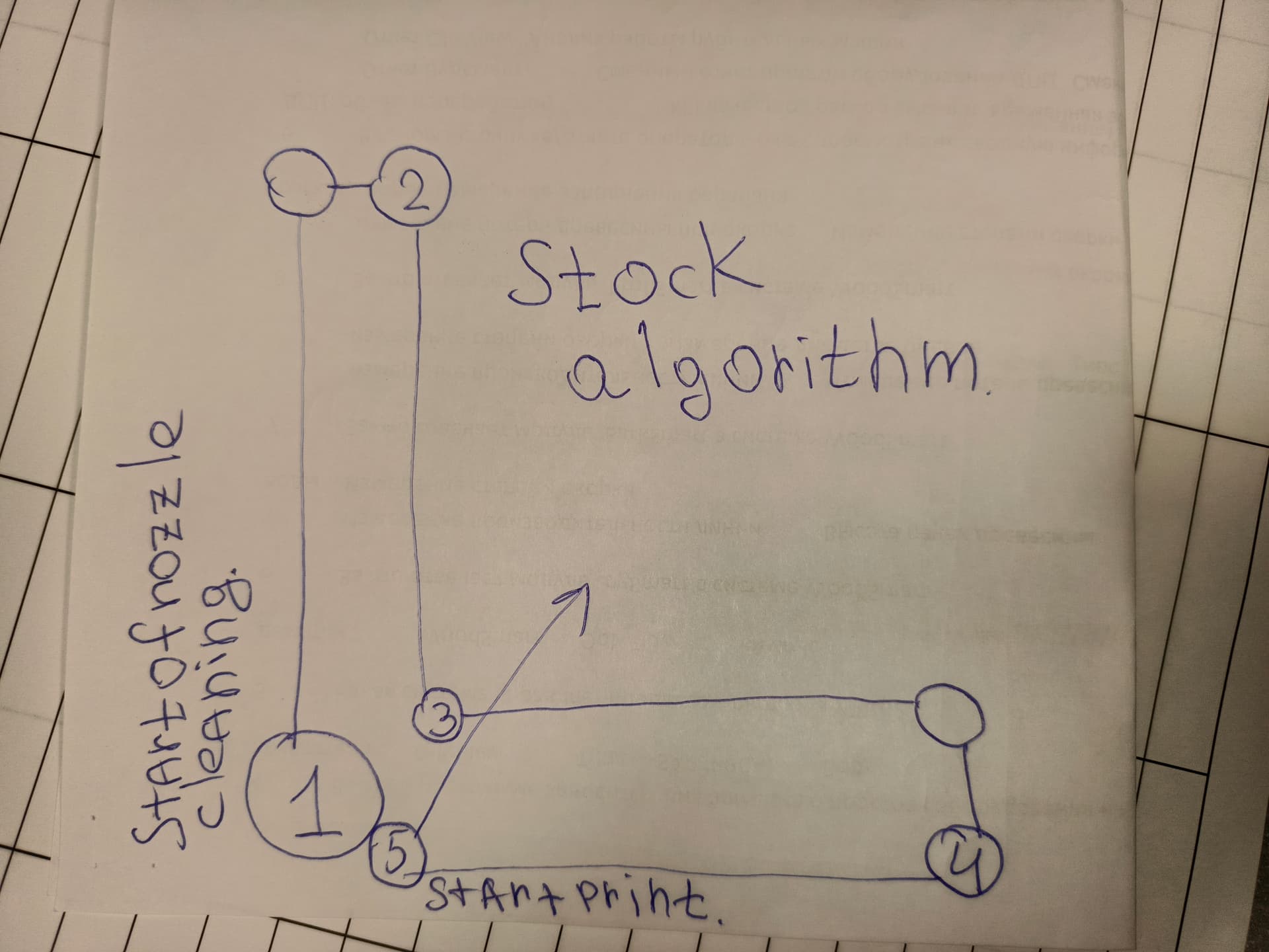

‎Hello, when you start printing the K1C-CFS-C printer, there are problems with the filament rod getting into the extruder. This is due to the location of the printing head at the maximum distance, the PTFE tube is stretched very much and the small bend angle does not allow the drive to push the plastic into the extruder. I want to ask a question; Is it possible to change the printhead nozzle cleaning algorithm? If the start of cleaning starts from the upper left corner, the PTFE tube bending will be minimal and this will facilitate the entry of filament into the extruder, this will save printing time, reduce wear of the drive mechanisms of the multimaterial system. I tried to draw the principle of constructing the algorithm. Thanks.cation of the printing head at the maximum distance, the PTFE tube is stretched very much and the small bend angle does not allow the drive to push the plastic into the extruder. I want to ask a question; Is it possible to change the printhead nozzle cleaning algorithm? If the start of cleaning starts from the upper left corner, the PTFE tube bending will be minimal and this will facilitate the entry of filament into the extruder, this will save printing time, reduce wear of the drive mechanisms of the multimaterial system. I tried to draw the principle of constructing the algorithm. Thanks.
