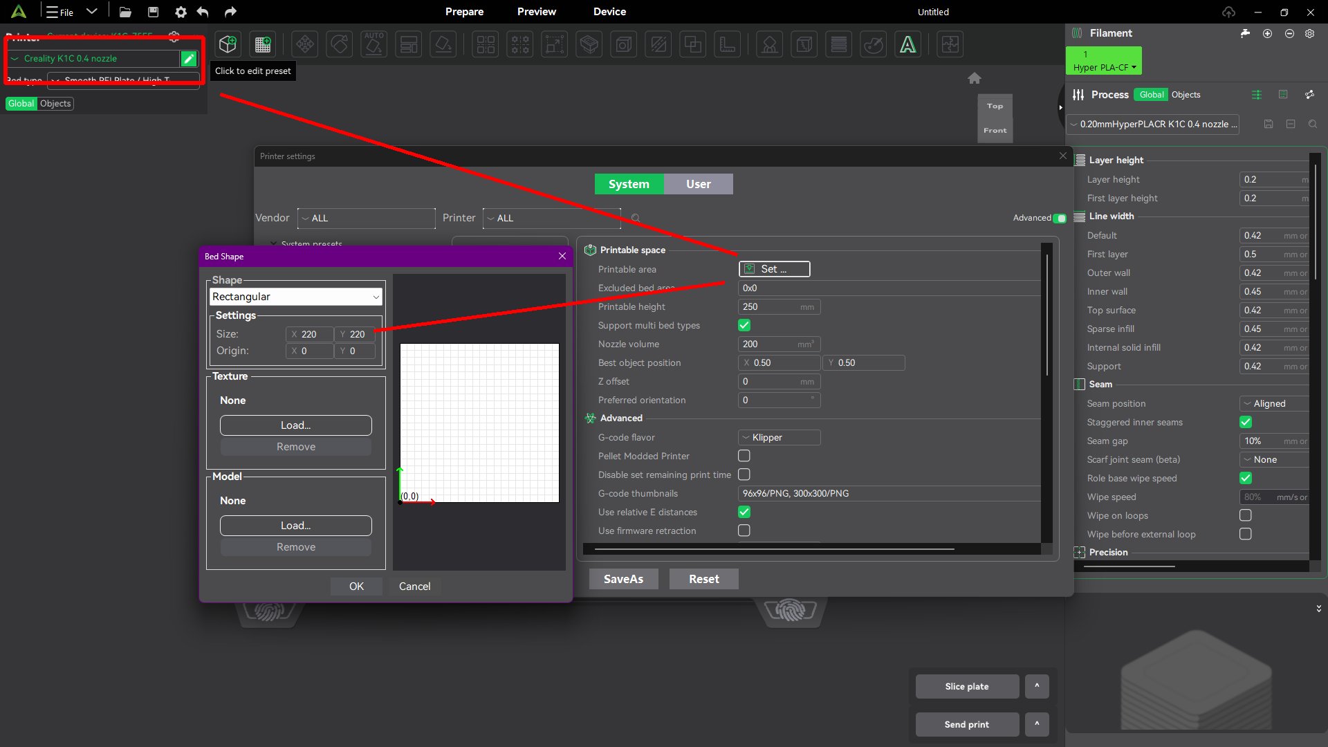

I’ve put a square of 220mm by 220mm on the plate inside creality print, then it wont cut because oversized… i’ve reduce my model who was perfectly (tested in multiple software) by 1mm to test it, miracle it worked…
I would like to know if there is a way to change this setting in creality print to keep the model to 220mm and no 219mm ?

Are You sure That square is not limited collar or contour? Maybe You not off counter. I’m solved with this too
To print build plate is actually 235 x 235, I have changed the plate size to 230 x 230 for a large print and it worked ok.

@JeffScylla What do you mean by collar I dont see any option like this ?
@Bill.b Hello, how do you setup to 230 ? where is the files to modify ? thx.
Bill
Skirt loops and Brim type
Setup build plate leave it as is if you don’t know anything about config printer.cfg etc. You can break printer. First learn what is it. Beacause one thing is size plate, and second is movement options toolhead.

@Bill.b thanks that worked for printing this 1mm lol.

Finally solved was a probleme with my version of print 6 , swaped from french to english and all was solved…
