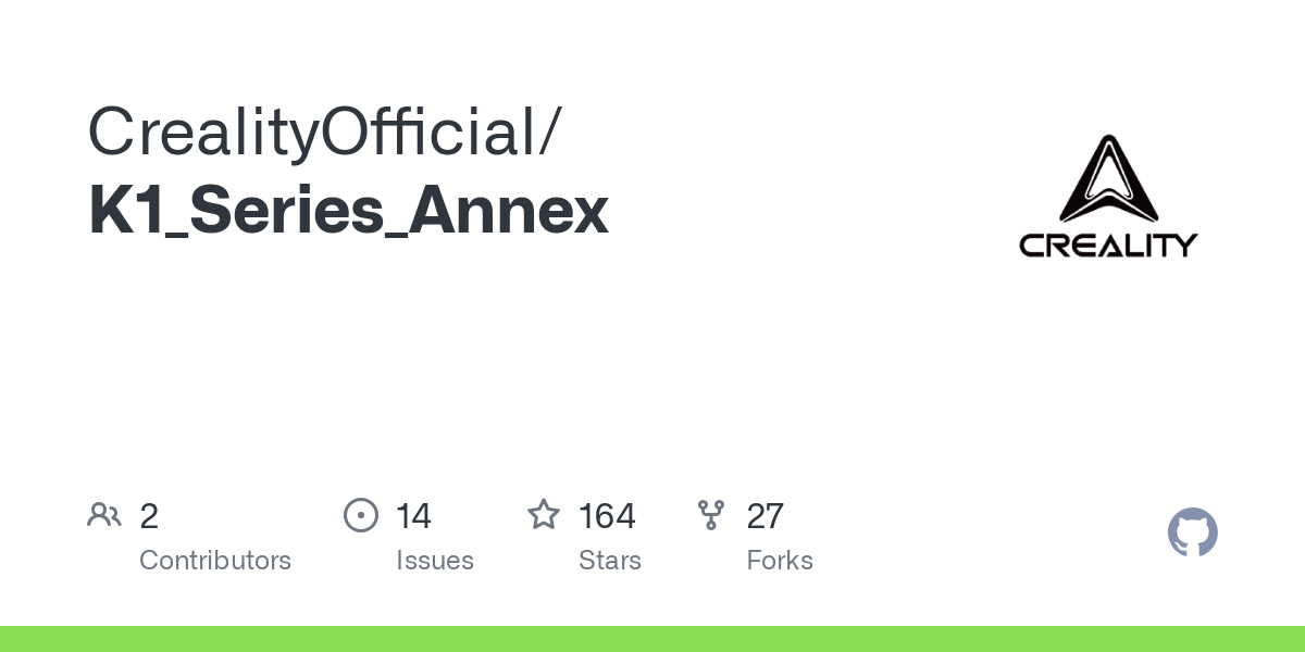

Where did you find the firmware recovery tool? Sounds like an interesting utility to have handy, just in case. :slight_smile:
Directly in Creality github space
There is also a nice description in it.
Thanks, got it. :slight_smile:
