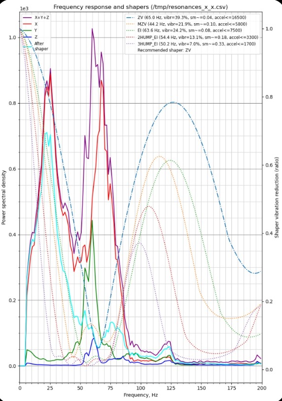

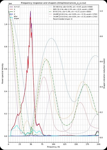

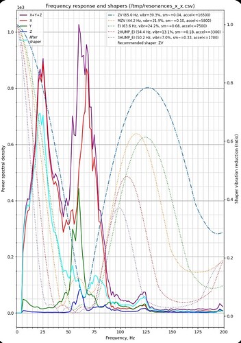

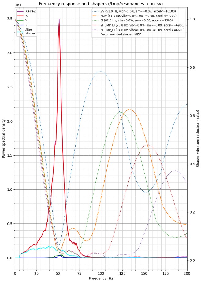

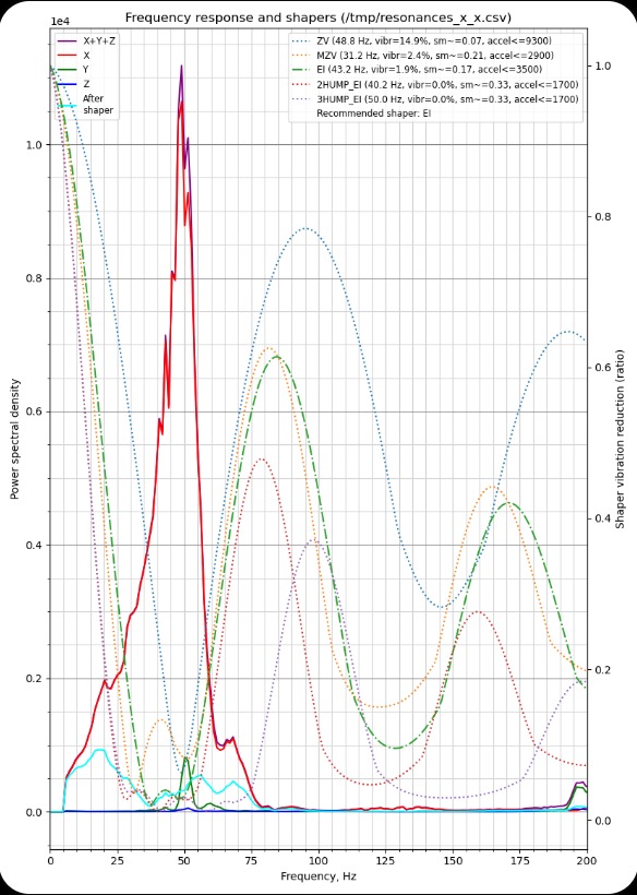

Hello! Here is my experience with lubrication: Y axis: lubricate it with the grease Creality provides; X axis: do not lubricate; however, my machine came rom factory (2024) with this axis greased. Recently I cleaned it with isopropil alcohol, then I used a very little drop of PTFE Super Lube on the rods. The ressonances graphic got better with a cleaner ressonance peak. Then I changed the original springs on the toolhead that locks in the upper sleeve by softer springs, by cutting in half some of these cheap pen springs. Then the X axis ressonance was really clean of vibrations. Sharing the graphics so you can check it for yourselfs. Of course, my printer already has the 20t pulley from factory.
