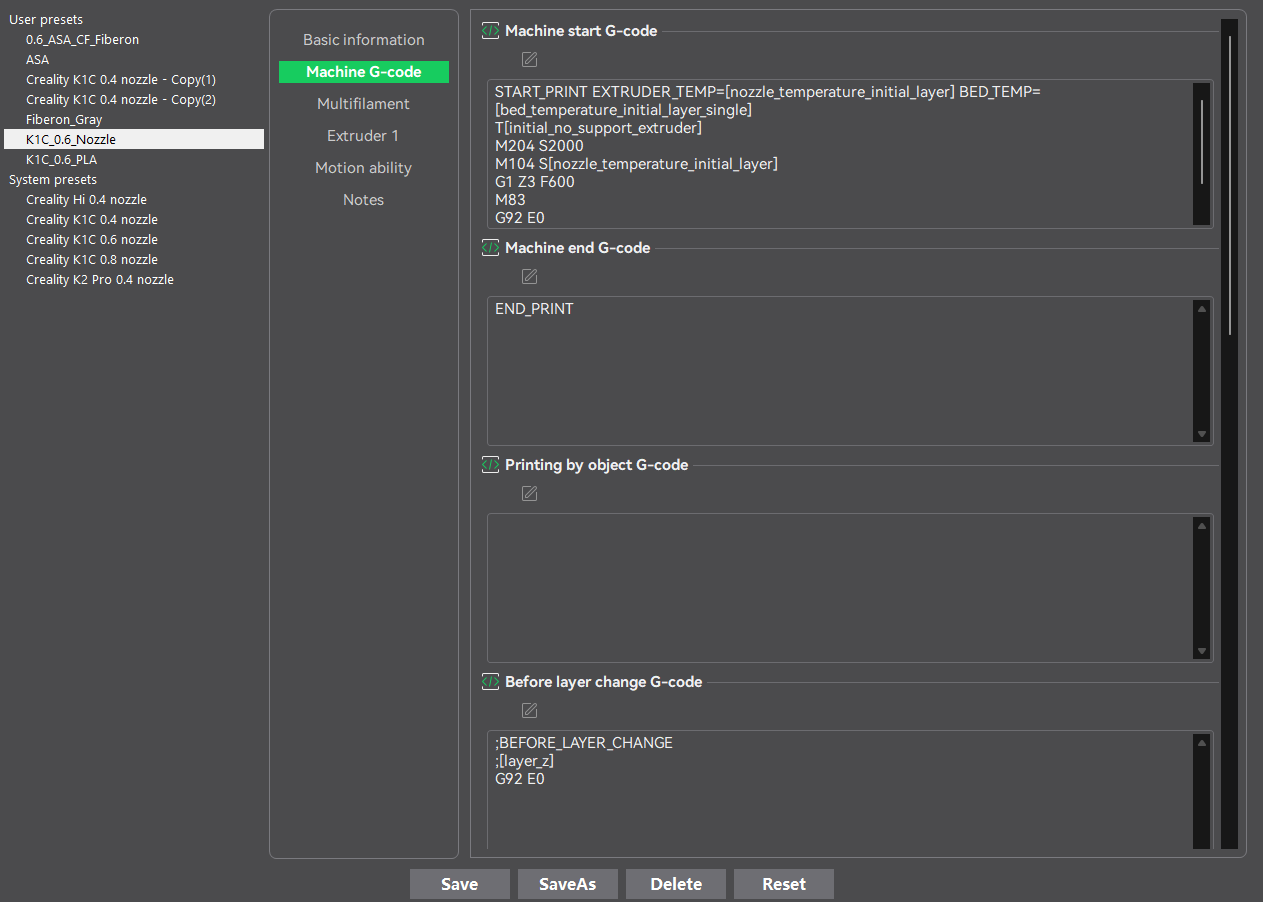

I’m trying to use my own custom START_PRINT macro on my Creality K1C instead of the stock routine created by Creality.
Here is the issue: I created my own script in gcode_macro.cfg and specified it in Orca Slicer. Everything works perfectly as long as I start the print via the Fluidd web interface.
However, if I start a print directly from the printer’s touchscreen, it completely ignores my script. It also ignores the macro in /Helper-Script/KAMP/Start_Print.cfg and just executes some built-in internal routine.
Does anyone know what and where needs to be modified so that starting a print from the touchscreen uses the START_PRINT macro defined in the .cfg files, rather than the hardcoded routine hidden inside the firmware?

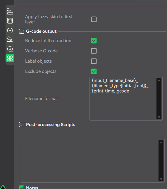

Now, do not take my word for it but I have seen some macro sections in the Creality Slicer (not Orca).
Let me get some screenshots.
That may help you in case you wanted to test some g-code out on the Creality Print. I know what you are asking and I know nothing about Orca for now. I am sorry.

Just a quick side note: Creality Print (v5.0 and newer) is actually a direct fork of OrcaSlicer. So all those settings are virtually identical in Orca. In fact, that exact window from your screenshot is where I replaced the stock call with my own custom macro name.
The main issue isn’t the slicer itself — it works perfectly when I start the print via the Fluidd web interface.
The issue is strictly with the printer’s touchscreen. When you start a print directly from the screen, Creality’s internal software completely overrides/ignores whatever custom macro is set in the G-code and forces its own hardcoded pre-print routine instead.
And yes, it’s super frustrating! That’s why I’m trying to find a way to bypass or override that hardcoded routine on firmware 1.3.5.22.
Oh. I was unaware of the custom macro overrides on USB or via WiFi and touchscreen applications. I am sorry to bother you…
