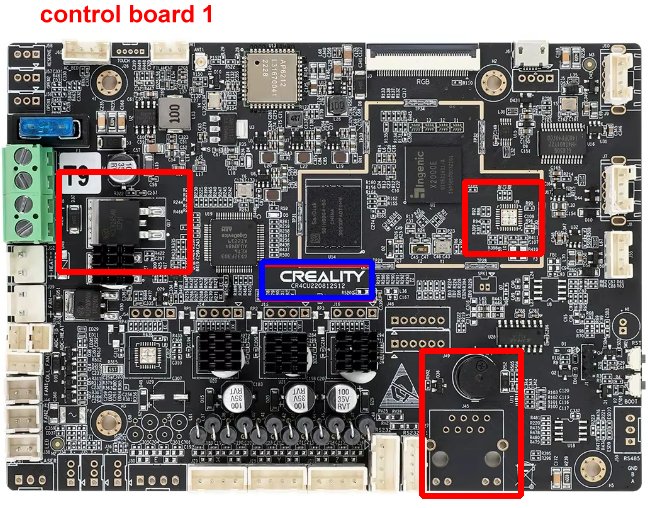

Be careful if you decide to replace the main board, There are two different boards one for the K1 and a different one for the K1c. Check the board installed in your printer before ordering a new one.
This is the board installed in my pre 2025 K1c.
