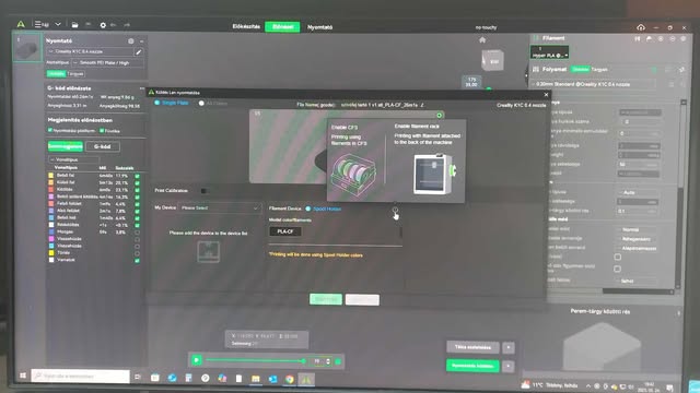

K1C pop-up window, hasn't printed from computer since
Hello!
I would like to ask for help. One day I was printing perfectly from a desktop computer, the next day it threw up this window. I browsed the settings all the way, but I can’t select anywhere to use my own filament. Did the application update, or what happened?
Thanks in advance for your help, Zoli.
It prints perfectly from a pendrive, but the window shown in the picture doesn’t print. Does anyone have any ideas for settings? Thank you, Zoli.
did you get the latest creality print 6.0 installed recently? looks like it’s referring to the newly released CFS upgrade. If you did install the latest, suggest downgrading to a version a week or so before this
