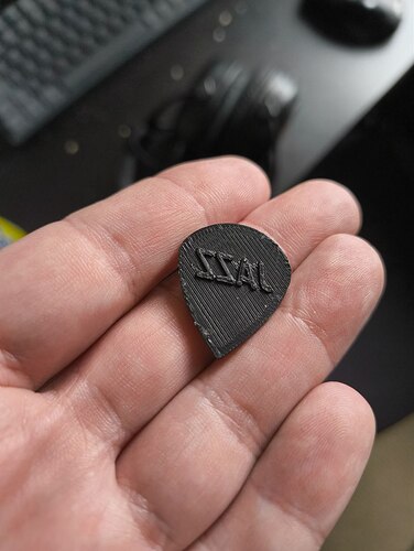

This was actually my very first thought and although it took a while to convince customer service of this, it did turn out that they’d assembled the machine wrong. The X and Y wires were plugged incorrectly into the mainboard.

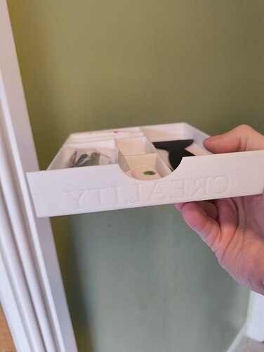

Another User with same issue. Purchased Jan 31, 2025 from Creality store on amazon.
New from box, I didn’t notice the issue, as the first few prints had no text, or features where a reflection was noticeable. I printed an asymmetrical model that had a text label on top- which was obviously wrong.

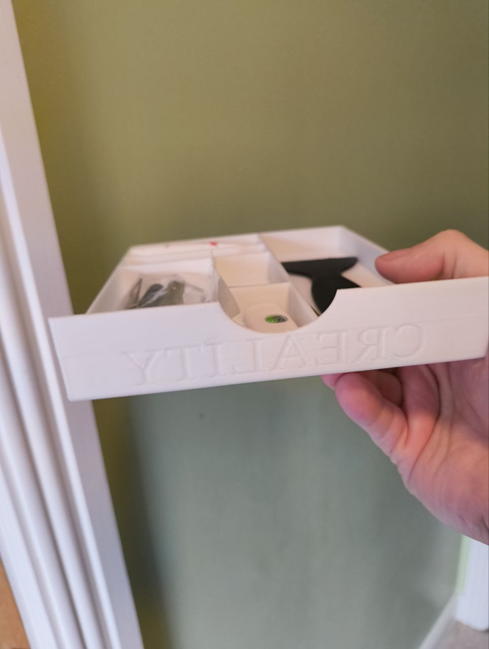

Same issue here. Got my printer on Friday and did a few prints on my K1 SE. Anything with text is coming out backwards. It also seemed to have printed a phone case backwards
