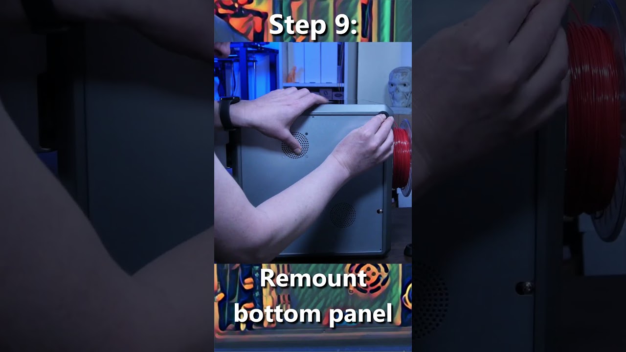

I also got the samen issue and found an video on YouTube where they adjust the different z-axis but i didn’t dare to try it
