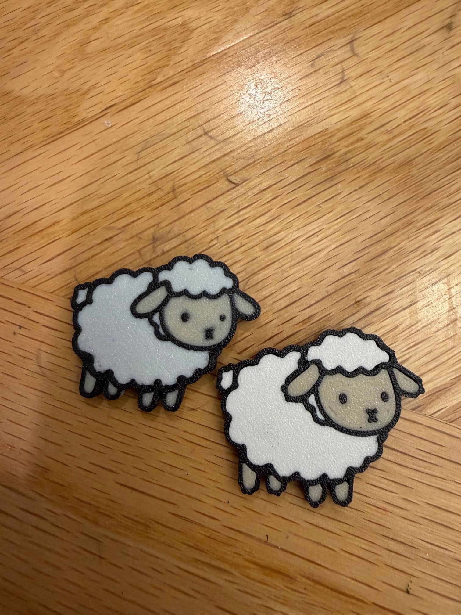

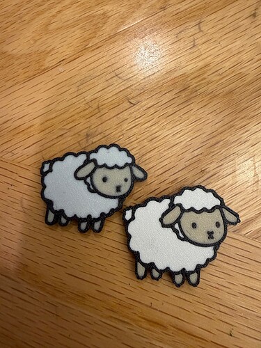

I have a K1c (with CFS) as well as a K2 Plus. I have been having problems with smaller prints on the K2 plus and only just realized that my K1c seems to print better: finer lines, less smudges. I am using Elegoo with the same colors of filament for both printers (PLA+ rapid) –and the colors also differ: they appear duller from the K2 Plus prints for both the white and the “flesh” color, and more matte-like for the white on the K1c although I’m using the same PLA+ filament for both. I am printing the first 3 layers on the K2 plus at 30-40 hoping that would give better prints
. How do I refine my K2 plus settings to get it to print as well, and am I imagining that the two printers have different color output?? In the picture, the K2plus print is on the left, and the K1c on the right.
If you want to compare prints, start by printing them in the same size… when printing smaller some detail will fade..
To get the white more white you have to purge more to clean out black…
They were actually the same size–just the camera angle (couldn’t take picture overhead due to a lot of shadow).
As are the models in these pictures: same size, same model.

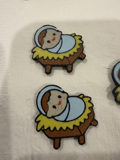

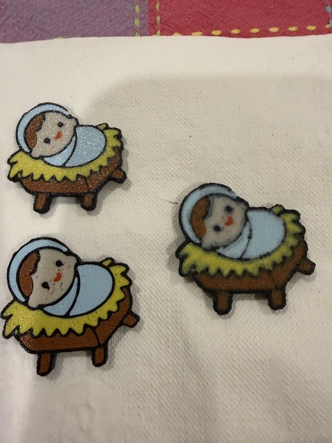

I moved an additional CFS unit to my K1c, and have attached a few pictures. The two on the left (or the two alone) are printed on the K1c: top when I printed only 5 at a time (trial), buttom when I printed 24. For reference, these are roughly the size of a 50 cent piece… The bottom one: didn’t fill in the first layer as well in any of the prints, but wasn’t an issue before.
The one on the right: was printed on my K2 Plus, with settings slowed down to match the K1c (speed, acceleration, jerk, etc) and the print was still terrible. Same filament, same model, sliced separately obviously due to different printer profile. Same filament print order (black was last for each one).

For the k1c print, that appears to be a first layer adhesion issue. Part of the print lifted while printing giving the appearance of under extrusion - at least that is what I see in the pic.
As for the k2+ - first don’t treat it like the k1c. It likely needs to print faster for better results, and you likely need to calibrate the flow rate for the filament your using….
